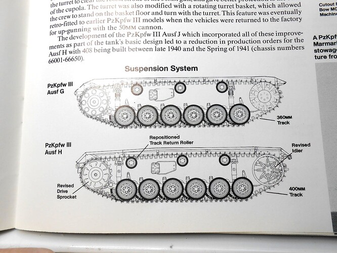

Actually the kit placement according to my refrences ( Panzer 3 in action)
they changed the placement of the return roller from the G model to the H model.
SEE Pic.
More to come

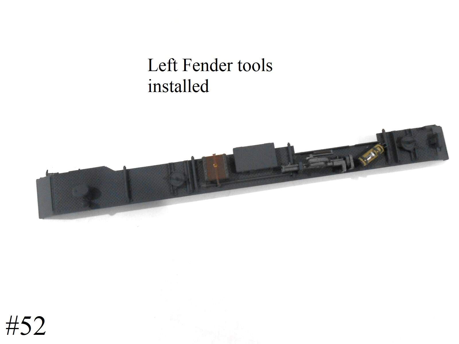

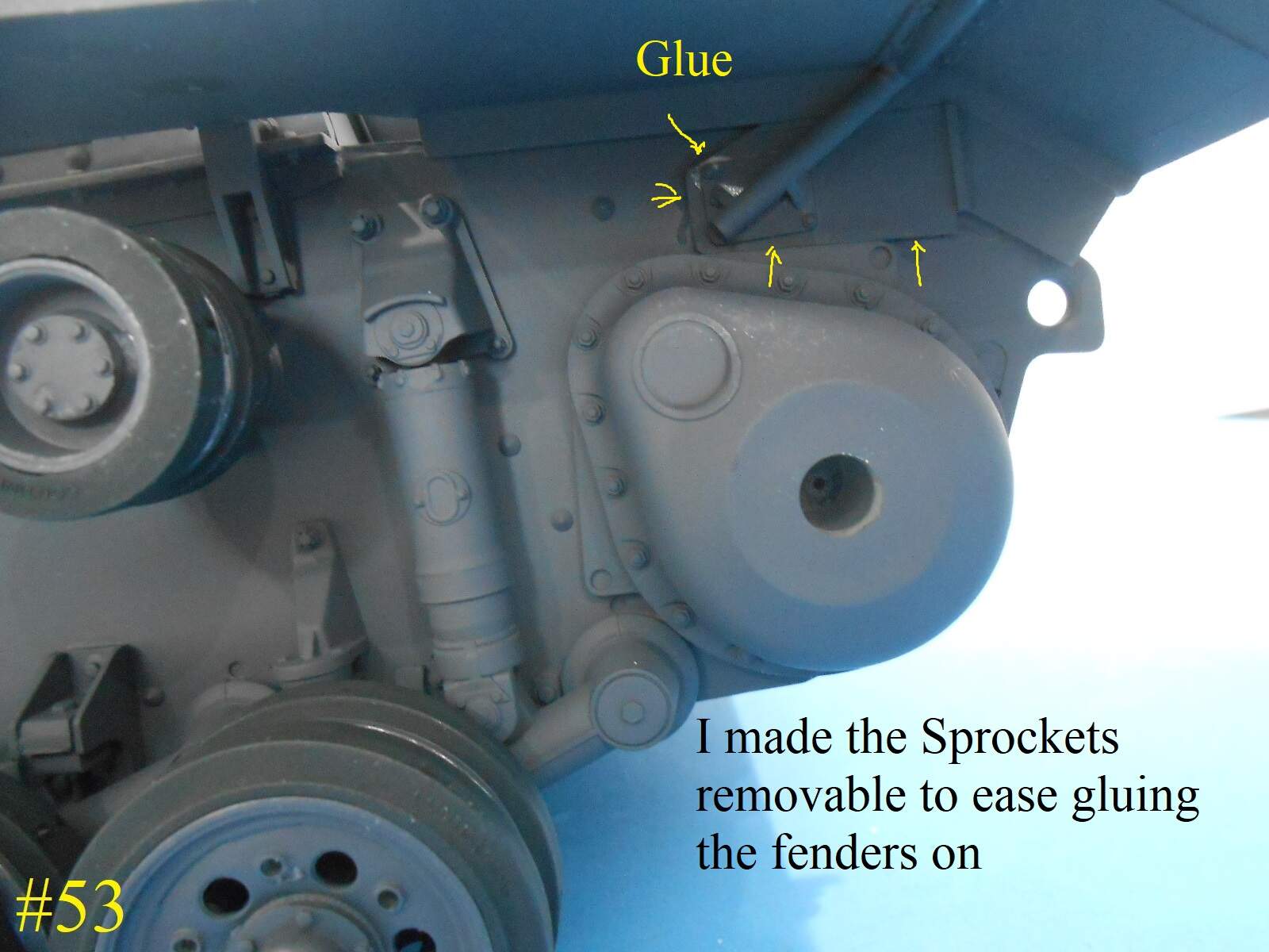

Now for those damed pe. Clamps
First I temporaily placed the Fenders to get the correct placemrnt of the front suports for the fenders. This way everything is where it’s supose to be.
You should shorten the suport pins slightly and enlarge the mounting holes in the fenders.
Next the rest of the Fender luggage
Regards
Donald

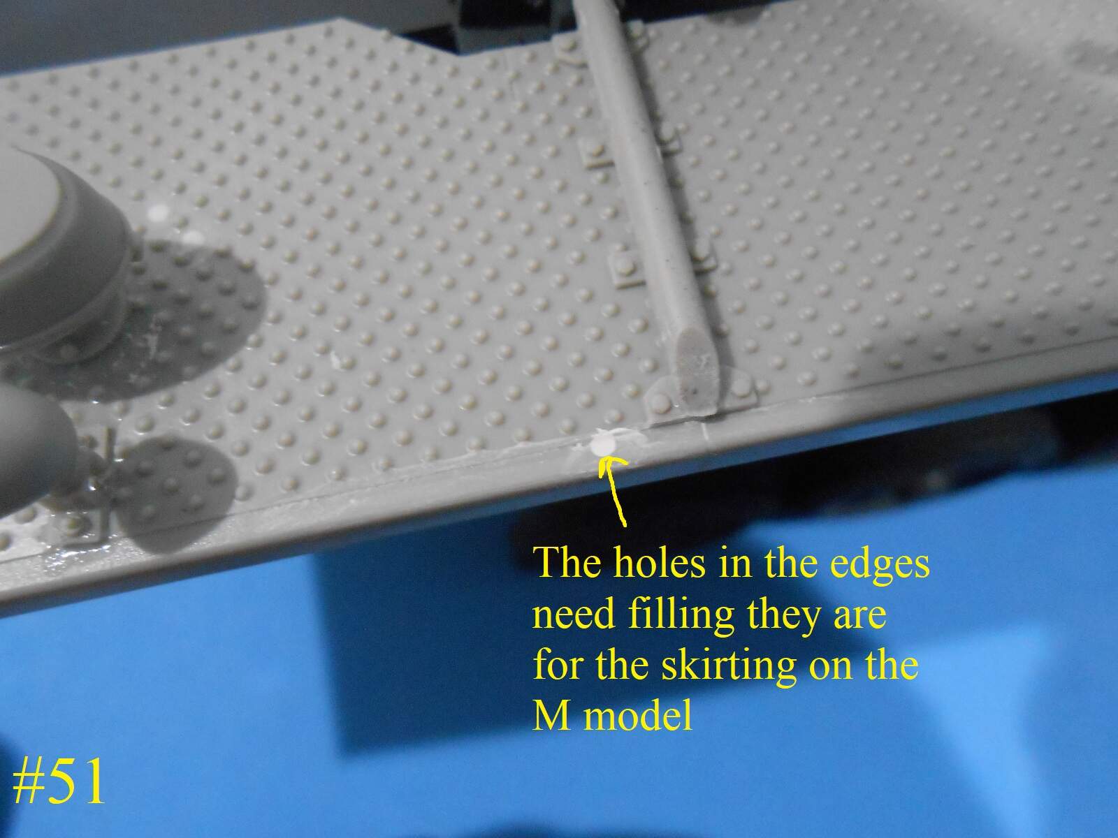

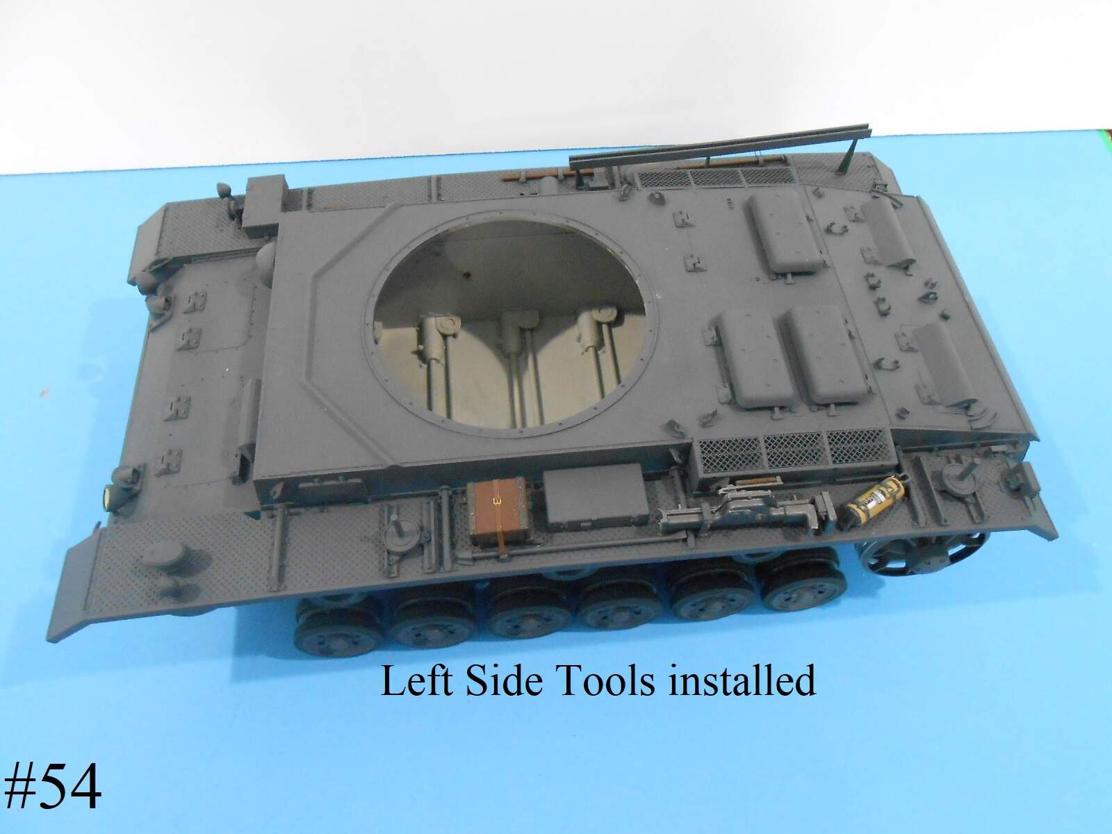

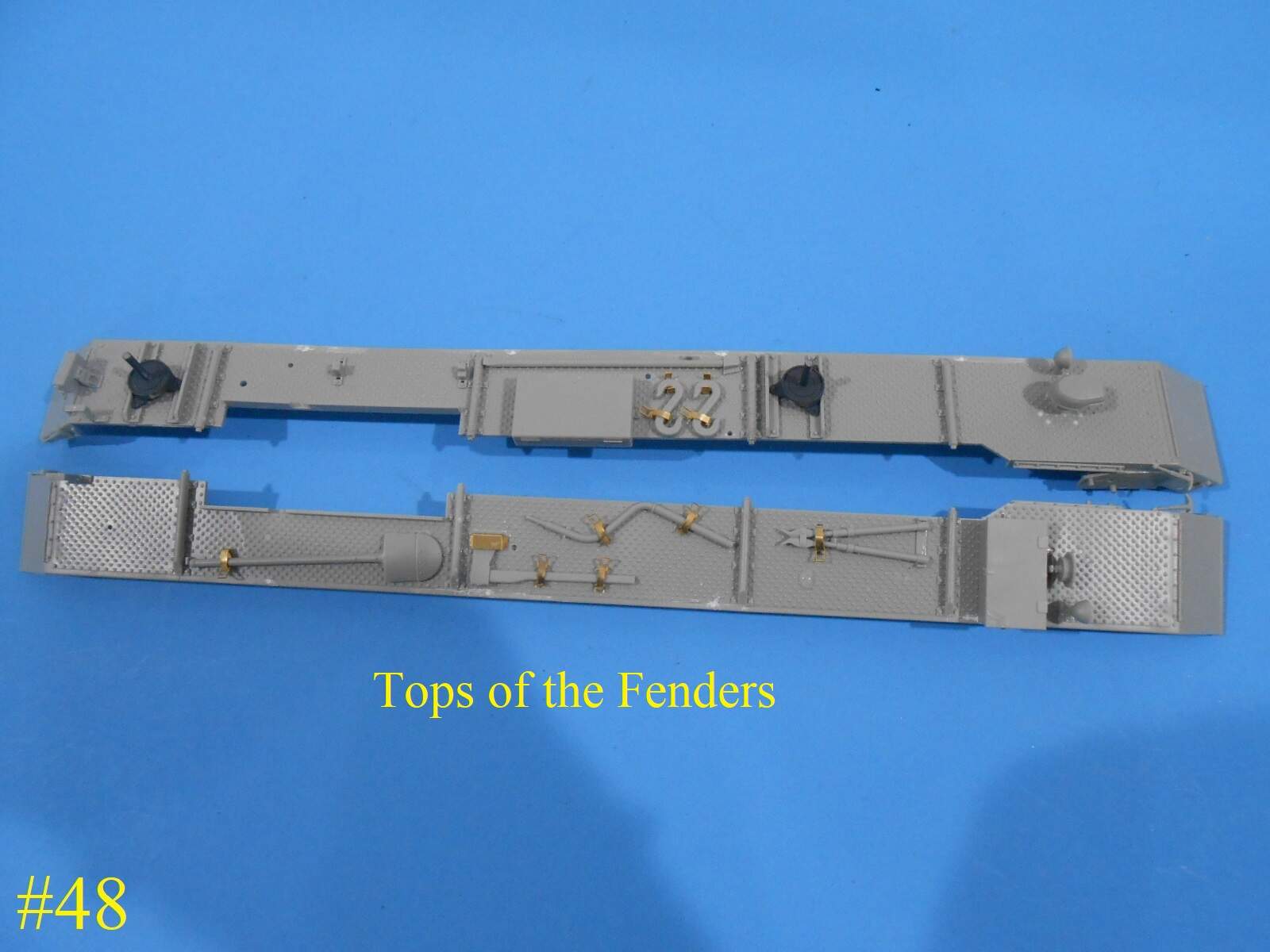

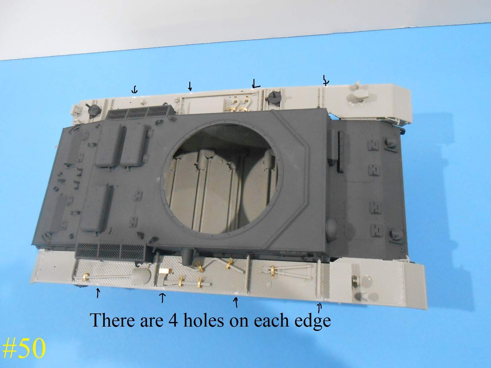

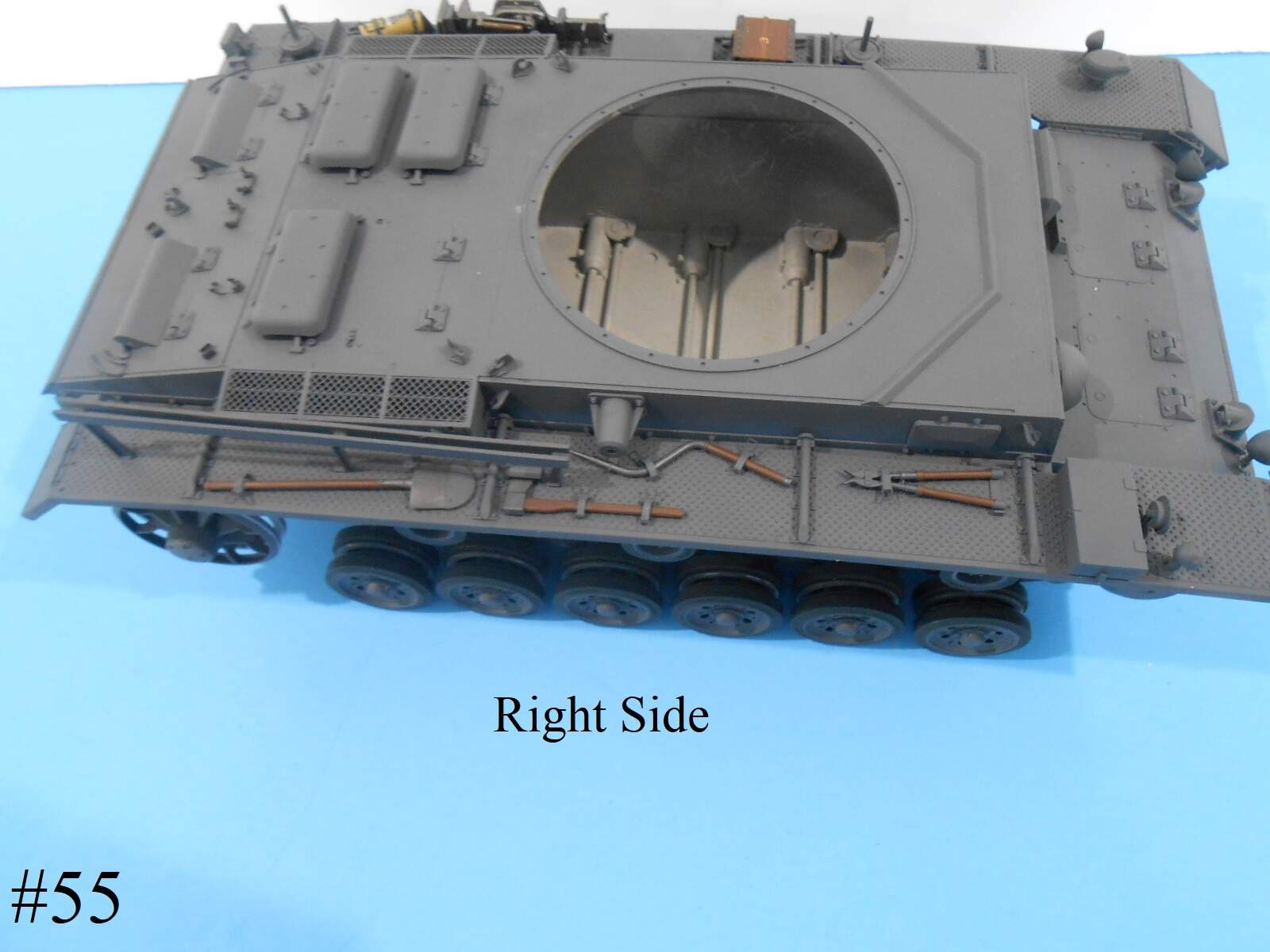

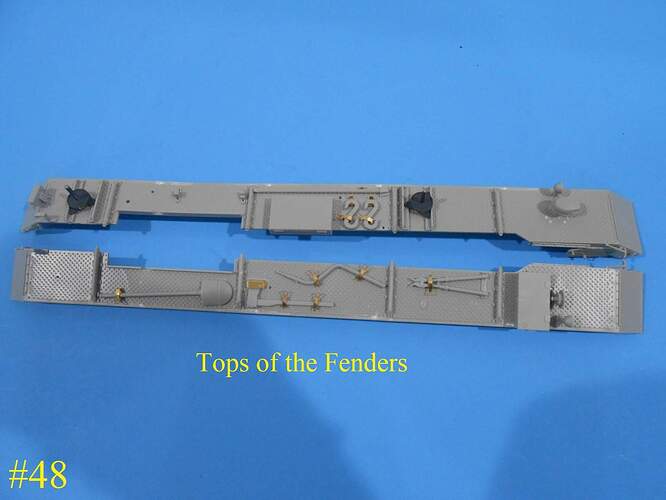

Flying right along here are the fenders with the ity bity parts installed.
(Note ) You should fill the 4 small holes in the edges they are for the M version
Now to paint it all.
Regards
Donald
A little more finished.
I’ll be working on the Track next
Regards
Donald

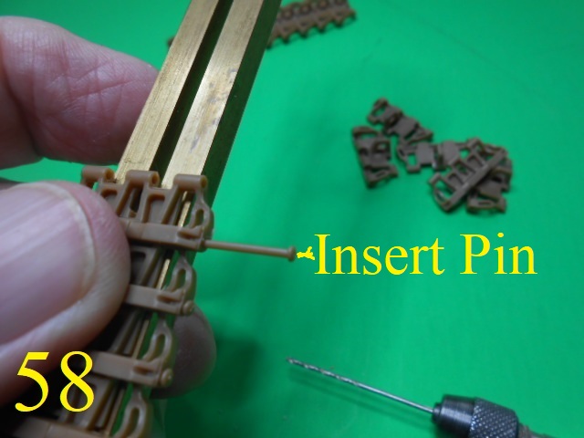

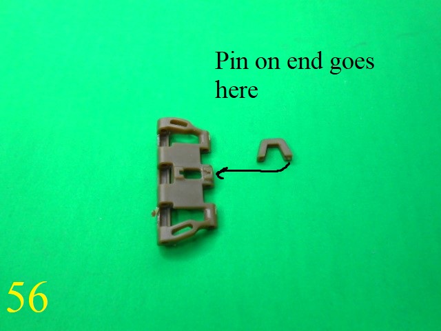

Working on the Track.
Panzer III J #56
The small pin on the Guide goes in the spot on the thin edge , not where the cleat is.
Panzer III J #57

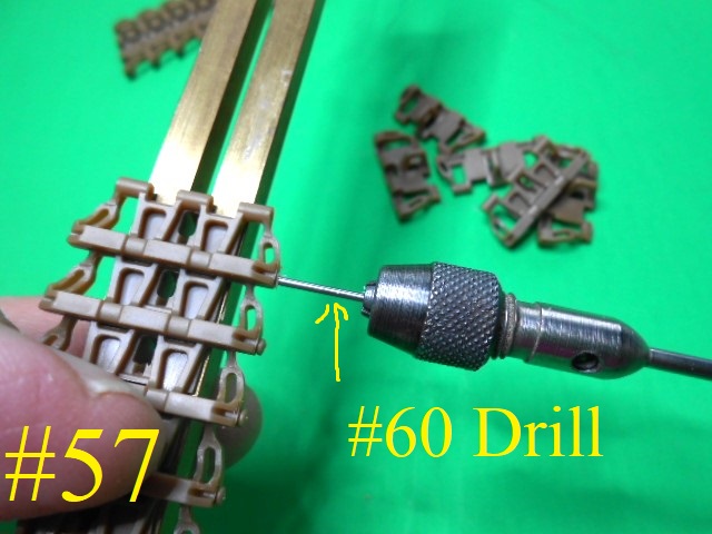

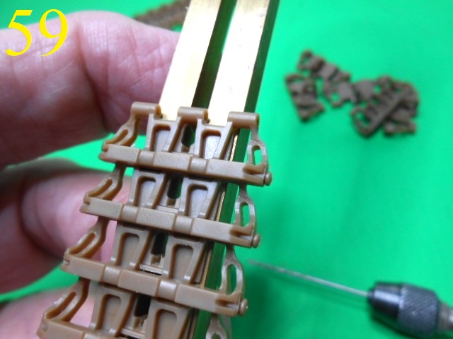

I made various sized jigs to hold the track while assembling it , just a couple of lengths of square tubing soldered together works good.
I just join the track shoes together on the jig , drill the hole , a #60 drill works just right size.
Panzer III J #58
Slide in the pin
Panzer III J #59

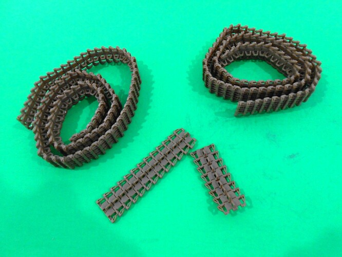

I work in sections of 10 links , then join them together for the total Track Run
91 links each side.
Continuing on.
Donald

I have them assembled and painted .
I’ll weather and install them later.
Donald

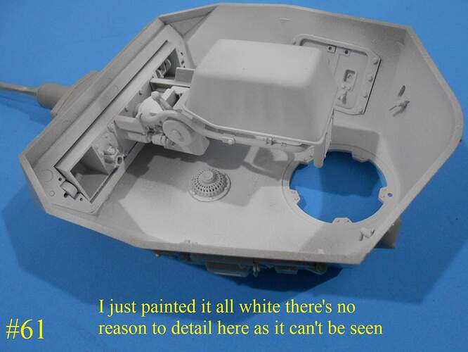

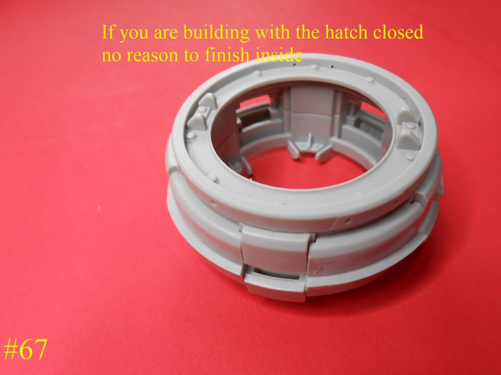

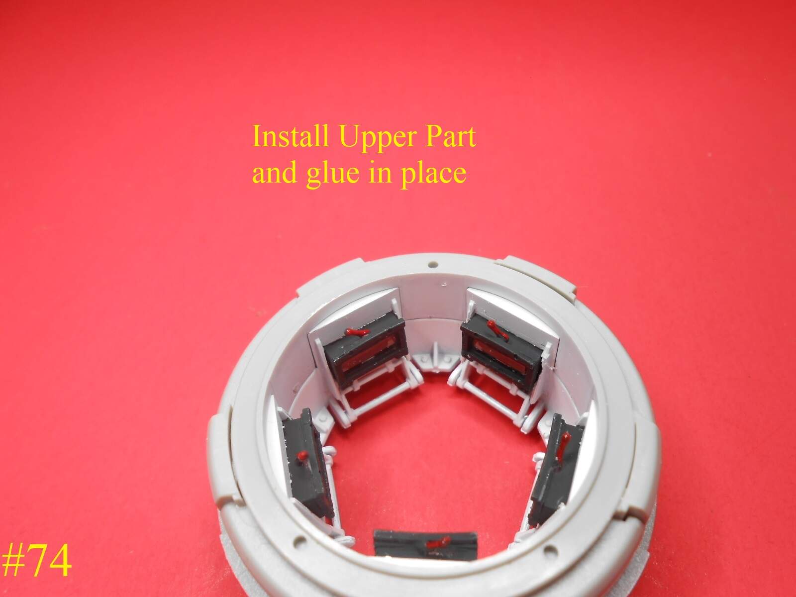

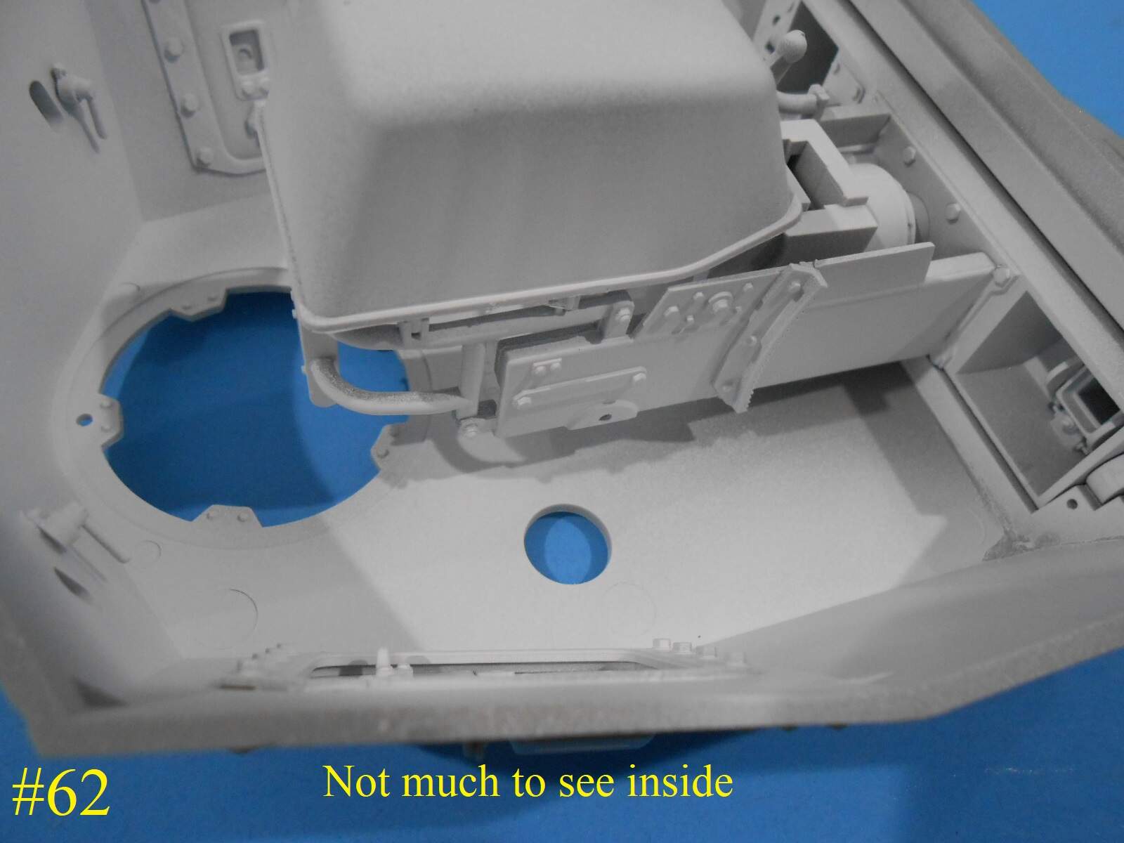

I assembled the Gun and installed it in the Turret I didn’t do any detailing on it as it can’t be seen.
I just glued the hatches closed since there’s on interior detail.
Regards
Donald

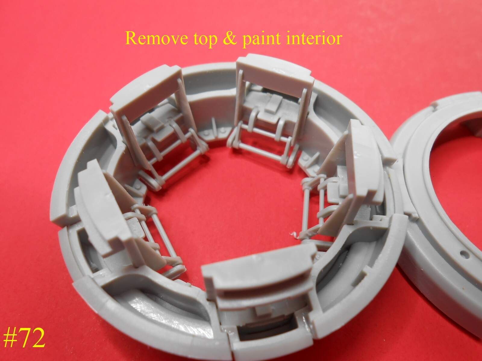

I’ve ben busy busy , Here’s some more.
Any questions just ask.
Now to paint it all
Regards
Donald

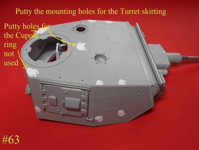

I have somemore finished today.

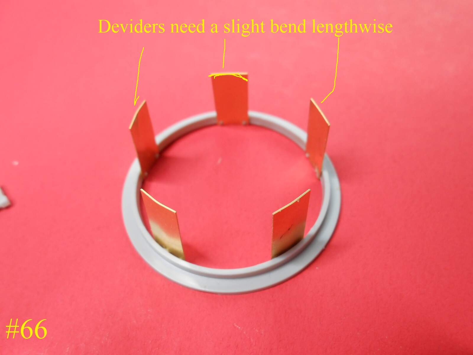

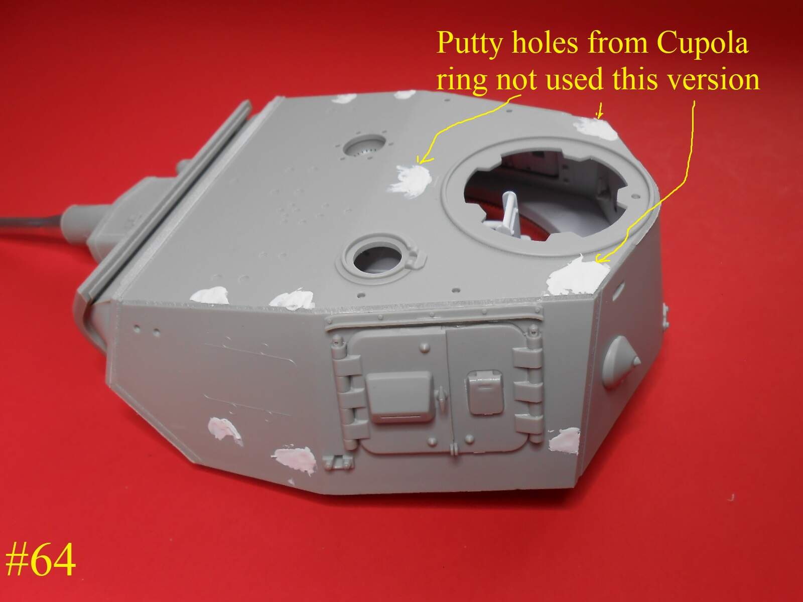

Working on the exterior of the Turret
Regards
Donald
