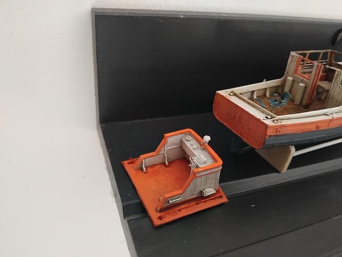

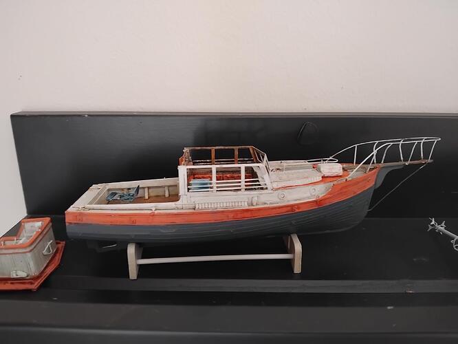

My apologies for the long pause. Reorganization of home spaces, plus an unexpected promotion wreacked havoc with my already limited hobby time. I did start on the painting, though. It is still in its infancy, but the paint IS getting onto the model. The faded red is going to need some more work - I actually use a paint called “faded red” by Vallejo, and will enhance it with different shades. (Already applied on top of a red layer).
Details need to be painted, paint needs to be corrected, washes added, some weathering is needed - the issue is that watching the movie the boat looks pretty beaten up and badly weathered. I can now decide whether I want to paint it “nice” or to make it look like how it looks like in the movie, which means it may look like if it was painted badly.
Beh.

Further update (no photos yet- gotta get them from the phone first). I touched up the paint in several areas, and did a wash on the ship. I think I will need to do some further touch-ups, and start on the details.
