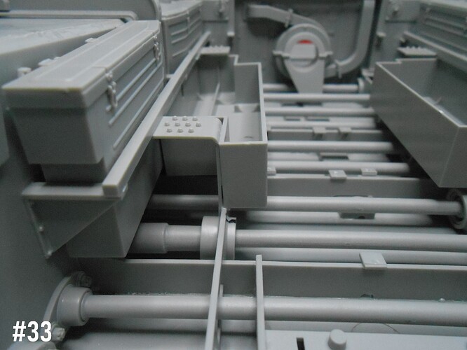

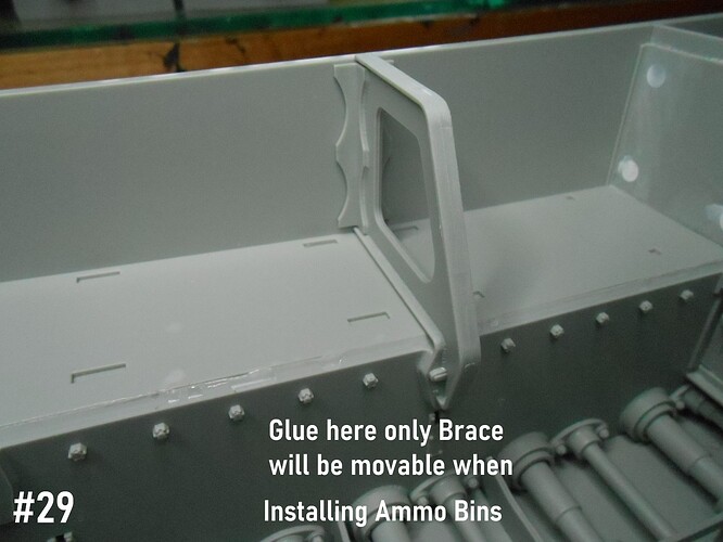

A little more of the interior bottom and framing.
I fitted the framing then glued it all in place.
The Shocks need a little sanding if you want to position them.

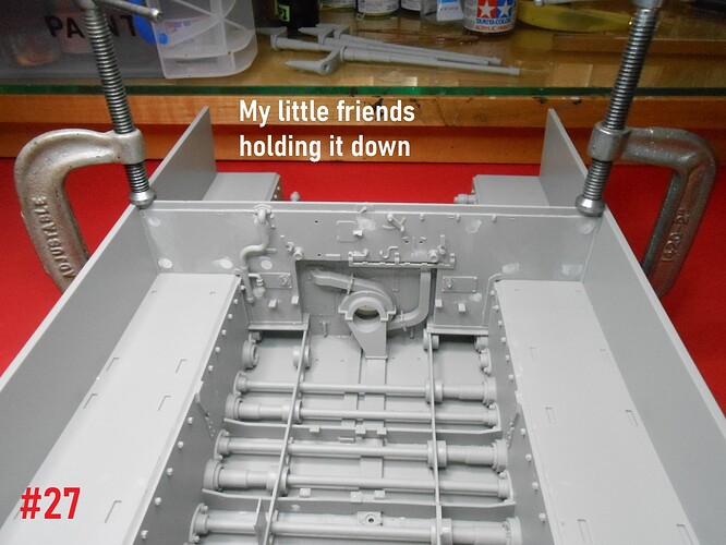

Today I install the Firewall , it sounds simple but it isn’t.
The right rear Shock unit gets in the way. I should have just left it off for it can’t be seen and just gets in the way.
This is why I left the Torsion bars loose and to ease it when it comes painting time.
Regards
Donald

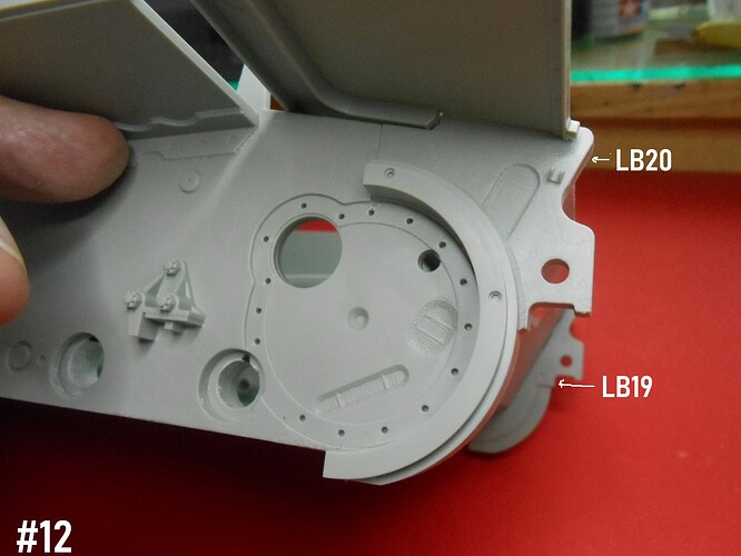

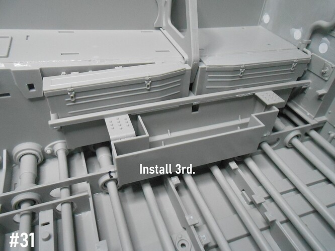

I’m working on the interior of the lower part of the Hull.
Any of you that plan on building this kit should pay special attention to my next post later today.
Regards
Donald
If you don’t install these parts in the order shown, Well Have Fun.

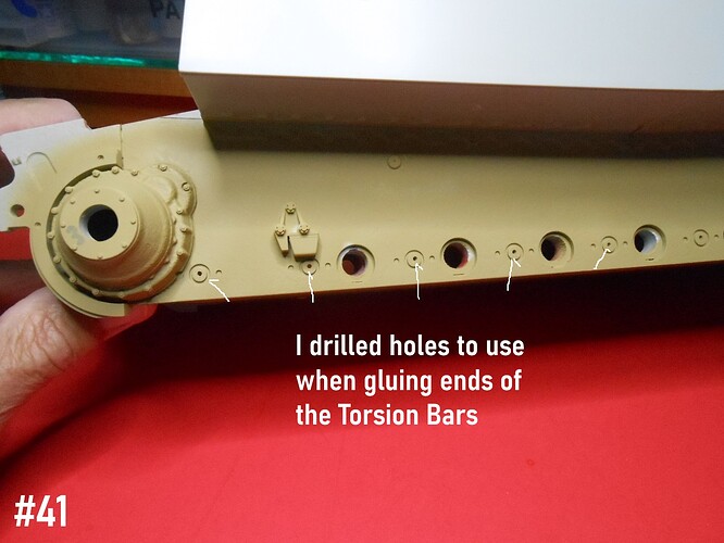

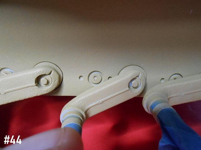

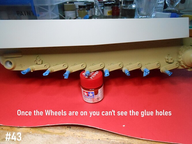

I have the Torsion Bars and Bottom inside painted and installed.
I figured a different way to glue the ends of the Torsion Bars in Place.
It would be very hard to do with all the lower parts in place, so I drilled small holes as shown in Pic. #41 and applied liquid glue through the holes. They will be behind the arms and wheels and won’t be seen.

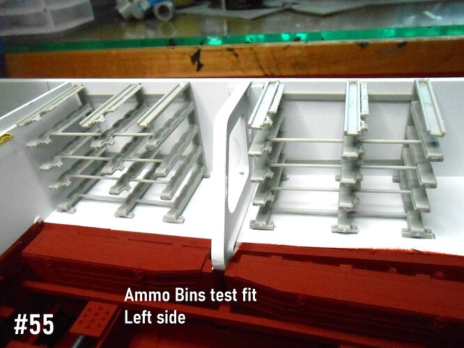

A little more finished but not painted yet.
Finished for today.

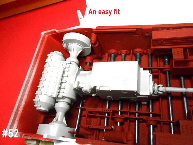

David Byrden has a list of things that need addressing on this kit, its growing as he finds more There seems to be a bit of early late confusion on the internals but as a kit its very impressive generally
Ask David he’s the Tiger expert, for Shure he is reading this. I don’t think all the interior is really worth it, but I wanted a late Tiger. How accurate is it ? I don’t know. I’m not disappointed with it yet just the instructions from Trumpeter suck as usual , I would have preferred one from Andy.
