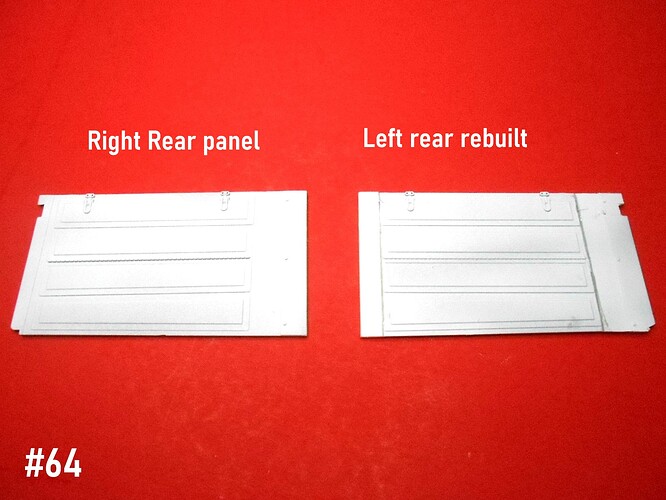

Thank you very much for the photo… and aaaagh, that’s what I was afraid of.
They have “mirrored” the right-hand cover over to the left. But, the right-hand cover was designed for shells facing to the rear.
You can see the real cover in videos from the Saumur restoration team. In essence, the folding doors should be at the rear of the panel (on our left) and a blank space should be at the front… plus, the fire extinguisher goes there.

Hey David I think I solved the problem,
I hope the Fire Extinguisher will work?
It’s all that I can find.

That’s an excellent fix.

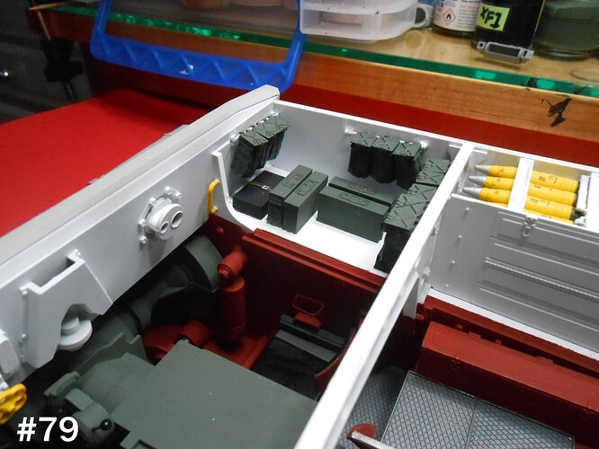

I finally have the Ammo finished. I didn’t do all of it , just what could be seen through the Clear Hull top. Here is how I installed it, you could assemble it like in the instructions but for me this way was a lot easier.
I’m not exactly how far from the edge the Covers should be.
What do you think David ?

Ref the ammo covers, looking at the detail photos of the rl shots above it looks like they are back against the ammo racks or close enough to being so.
Keith
That’s what I thought, they fit the best that way.
This photo from the Saumur Tiger shows you how far from the edge is appropriate…a little bit of the hole in the support bulkhead would be visible, when the door is closed properly.
David
Thank you, this helps a lot
