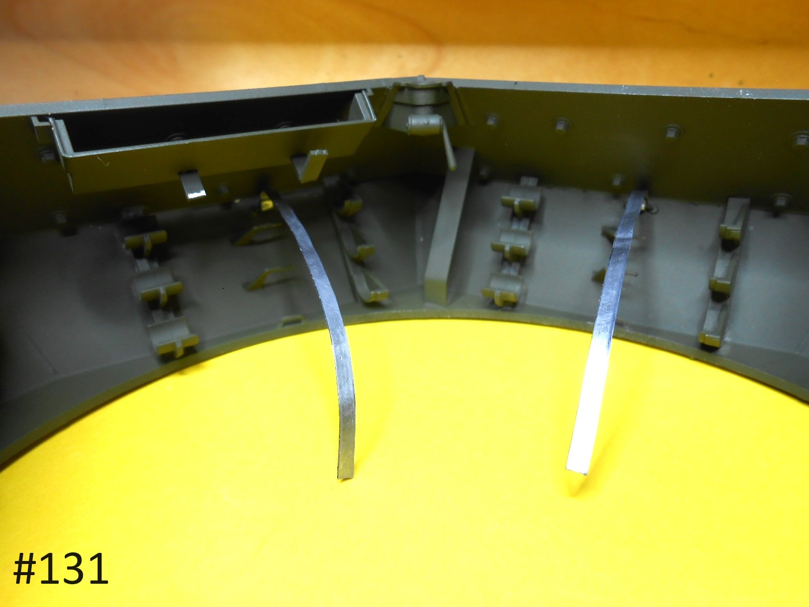

The Ready Round hold down strap goes from the upper eye , over the top round then under the hook , over the middle round then under the lower hook finally over the lower round and through the bottom eye looping around itself at the bottom’

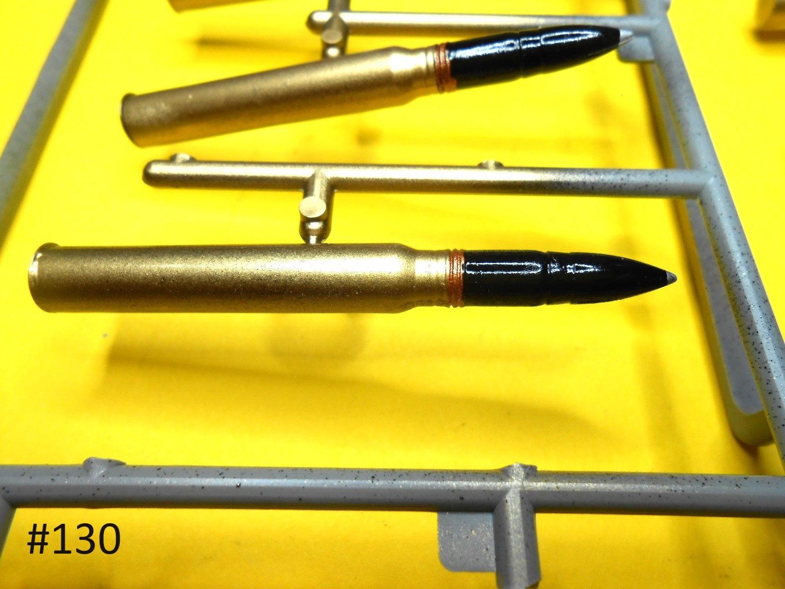

I painted the ready rounds gloss black and when it cures I’ll paint the casings brass.

The Ammo is painted and the ready rounds installed.
First a coat of Gloss black.
Then the brass.
On installing the ready rounds I used thin strips of lead foil for the hold down straps.
After painting the strips Khaki the first round is installed.
I hooked the strap under the hook and installed the second round.
Finishing up with the bottom round.
Tucking the end of the strap through the bottom eye.
This is as close as I can get with the camera.

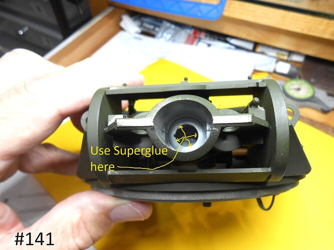

I have the Gun mounted in the turret , I had a spacing problem as there was a gap on both sides at the front.
I don’t know , Maby I screwed up there , but it all fit on the bottom.

I expect with the turret being made out of several parts its very easy to slightly misalign something and not notice till it bites you later. Very good recovery though Donald. I’ll watch for this on the Achilles as most the components are very similar if not the same.
