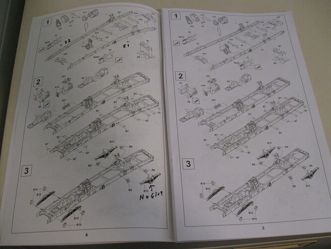

I got mine from the same Taiwan seller, and am trying to explain that the parts are shown, but not included. He replied back that the M51 is not armored, so I had to explain that the Peace Maker version is. Hope to hear back soon. UPDATE: He just got back to me and said he would check with the AFV Club team, so he must be in contact with them. Wayne
Good luck. Once they understand, they seem to get on board. Send them a pic of the instruction sheet like above, item 19, and ask him where the Q tree is? It’s not listed on the parts list in the instructions…but seems to be necessary to build the model as the clear parts provided aren’t correct for a gun truck.
Let me know if you get any pushback and I’ll throw in.
Thanks, I sent the picture, so hopefully they will be able to take care of it. Will let you know how it turns out. Wayne
Comparing instruction sheets and they appear to have just copied the first page for building the frame from the King Cobra kit for the PeaceMaker kit. It is identical and is the only one where they cut the frame to eliminate the winch. Just got lazy, I guess. Wayne
I’ve built up 3 of the M54A2 chassis so far (4 if you count the botched one) and I’ve been wondering why they don’t at least mention leaving the winch off for the cargo trucks. My understanding is that many of them did not have winches so it seems odd they would just leave you to figure it out. Then again, maybe not based on my experiences to date! I think the Peace Maker kit instructions have been cut and pasted from other kits but it seems whoever did it hasn’t ever built any of them!
