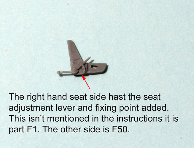

The Hobby Boss Spitfires have a number of flaws but I have wanted to produce a 1/32 scale model in the markings of Wing Commander Ian Gleed for some time. The photos are captioned.
