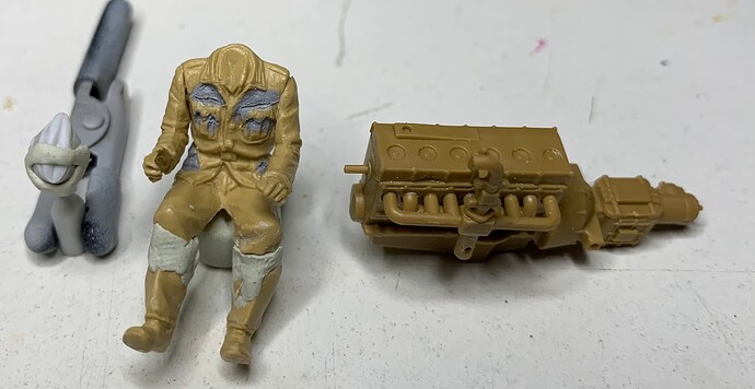

How much will you see? You could probably get away with either. There is always this option:
I would have probably used Fritz but Mitko is who got the uniform change. I will have to see if Fritz can find a recruiter till then the block option might be idea.
Depending on what you will see, another option is cut Mitko’s legs off at the knees, insert an armature wire and bend the wire until the feet line up where you want them, then fill the section between the leg parts with two part putty, extending the knees forward a bit. I have done that several times (plus a bit of amputation on occasion) when all you see looking down is a vague leg like shape.
Thanks, that is another great option. It’s probably more then I want to do but so was uniform modifications so in for a penny, maybe in for a pound. :thinking:
“A job worth doing, is worth doing well”.
View it as expanding your skill repertoire.
Mitko says he is not your friend anymore after you sent him to the butcher.
He doesn’t want to hear how you increased his dating life by making him taller either.
Hopefully tomorrow the mess with putty happens.
“Gotta’ pin it to win it!” Nice solution! … Seated Frankeneering ain’t easy.

Thanks. Seems to be Peter’s solution for many things (truck hood). The cutting and drilling part was easy, guesstimating the length and positioning while the super glue is drying was pain. At one point the cab was upside down trying to make gravity my friend. I think once done it will be good enough in cab as most people won’t see.
He is on a rakia drip post surgery. Dr’s order he not have any before hand as it thins the blood and that would be messy. The Dr however had some before hand. :sunglasses:

Bit more detailing on the Horch 3.8 V8 engine, that drove the 5th Serie Sd.Kfz.222 I’m building:
HT leads were added and the prominent oil-bath air filters were built and mounted.
I thought of removing the engine cover- it was never present on the real thing, but as I’ll build the upper engine hatch closed, the cover won’t be visible at all, so I’ll leave it and live with it.
Will probably need to add some wires here and there, but I’ll leave the engine for now and will switch to frame construction.
Angel

Rookie tip, if you find touching pinned extremities loose, reglue and wait. Dang Apoxie sculpt is hard enough to work with without reattaching limbs.
I did the best I could in the moment. Hopefully sanding and what not can get me the rest of the way.
