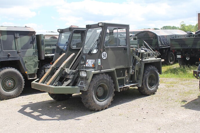

Can anyone educate me as to why this particular fork-lift has what appears to be double seating? Presumably it’s for more than driving on the other side of the road?

It only has one steering wheel the other side is a passenger compartment.
"The fUG has a full 4x4 configuration with the front-lift mast situated centrally at the front between two cabs. These fully enclosed single-seat cabs are for the driver on the left and a passenger on the right, both cabs have heating and soundproofing. "

Perhaps I’m being a bit slow here but why oh why would a fork-lift - even a military fork-lift have a passenger compartment? I don’t quite understand the requirement. I’m sure the Bundeswehr knew what they were doing but it sort of beats me(!)
German way of thinking. The FUG is able to do a road march. So it needs a vehicle commander. Also, a second person is helpful with all the equipment( long forks, crane hook). And it´s not just a forklift, but rather a German Swiss Army Knife.
Possibilities:
  1. One driver and one commander to tell the driver what to do
  2. One driver and one assistant, assistant rides in cab when moving to another site and runs around outside assisting with the loading/unloading when they are on site. Directing, handling chains and tie downs, second pair of eyes in tight spots …
