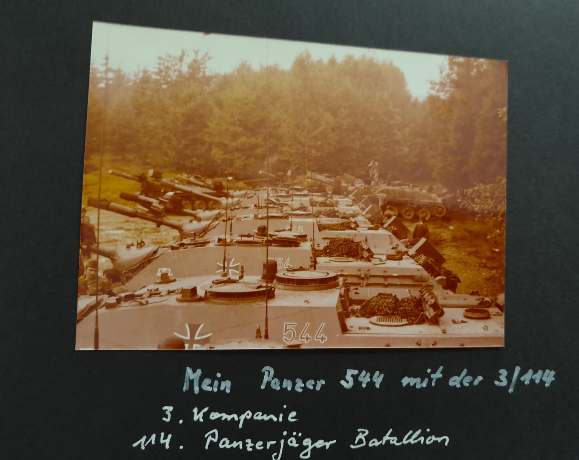

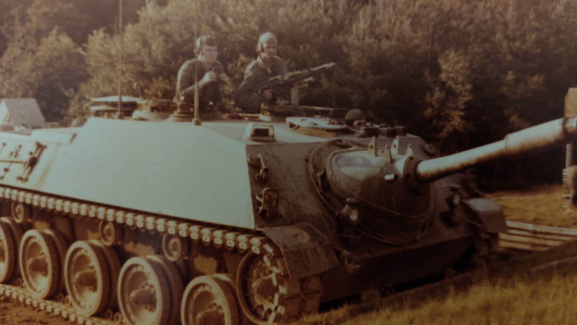

I was asked by a customer to do a commission build for him. He was part of a tank crew within the bundeswehr during the cold war. He asked me to build his former ride, tank no. 544 of the 3. Kompanie of the 114. Panzerjägerbattaillon. They were equipped with the Kanonenjagdpanzer, the only gun equipped tank hunter of the Bundeswehr. It was intended to withstand a russian tank onslaught but its 90 mm tank gun soon prooved as too weak for frontal penetration of more modern soviet main battle tanks. The gun barreled tanks were therefore later modified to carry anti tank rockets instead a gun.
This are two pictures of the ride of my customers privat collection

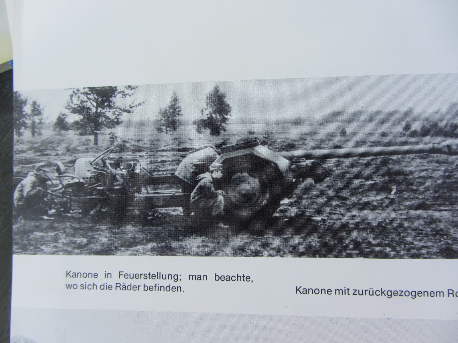

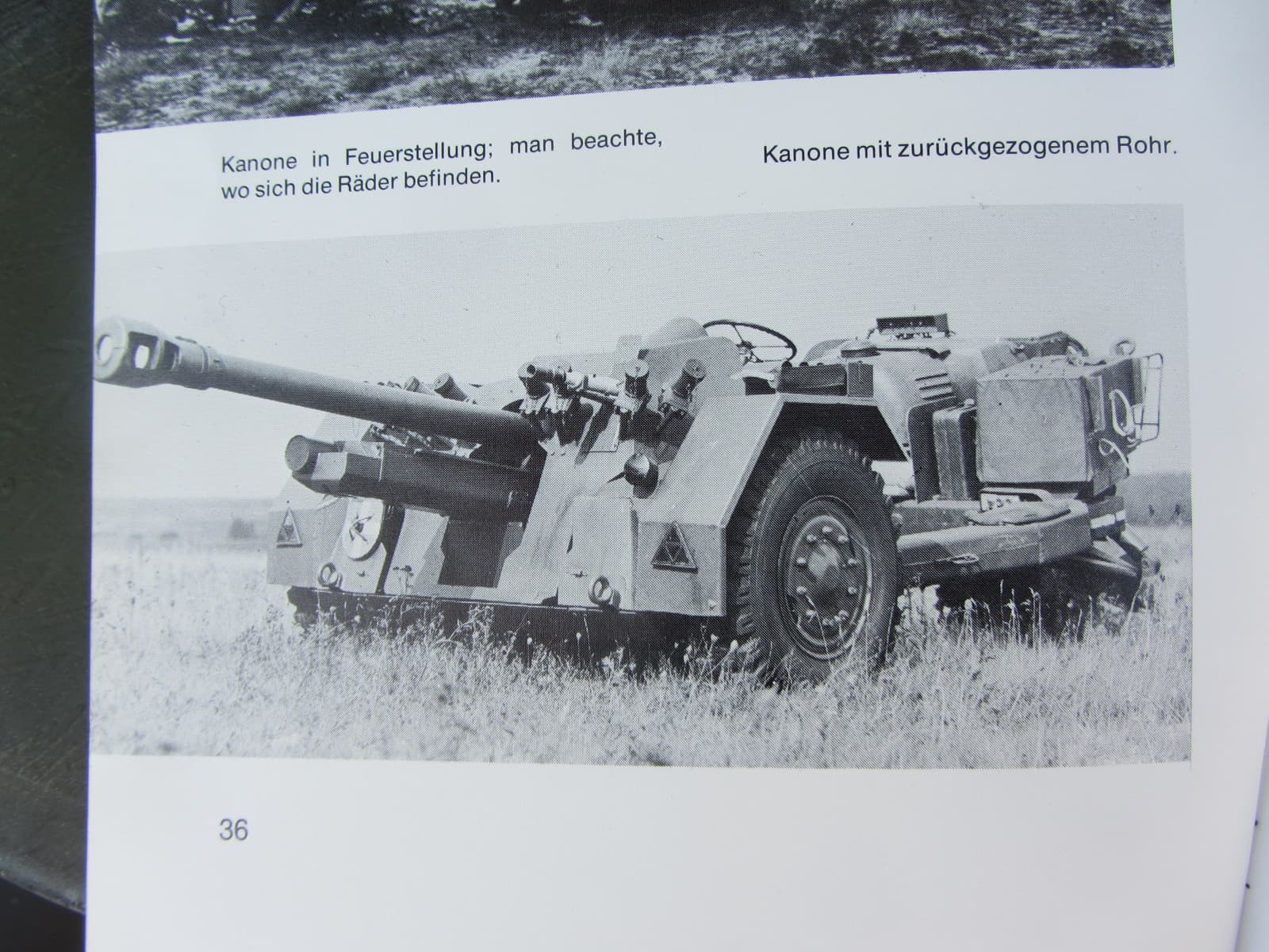

I found informations and pics in my library about a 90mm SP Panzerabwehr Kanone PaK prototype, but sadly nothing online

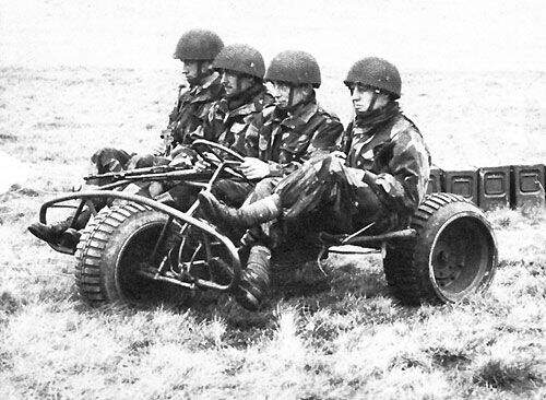

I’d be interested to ss it; I have always wondered whether or not the wheels on the Kraka would be the same as those used on the FN Para tricycle:

I read on a placard of the Full museum that 3 prototypes of the KaJaPa were built before Bundeswehr chose the one which entered production. Is the PaK you’re talking about one of them?

No Olivier, It´a really TOWED AT gun based on the 90mm gun. It had an engine on it like the FH70.

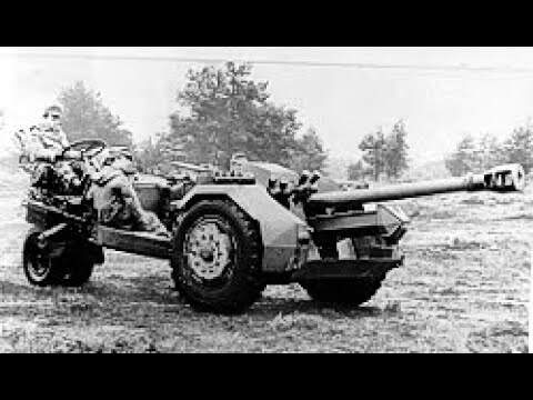

I think Hermann might be talking about a prototype 90mm gun which was normally towed (I think) but had an auxiliary engine so could move under its own power; I’m obviously Googling wrong as I can’t find a picture of it. Cancelled in the 60s I believe.
On the other hand, Hermann might be on about something else!
Ah, with a bit of lateral thinking and a modicum of German, I found it - or at least the one I was on about:
The only prototype build by Rheinmetall in the 1960`s. I found it in a book froom 1975(!)
