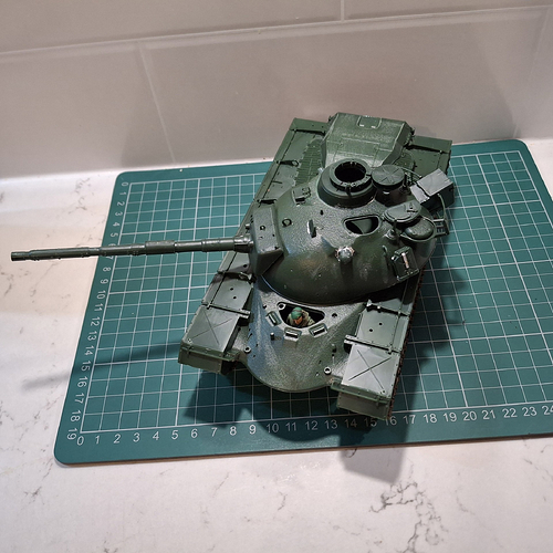

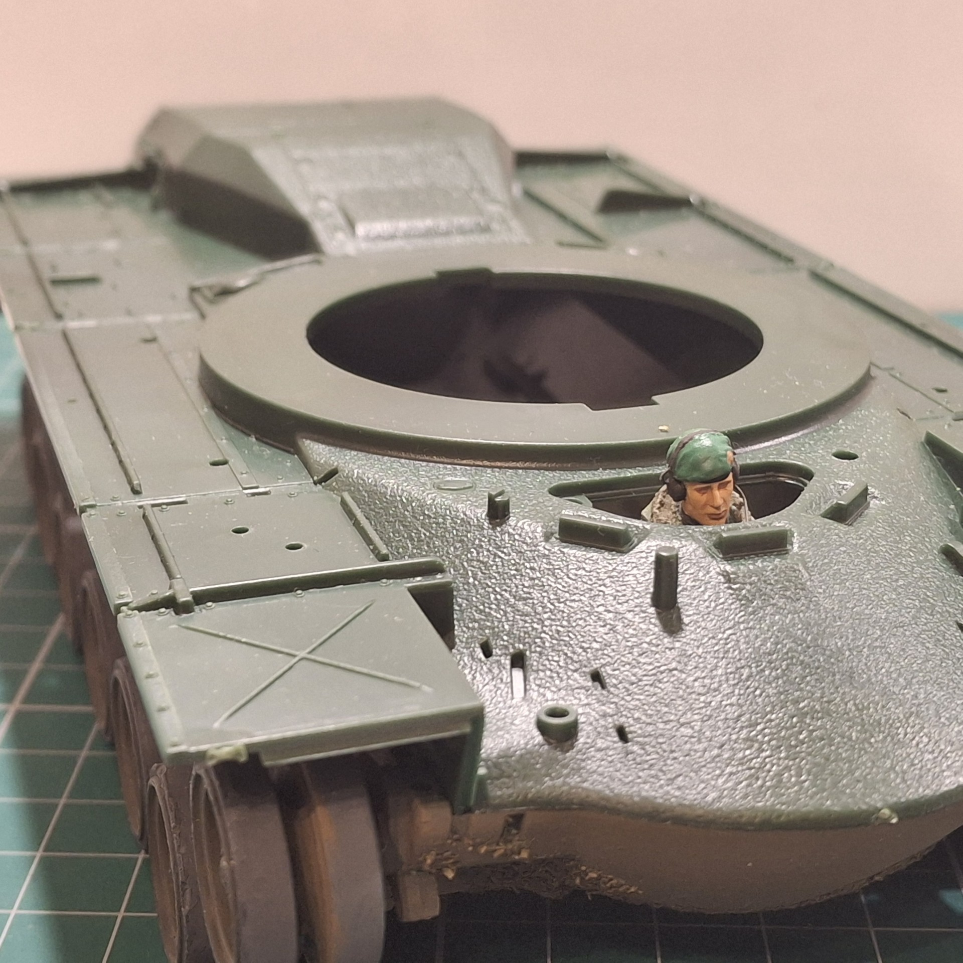

You will note I’ve nearly finished the hull, and have installed a driver figure at this stage. Modellers will be well aware of the over-pronounced cast texture of this kit; this time around I have lightly sanded the hull rear; I believe the rest will not be so visible after a coat of primer and the final colour. That policy seemed to just about work on my US version.

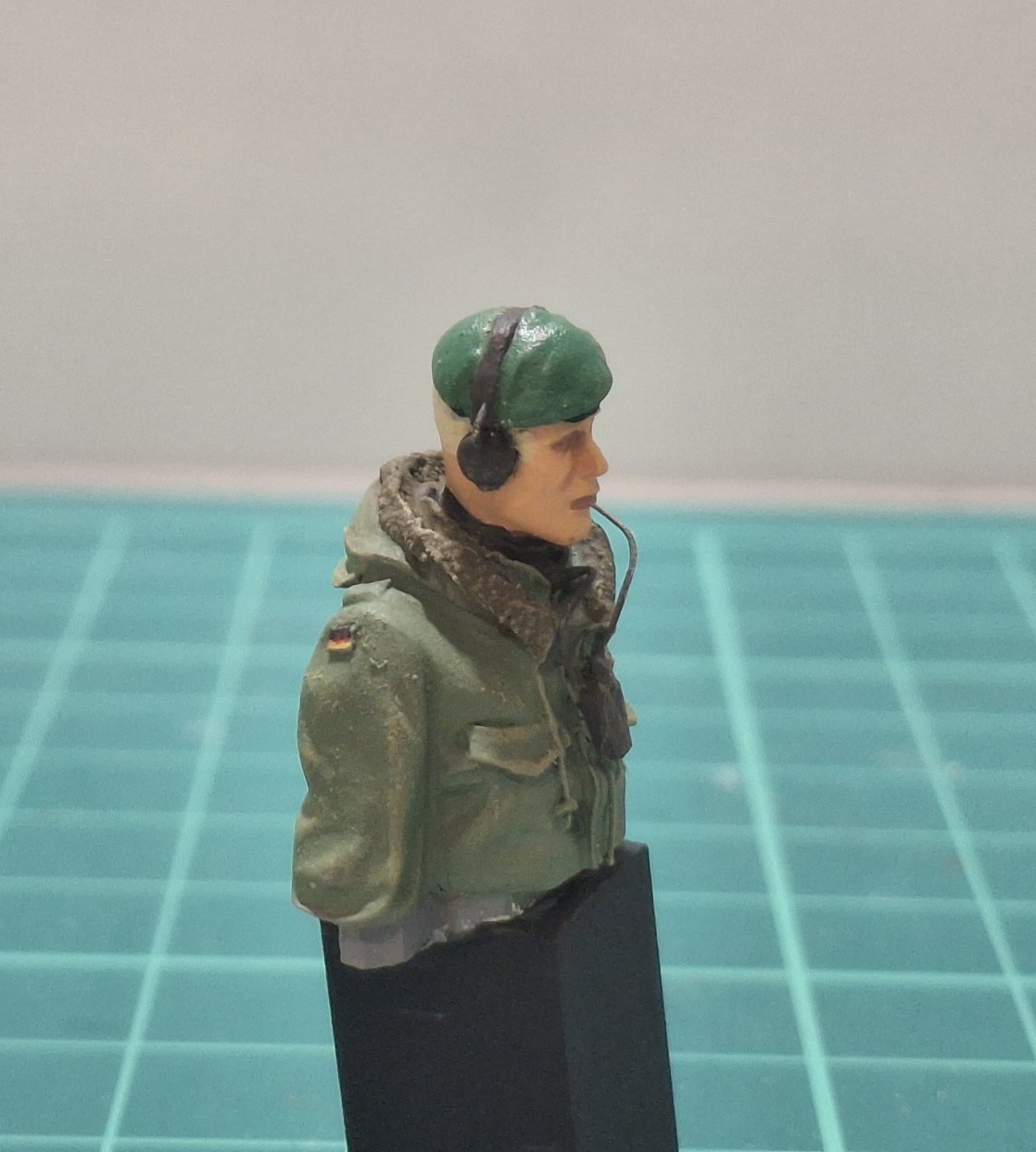

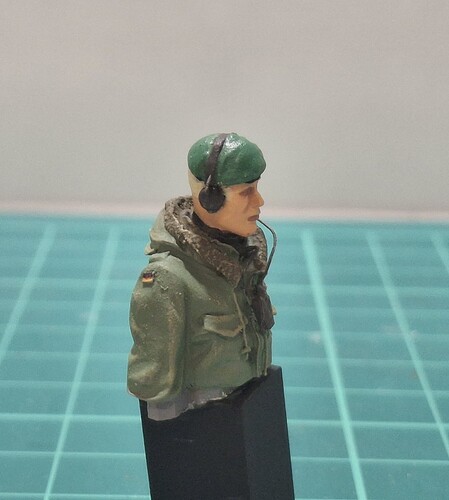

I haven’t outlined the plan so here goes: a simple build I hope, no extraneous figures other than the crew, depicted on exercise, either parked up on a road, transiting a road, (which is getting a bit boring now) or negotiating the exercise area – which may mean ruining a farmer’s field. Whatever I select, may not be that discernible, as it will be on an A4-sized base. We’ll see. Finish will be in Gelboliv, and will represent a tank from Heimatschutzbrigade 53, specifically Jägerbattalion 531, not least as their crews sported the Jäger green berets which will ring the changes a little I thought. Here is the Driver thus accoutred:

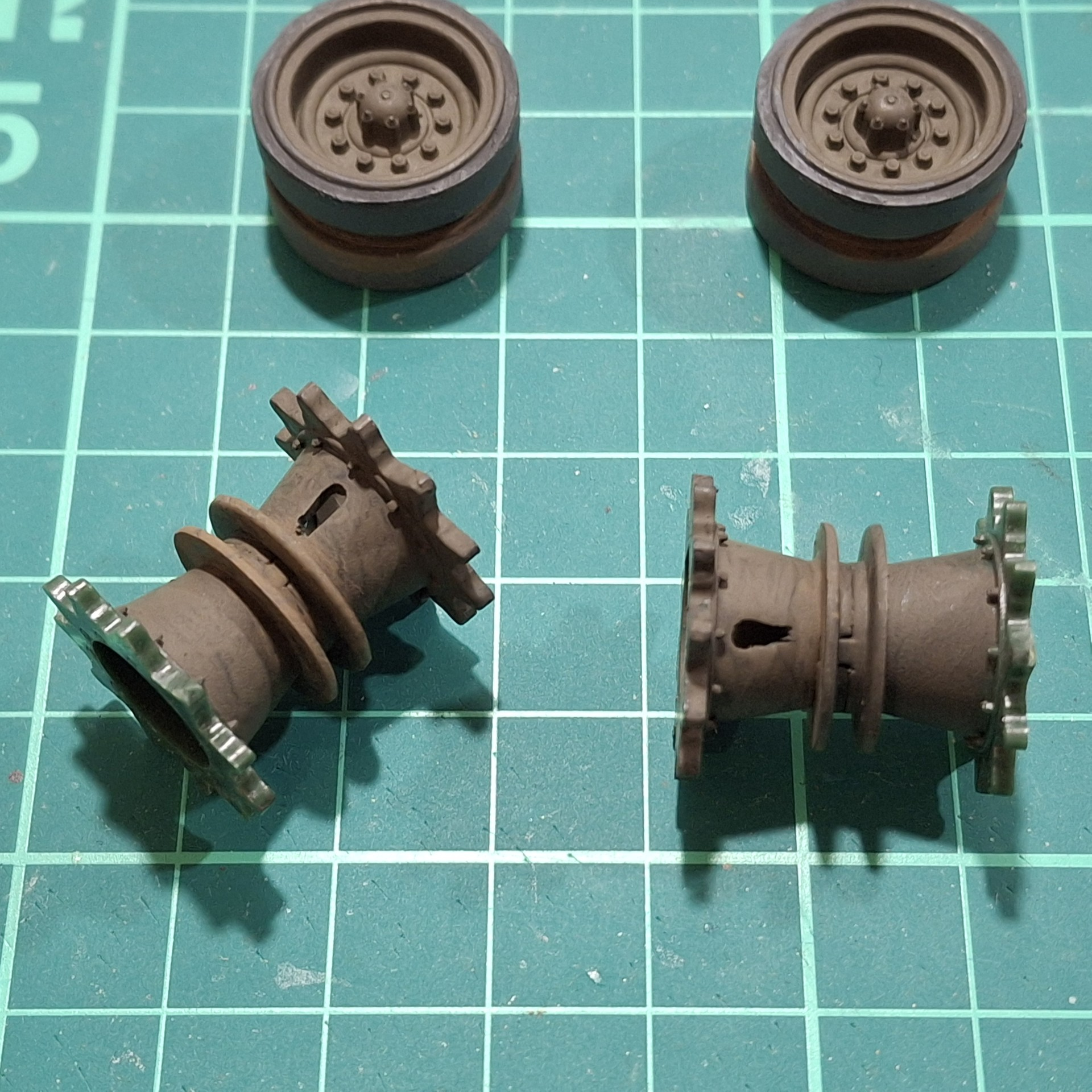

I’ve also made some mods to the drive wheels (I forgot on my US model):

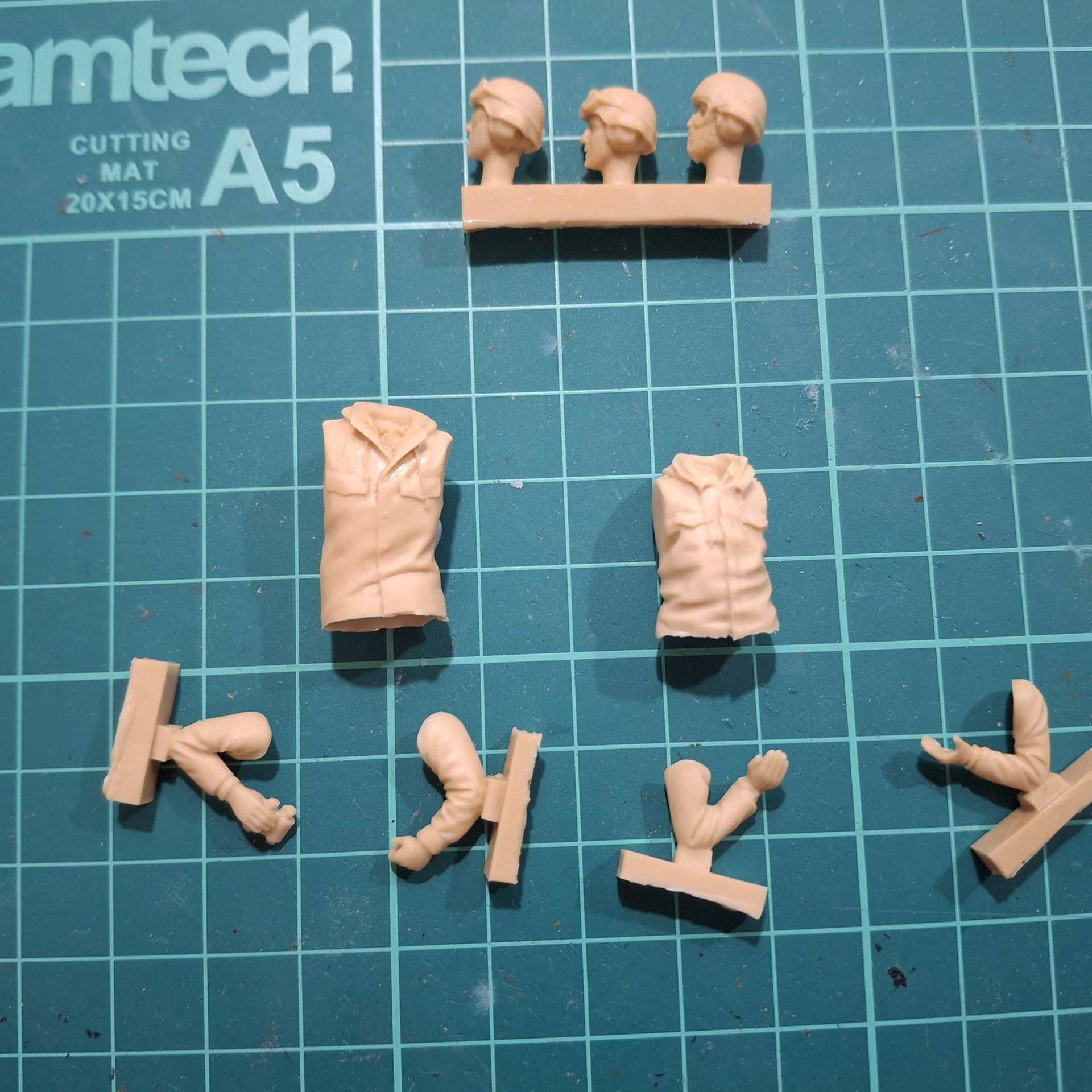

There might be those who are interested in the figures I’ve identified for crew; I used the ancient Verlinden set (this image a bit blurry from Scalemates) listed as Israeli Tank Crew, but as it happens, they’re sporting Bundeswehr Parkas which makes them ideal; all I need to do is find some replacement heads and add comms kit:
(Driver figure already in place obviously).

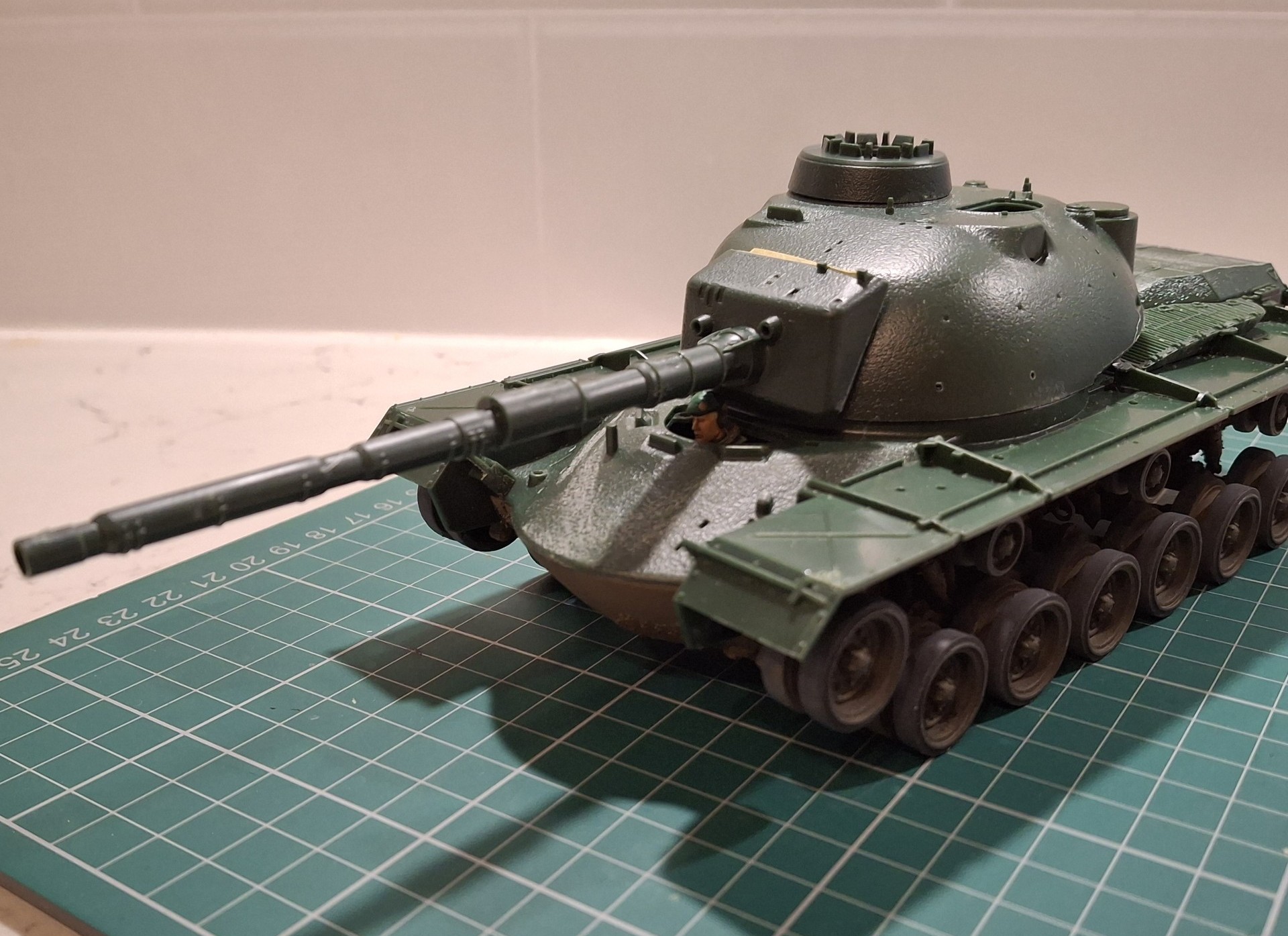

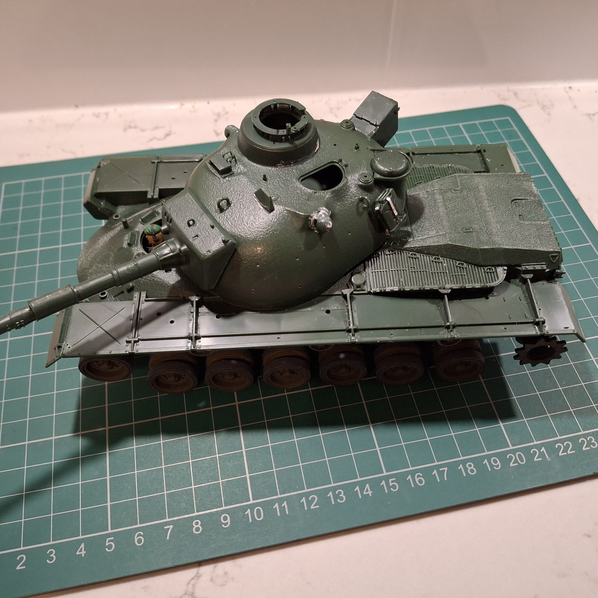

A little bit of seeing how it will look, with the mantlet and gun and Comd’s cupola in place; I think it looks notably different, and powerful!
These sets are doubly useful, coming with two sets of heads in different headgear… :wink:

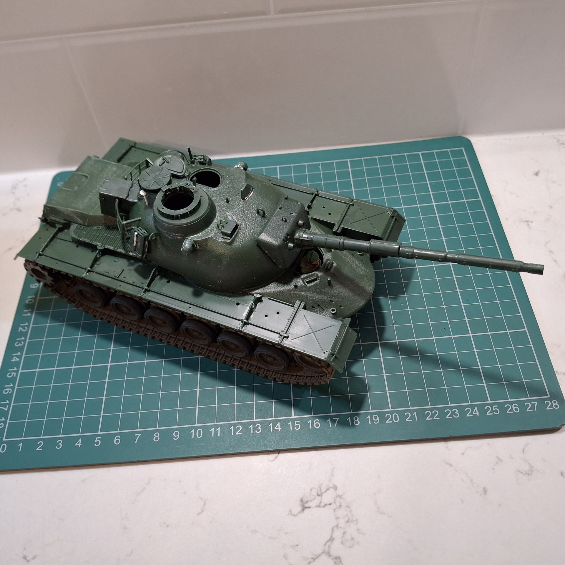

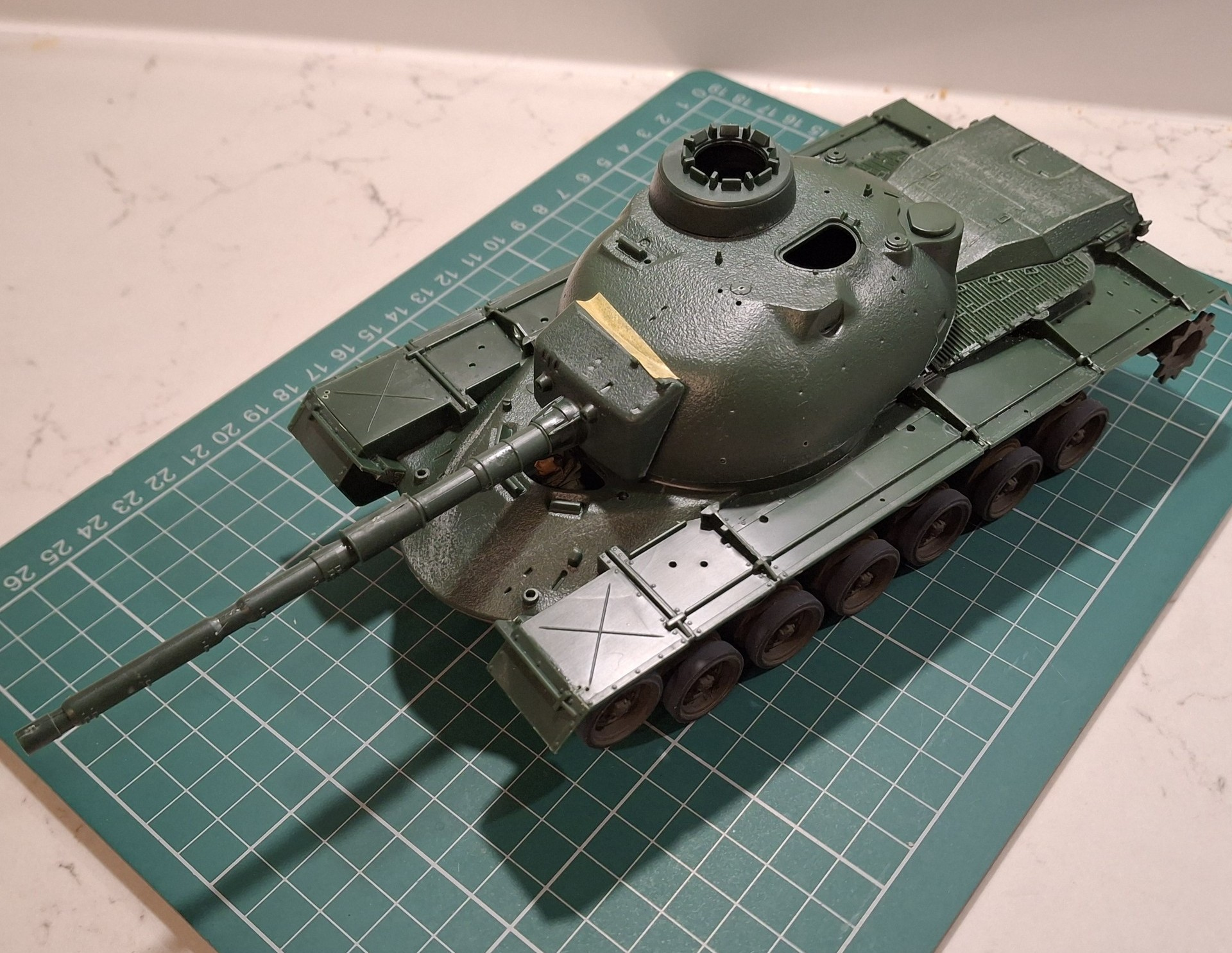

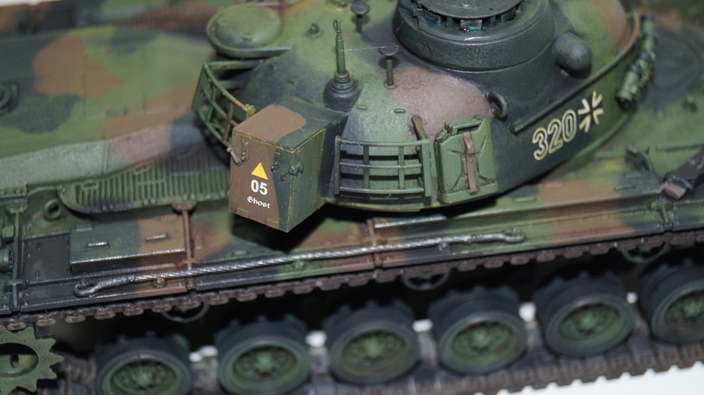

Work continues and I feel the turret is beginning to look noticeably different. Installed on the hull, the tank seems to take on a whole new persona:

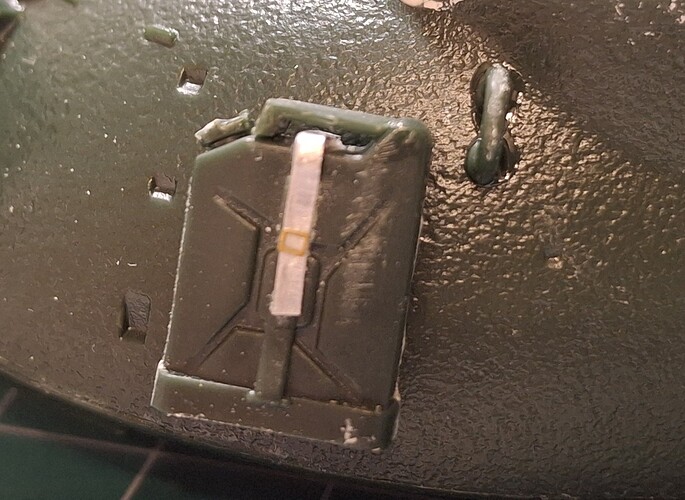

Details added to the straps on the jerricans:

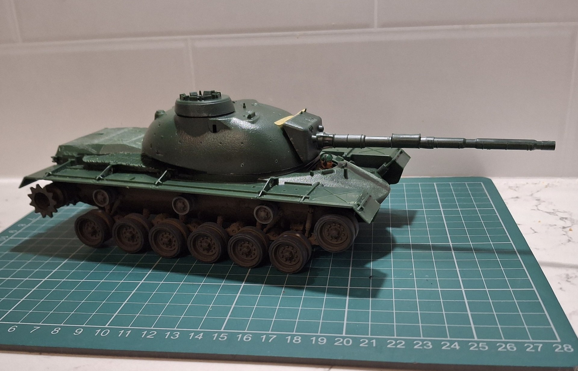

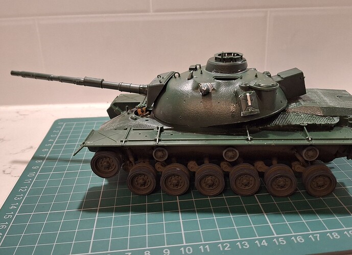

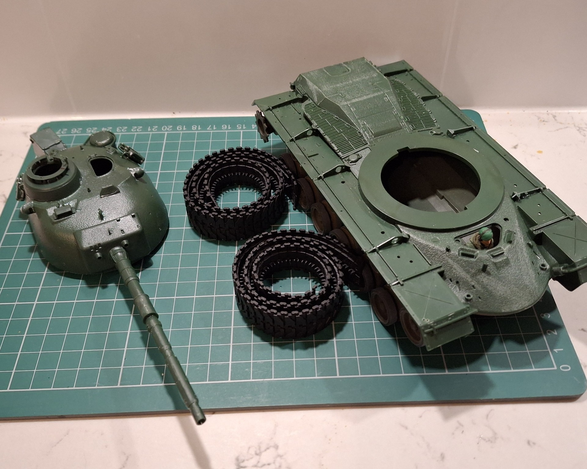

A bit of work on the turret this evening; tracks are also on (though not especially visible):
