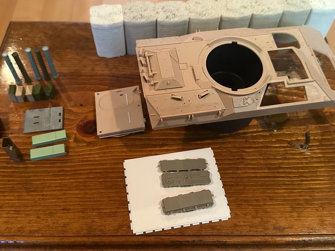

The only question is, one 463L or two?

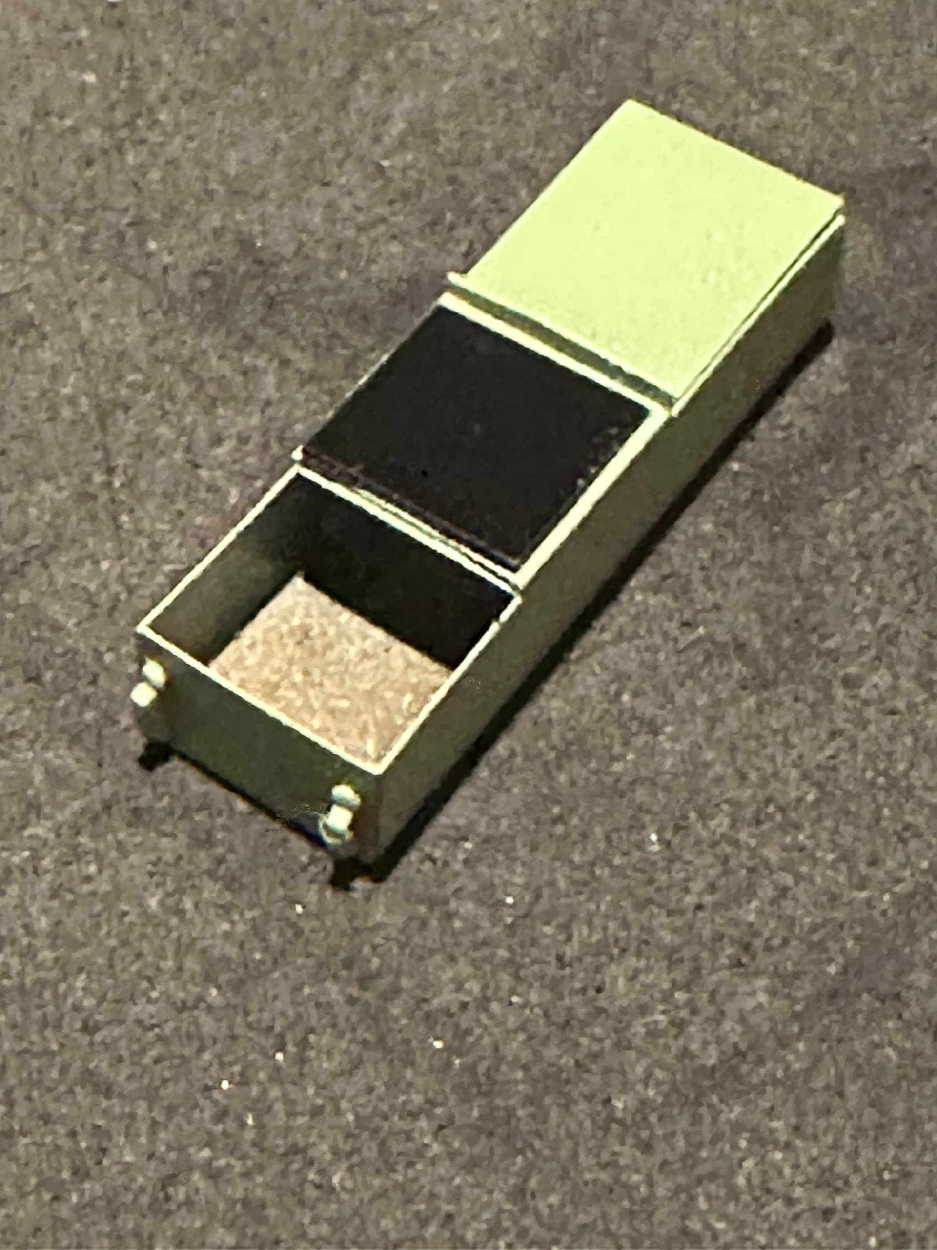

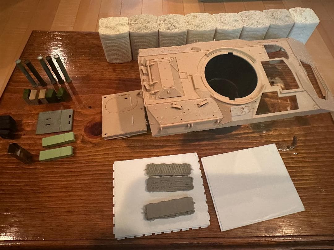

Completed box. The next two (or three) should look better. The rubber isn’t attached yet, so I can fix the slight error in the angle. This one was a learning process. Like the other one, I need to reglue the lid a little. But I do like how you can tell it’s a separate piece.

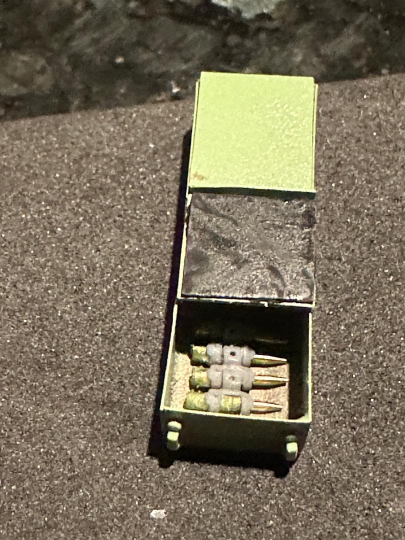

The metallic color turned out better than I thought. I just needed to give it time. On some of the rounds it got a little thick underneath. I’ll either hit them with thinner or just leave them. They’ll be on the bottom row anyway. Rounds are stacked in the box in three rows of 17, 16, and 17.

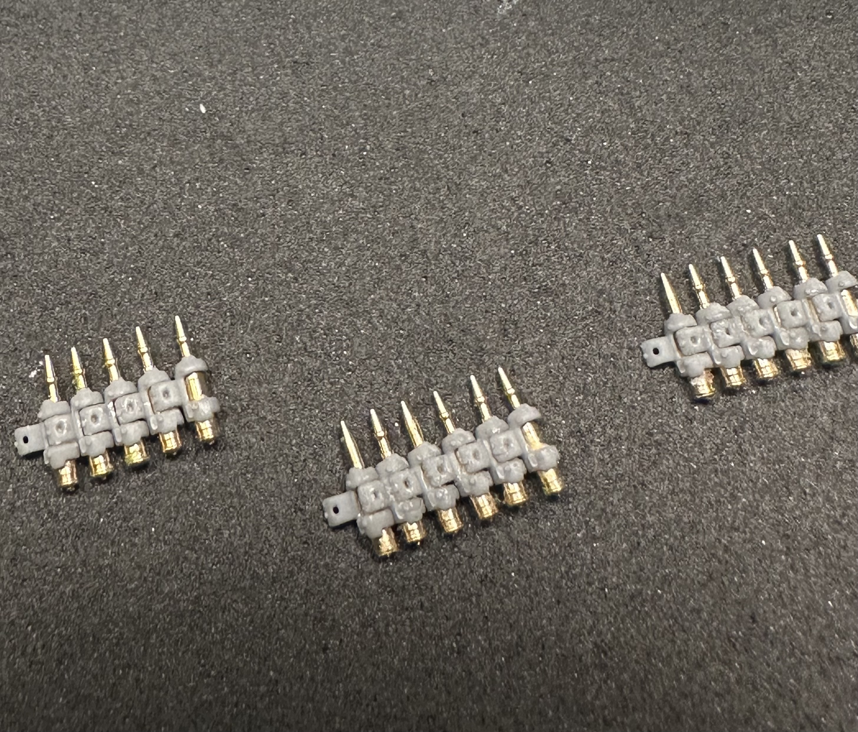

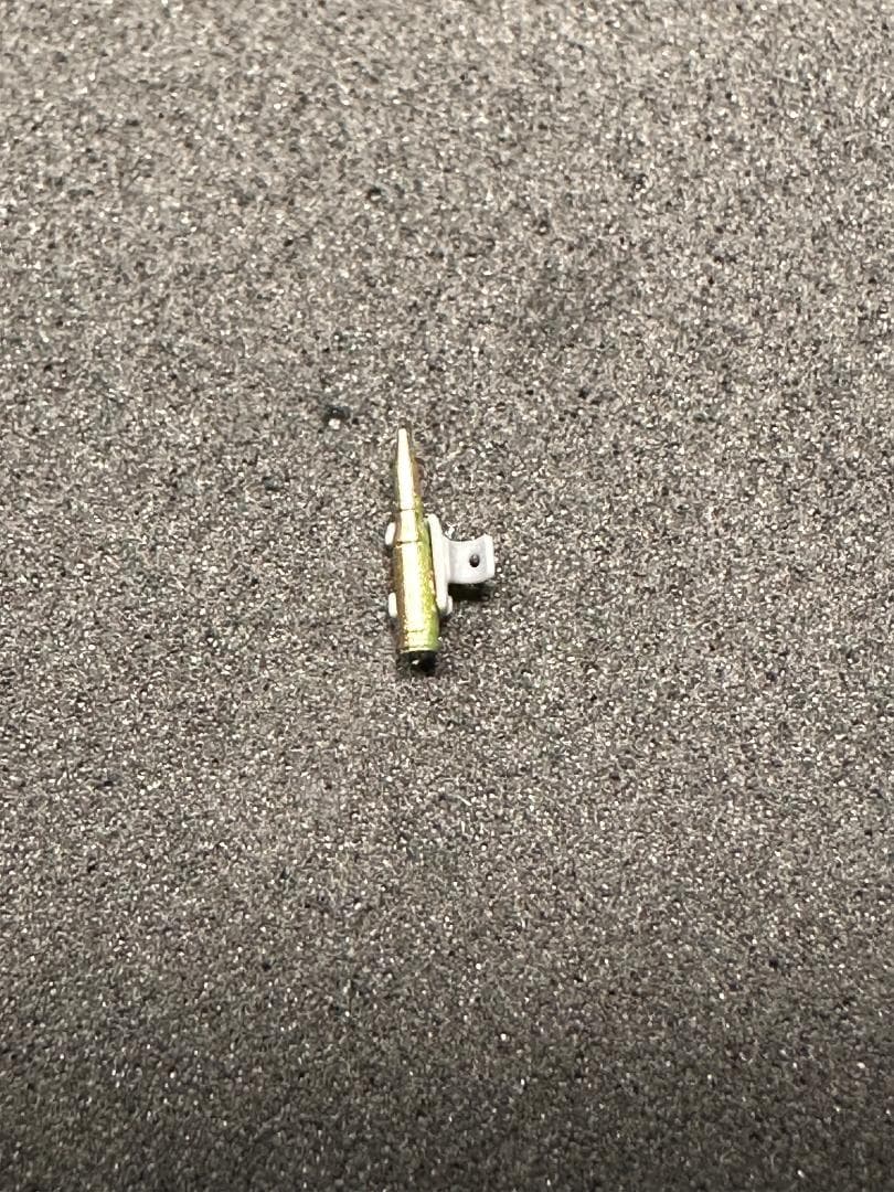

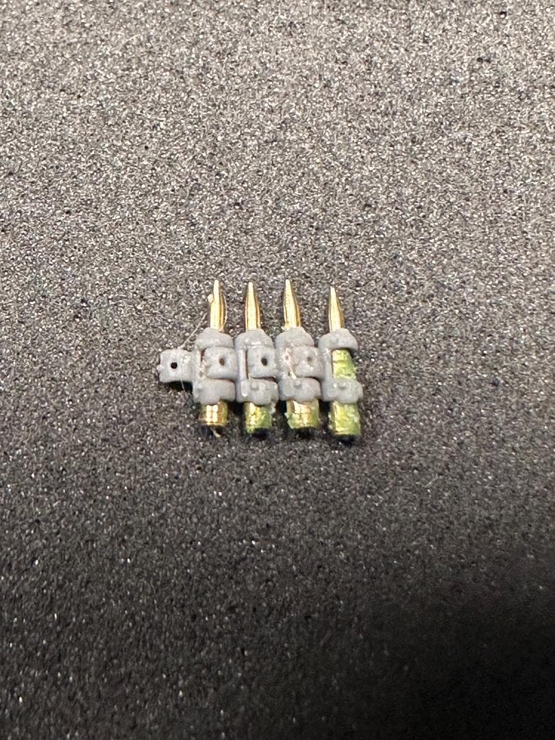

I’ve found this is the easiest method:
Place link with single end facing to the right. With a small amount of CA, place appropriate round in link.
Apply small amount of CA on single link and roll completed round/link combo to the left on top of neighboring rounds.

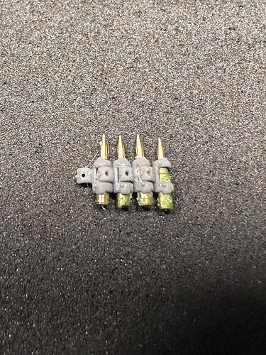

These are a little ugly but after this run I’ll paint everything afterwards. It’ll be much easier all the way around.

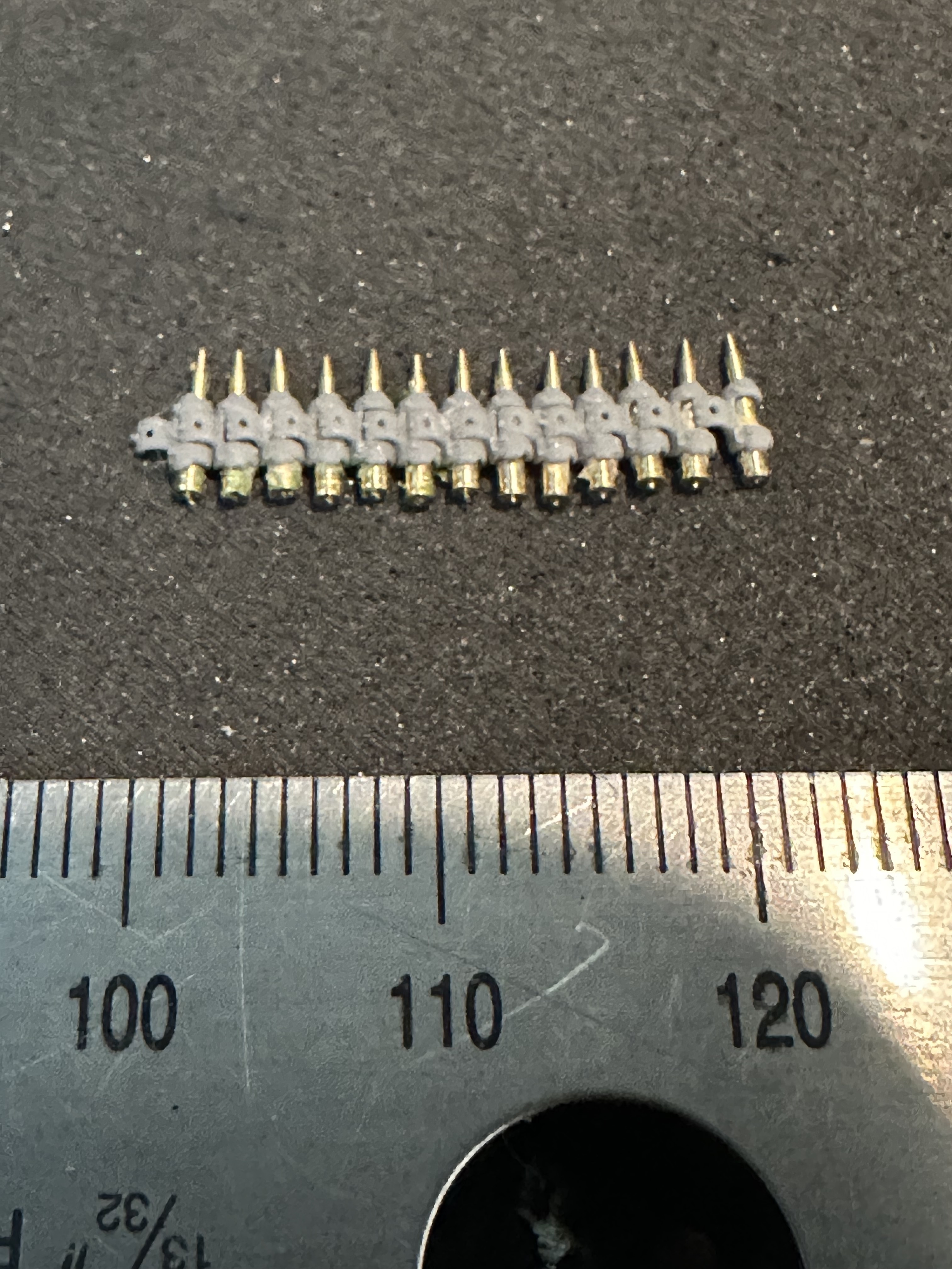

They fit into my box. I haven’t added the inner rubber padding yet, which will take up a scale .7 inches. It should look very good once I’e done that.
I did all of the HE rounds save two, which I’ll need to add to the AP rounds. The metallic paint came off pretty easily. I think it’ll be easier to paint them this way.
They’ll certainly look better than in the above photo.

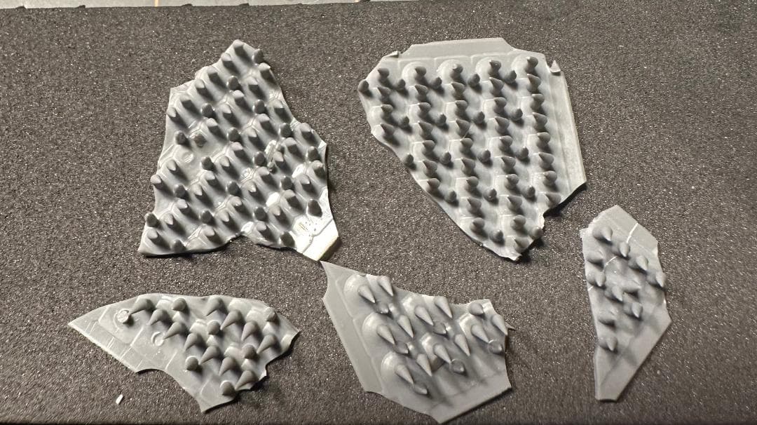

Here’s the best piece of advice I can give for anyone purchasing this set. The links are not easy to remove from the fret. It’s difficult to get a no. 11 blade in between all the little mounting points to cut them off. I’ve found the best way with a knife is to very gently cut the single link portion from underneath and behind the part. It will pop off of the two mounting points, but there’s a better way.
Grab a sprue cutter.
Locate an area on the 3D printed base where you can get the sprue cutter in and grab the whole piece with the sprue cutter. Turn it over so that the links are facing downward. Cup the whole thing with your hand to avoid losing any links. Snap the sprue cutter closed. Just the snapping sound will loosen several of the links at one time. Repeat as necessary. Once I discovered this removing the links went very quickly.

Now that I have a good system down I’m out of ammo. I need a few more sets!

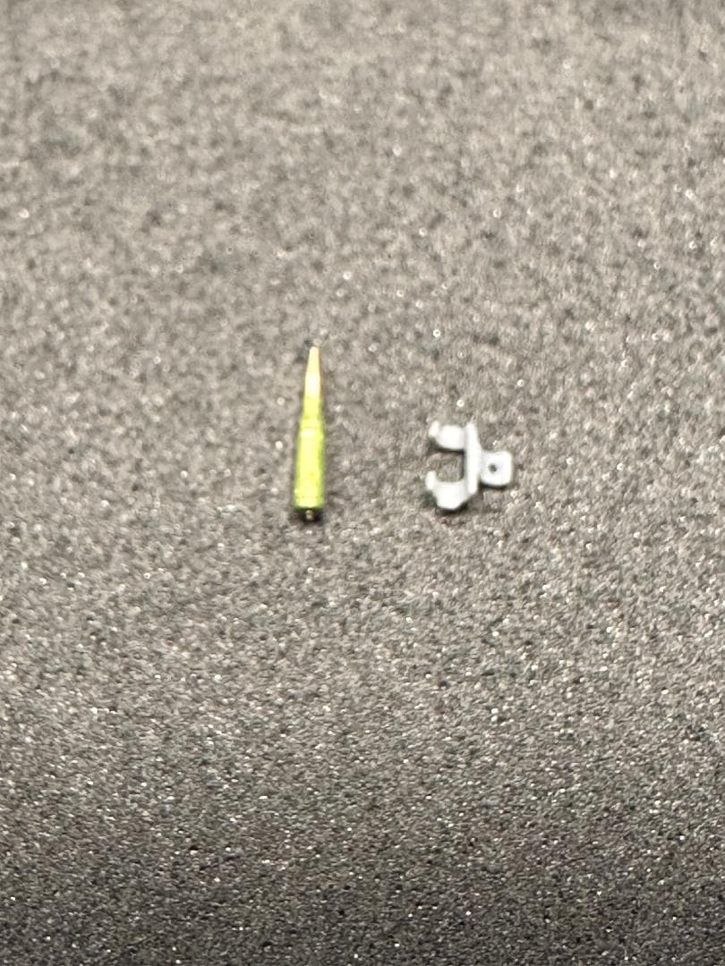

I just made a pretty cool discovery.
If you buy Jacque’s footman loops, they’re mounted on these tiny little spikes:
One looks like this:
Which fits perfectly into one of the spent casings. Remember the range? Who doesn’t like bonus rounds!?

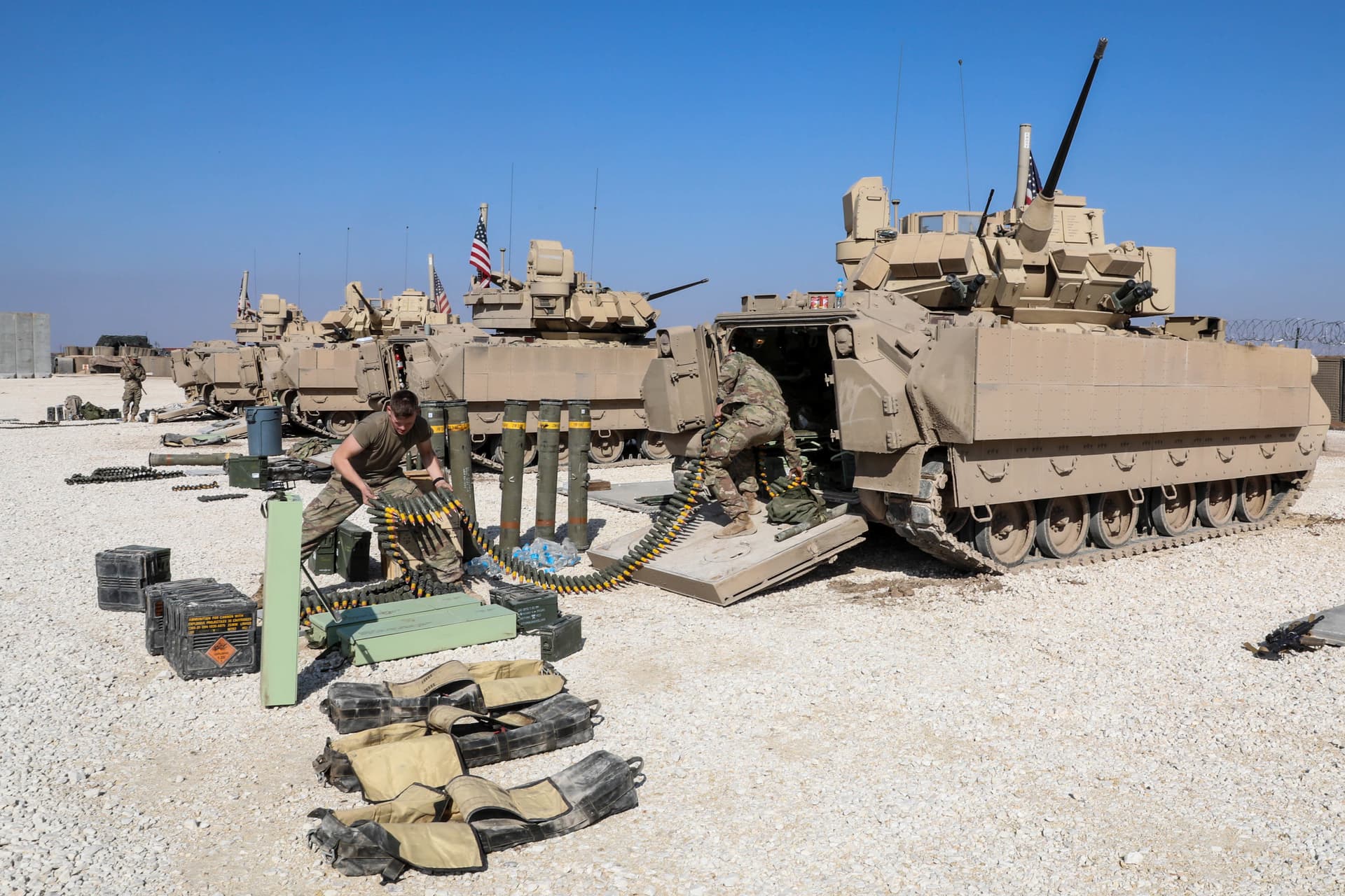

Both style boxes in Syria, 2022.
For what are used those long and flat bags ?
That’s the photo that was the inspiration for this:
I believe they’re covers for the ammo boxes stowed under the dismount compartment floor.
Barely visible in my linebacker walkaround from Ft. Hood last year.
I have been working making them from Milliput, but so far am only 95% satisfied.
If I did them closed it would be much easier.
