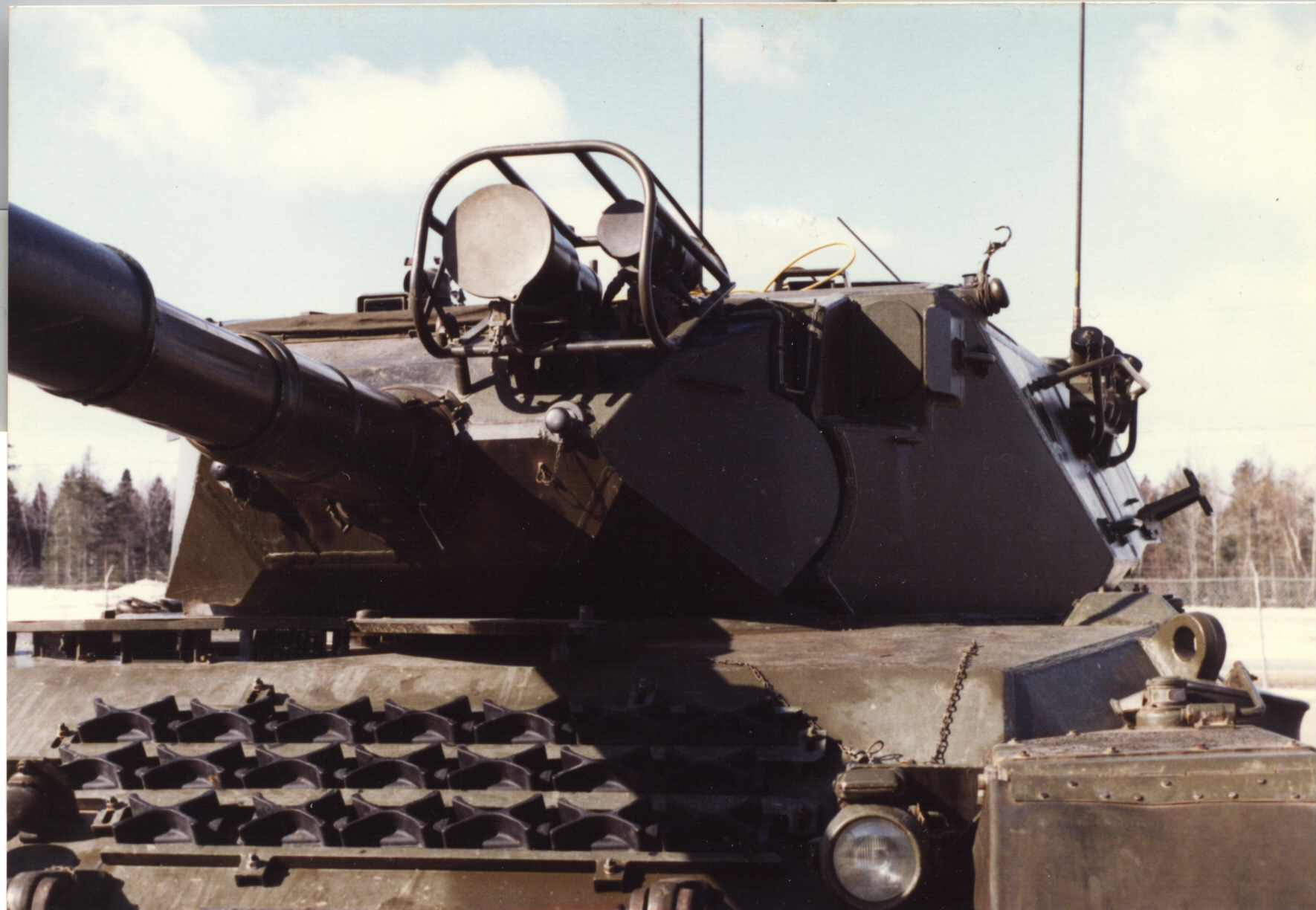

I bought the Legends C1 late Canadian Leopard conversion with the aim to do a C1 earlier then the Legends C1 late.I remember buying the MLM C1 turret set from Trackjam models after seeing Jason Bobrowichs build in AFV modeller magazine.I kept a few of the pieces but lost the mantlet cage for the PZB 200.I dont fancy doing the turret basket in the Legends set for the late C1.Not my idea of fun bending lengths of brass rod into shape using a paper template.Well what im asking is did only the later C1 Leopards use the wider cage for the gizmo?.Its a shame nobody has done a kit of the C1 apart from the mexas clad one.The C2 mexas version isnt so appealing to me.Hoping Jason or Anthony Sewards might look in.

Our Leopard C1’s went through quite a few modifications during their service life, the PZB 200 camera issued late 1979 early 1980, single protective cage installed, IRS 100 thermal pointer issued, double protective cage installed 1986 . If you let me know what time frame, deployed in Germany or Canadian version, as they looked different….. I can help you out, plus if you are looking for the best Reference on the market, there are digital reference sets available from Trackjam Models. The sets have the largest collection of photos and reference material, plus a complete list of modifications done to our tanks during the service life…. On the plus side there is a plastic kit planned in the future, there are resin turret conversions from Maple Leaf Models if you can find them, that have a fantastic detailed turret and cages….Feel free to message me anytime if you have any questions…..

Short answer yes, the turret basket was only on later C1s.

Hopefully between my answer here and on Facebook will help you out. The early version used the smaller cage as only the PZB 200 was mounted.
If you build a mid version of the C1 you will need the larger protective cage for the IRS 100 and PZB 200. What is a mid C1 version you say? It would include the larger cage for the PZB and IRS, the angled armoured cable bracket on the glacis plate and armoured cable connection cover (these were phased in over time), and the added turret side storage racks.

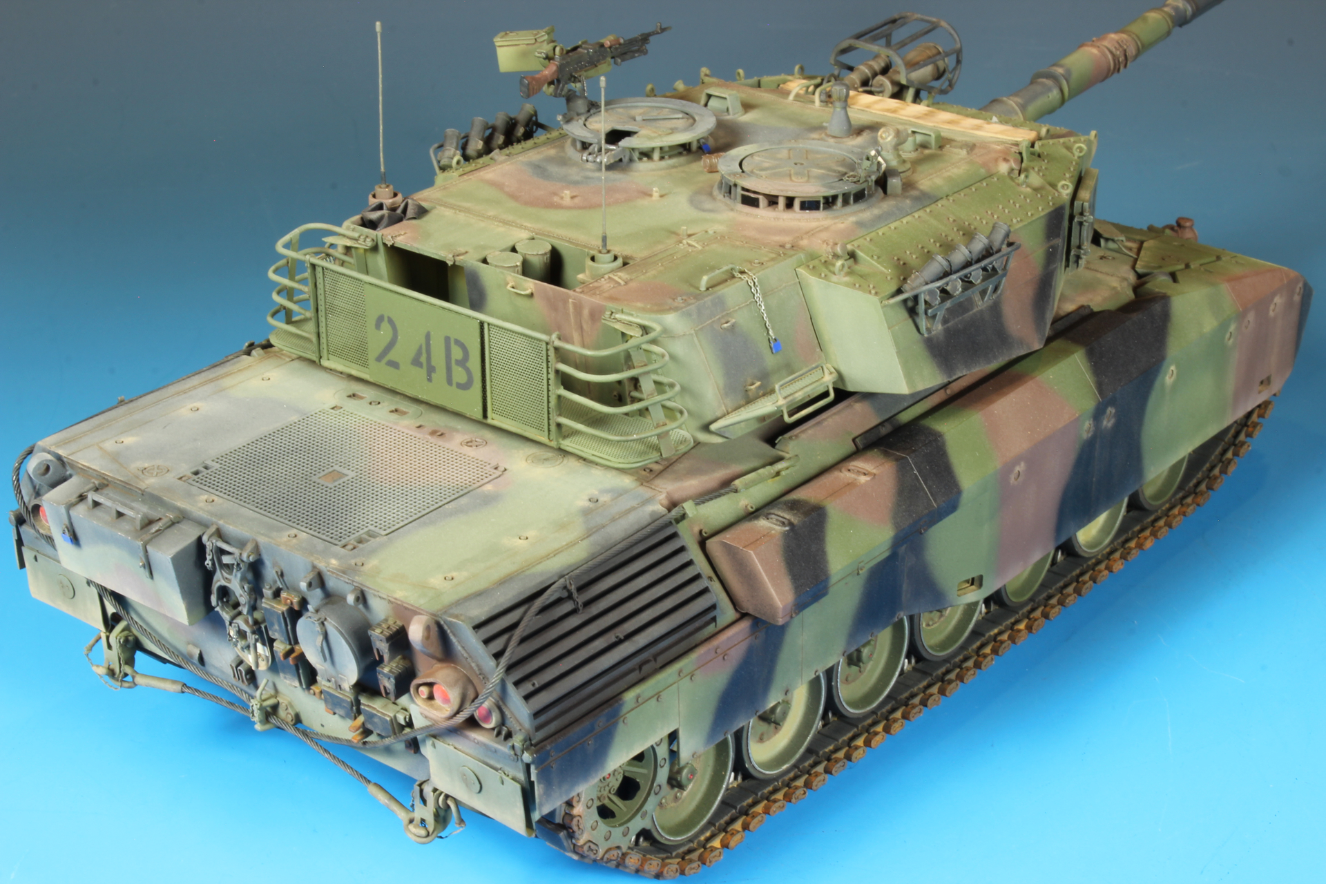

The late version C1 would include the mid version details plus the add-on rear turret bustle rack, the welded on MEXAS mounts, and the reconfigured layout of the glacis plate grousers.

The Legend’s PE, etc. for the late version turret bustle bin wasn’t too hard to create on my C1 MEXAS. It just took preplanning. I hope you enjoy those Leopard articles…more of them to come!

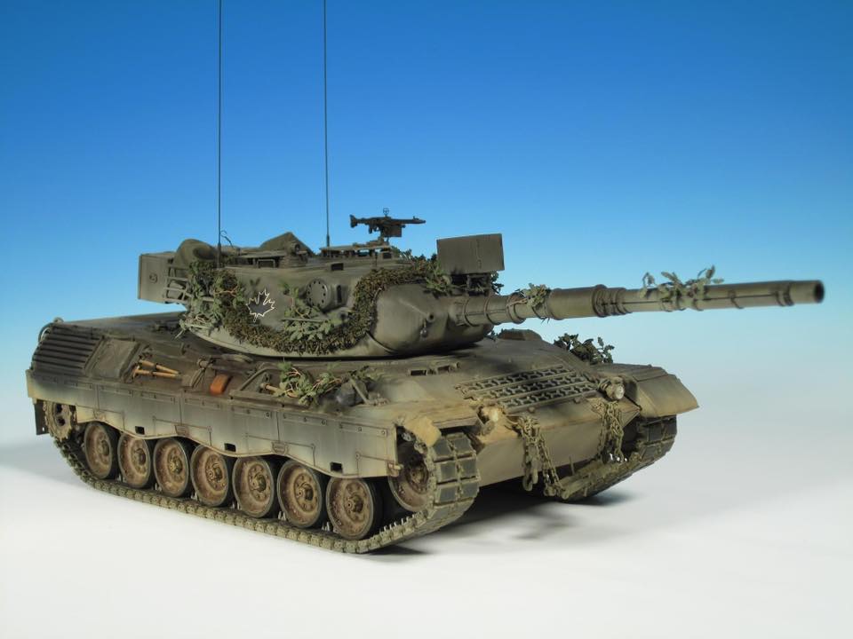

I did indeed build a Canadian Leopard 1A2 Rent-a-Tank.
