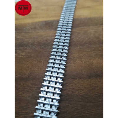

Tracks are done and on, as are the side skirts.
Quite pleased with how the tracks turned out, and once they get the sand pigments and the dust wash added I think they will be looking ok.
Also added a wooden stowage box to the front right fender in front the bin, used some rope coloured cotton thread to represent a thinnish bit of rope.
I followed @Bison126 - Olivier’s guide on the tracks, Tamiya cold iron, then AK oily steel dry brushed on the inner links to show tyre wear, and on the outside edges. Also used a very small thinned down amount of MIG Track rust only to add some depth colour.
Israel, @ReluctantRenegade , do you think the crews would of over painted the reflectors on the rear mudguards ?
Those are some really good looking tracks… and a very good looking tank!
Thanks. The tracks are beautifuly cast and come with brass pins.
