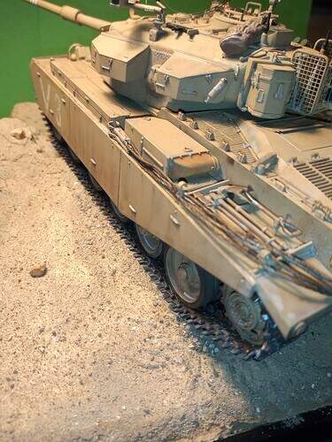

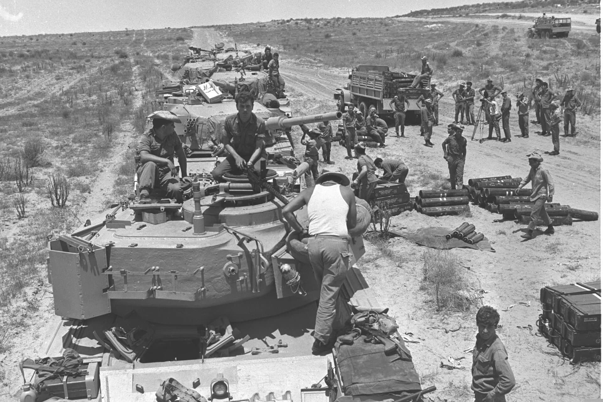

I have a question: what was this container / box for and were there any vehicles without it?
Piotr, I am no expert with these, but from what others have said who know a lot more, then IDF cents tended to have a mix and match of various bins/boxes etc added on in various places and at various times, so fitting or not fitting probably wont be an issue.
I think the gun-mounted searchlight was stored there.
Thx gents!it had no closure on the top, only a closing strip…

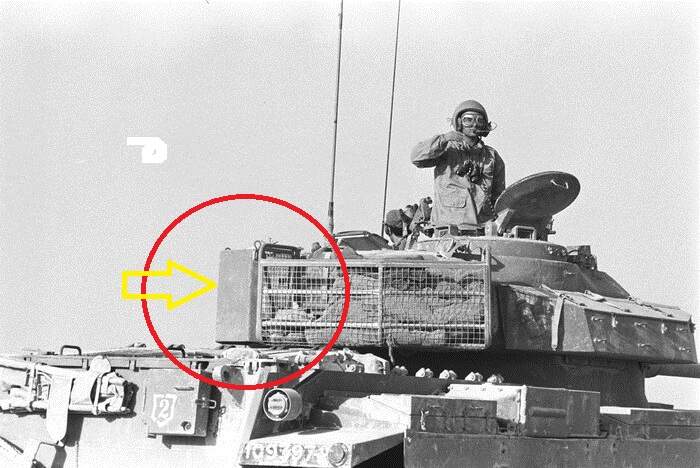

Israel, I know there are different Mks of IDF Cents but mine looks different and is mounted direct to the turret - the box on Piotr’s looks different and mounted on the basket ? did they have different types of main gun search lights ? I have no idea ??
The box is mounted on the hull, but in your photos it is half open and in my case it is completely, it looks like a flattened bucket :grin:
It is the container box for the round searchlight, similar to the one Magach 2 and Shermans carried. If I recall correctly it is of french origin. This box is carried on upgraded Shot and Shot Kal vehicles. It was replaced by the mount for the newer type of searchlight on the Gimel, as posted above

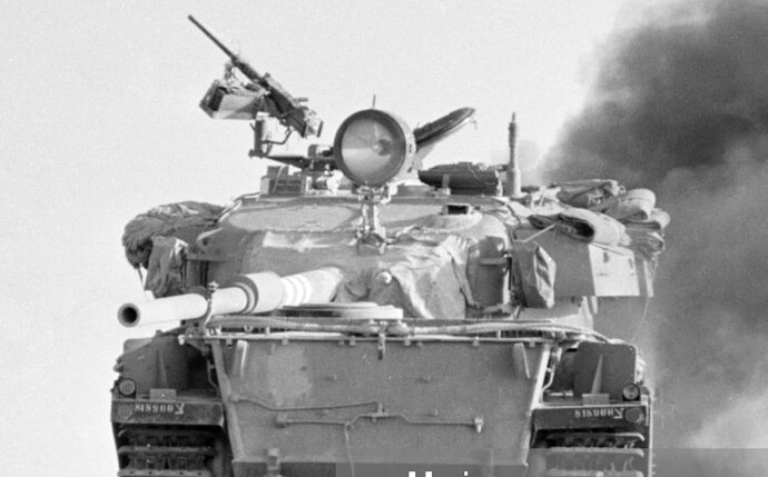

This is the original British type (circular) searchlight used on older marks:

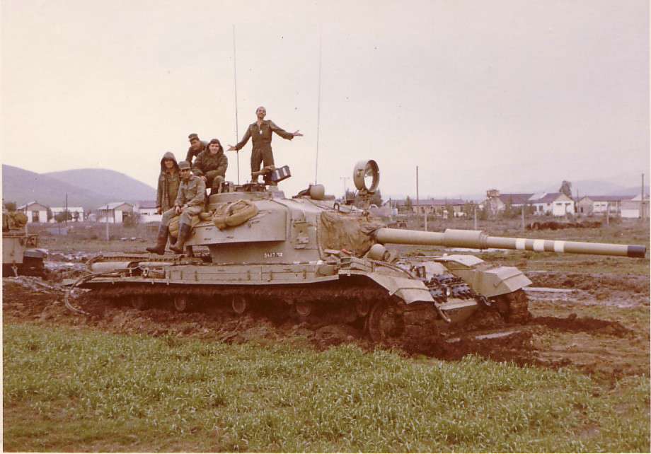

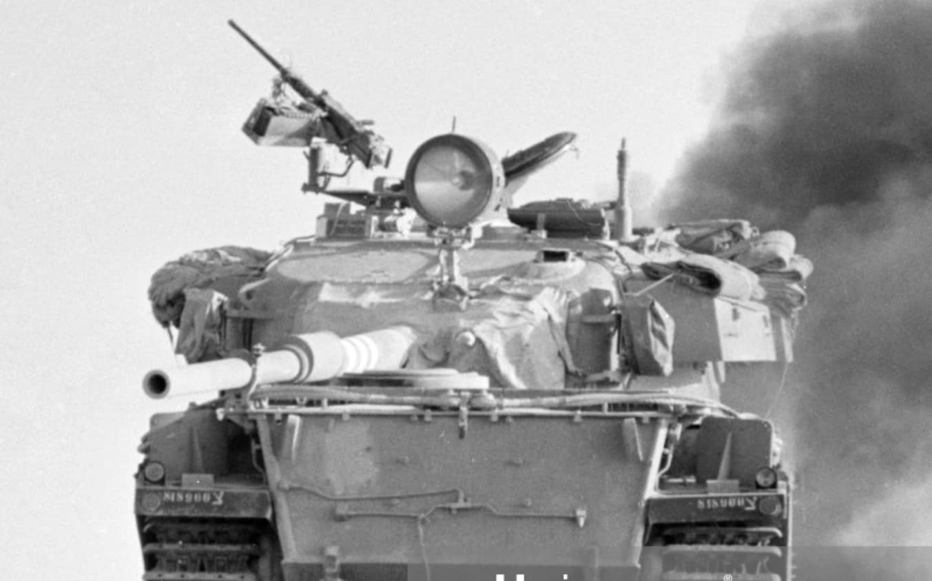

Then there’s this circular type, which actually MIGHT be a Russian ‘Luna-2’ IR searchlight ‘liberated’ from captured equipment and adopted on Shot’s, but I’m not entirely sure about that.

The second one is indeed a Soviet Luna ir searchlight. Got a couple of photos but don’t have access to them as I am at work.

I knew some Shot’s were equipped with it to increase their night fighting capacity and it didn’t look like the other two, so I guessed it was the ‘Luna-2’.

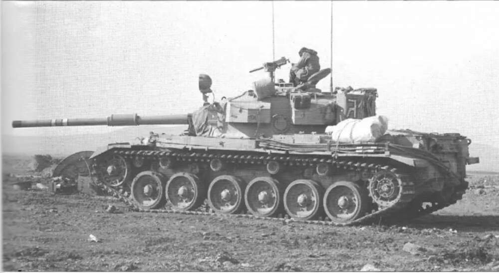

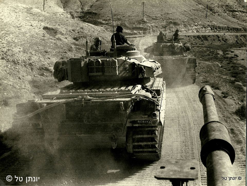

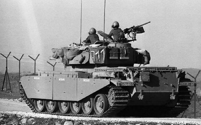

Ugraded Centurion Shot with the searchlight box:

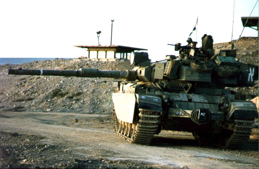

Notice the searchlight mounting plate and the box on the front Vehicle:
Sometimes the markings were painted on the box and sometimes there was the typical canvas square:
