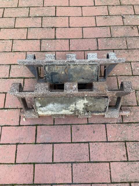

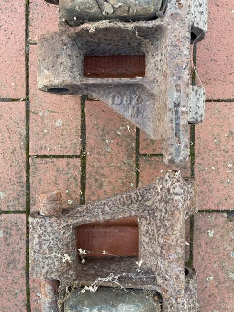

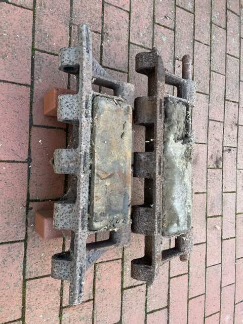

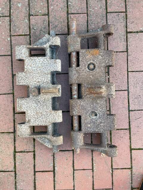

It is frequently asked in forums whether the Chieftain track can be replaced by a Challenger 1 track on a scale model or vice versa. My answer is, it depends on the desired accuracy of a build and the scale. I am not a rivet counter at all, but my simple answer at least for scale 1/35 is: NO. Challenger 1 track is wider (650mm against 600mm of Chieftain), the link is also approx. 10mm longer. So it will not exactly fit on the sprocket. The design of the tracks is very different. I am lucky to have kept a link of each from good old BAOR times where I found these after exercises, so I was able to take some comparing pictures that explain more than words could. On my opinion the Challenger 1 track looks more massive than the Chieftain one, which is not only caused by its wider dimensions. The larger rubber pad and the wings at both ends also cause that massive look. Anyway, judge yourself on base of the supplied pictures…Nice example of a worn track pad though. The pad was not the reason of it being dumped. Where I found it, a lenght of 8-10 (can´t remember) links was replaced due to one being torn in the middle.

Totally forgot about just how much the size difference was. You never really see them side by side that.
Great comparison of both.
