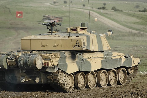

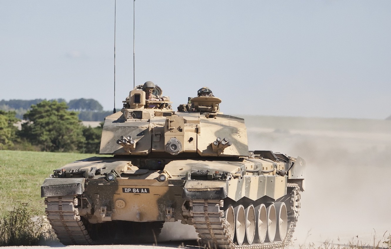

Does Anyone know what is this color scheme for Challenger 2? and where was it used?
Usually UK based OPFOR on Salisbury Plain Training Area (SPTA). It was used at various times on BATUS Cr2 as well. Tamiya XF59 Desert Yellow and a NATO green will be what you are after. Mission Models do the best British sand colour though MMP039 if you can get that.

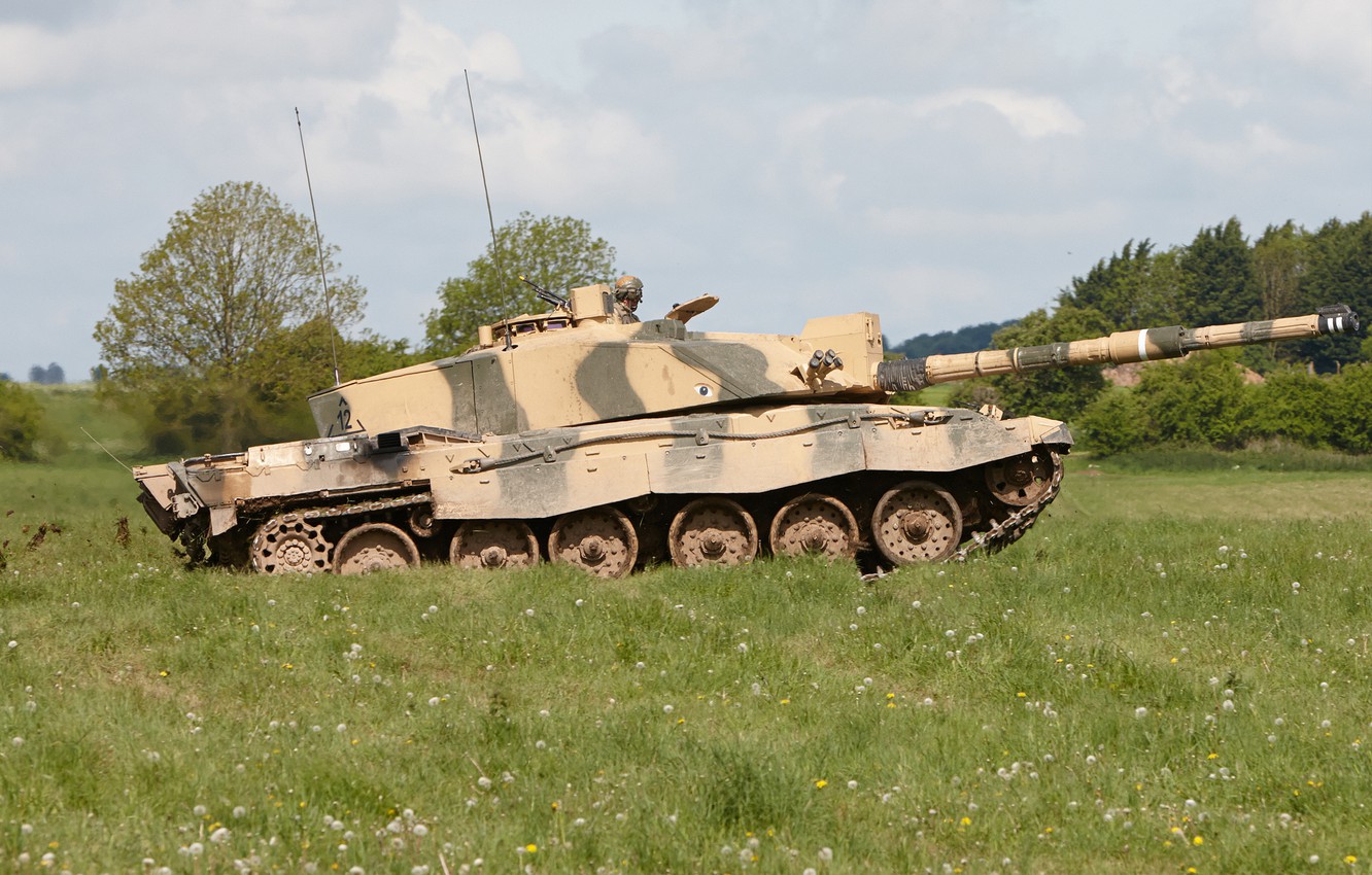

There appear to be those without said equipment as well, since these are from the same unit?

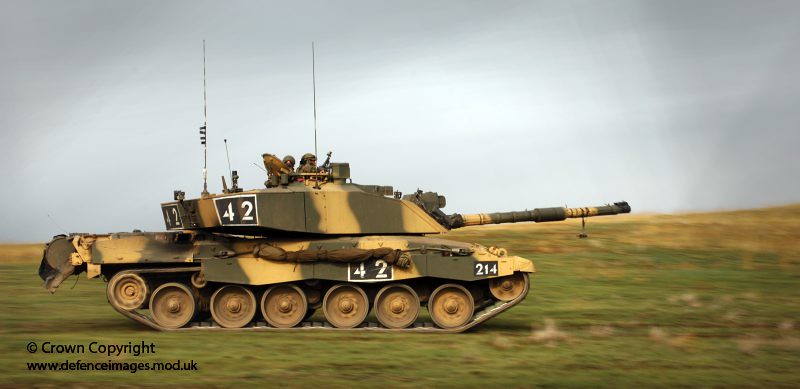

The top image is BATUS, the remainder are UK on Salisbury Plain.
@BattleFront_Models - the TES sensors/cables etc are not really needed to be honest. That kit is (was) only used full time on the vehicles on the BATUS MedMan exercises. UK based units use the kit occasionally, but only on an actual TESEX, all other low level training / exercises are configured as per Rons last 4 images of the RTR Cr2’s, The image you posted for the original question is a non BATUS vehicle, so a UK based one.

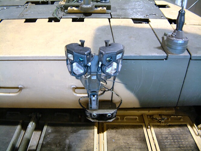

The first photo does have it: you can tell most easily from the sensor hanging under the gun barrel. You can also see them on the turret roof.

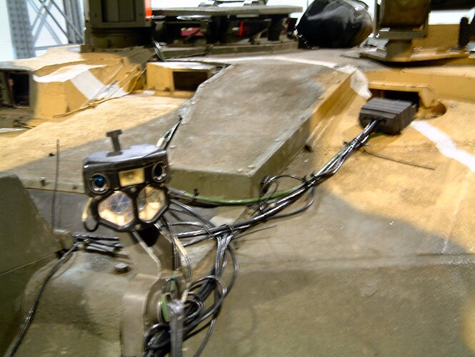

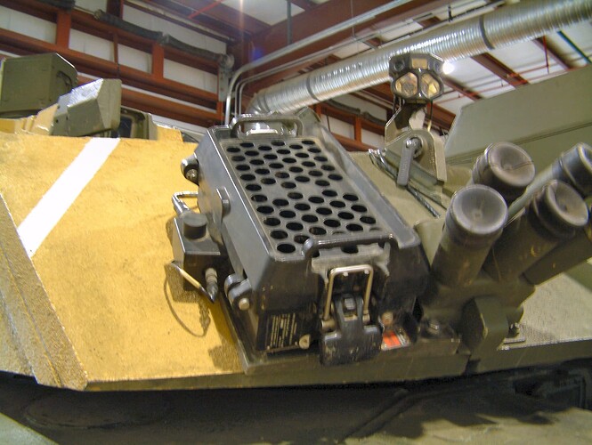

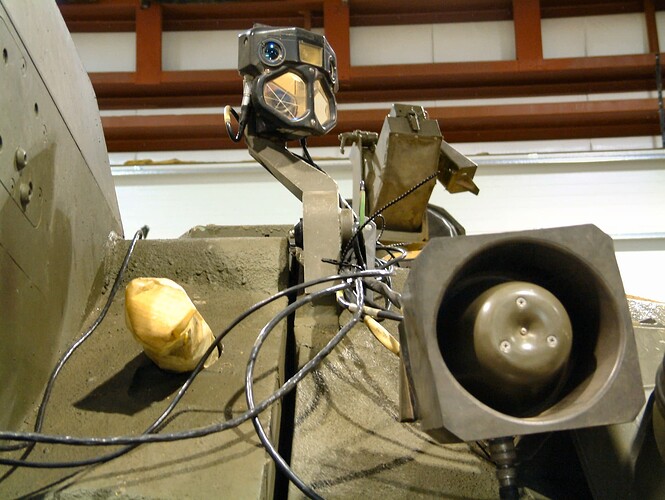

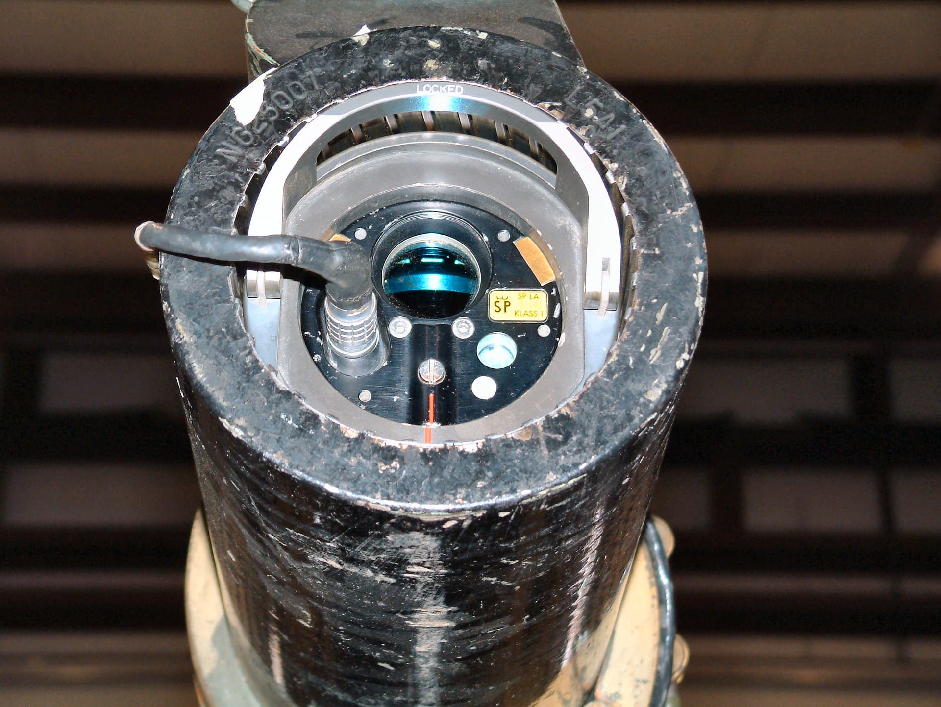

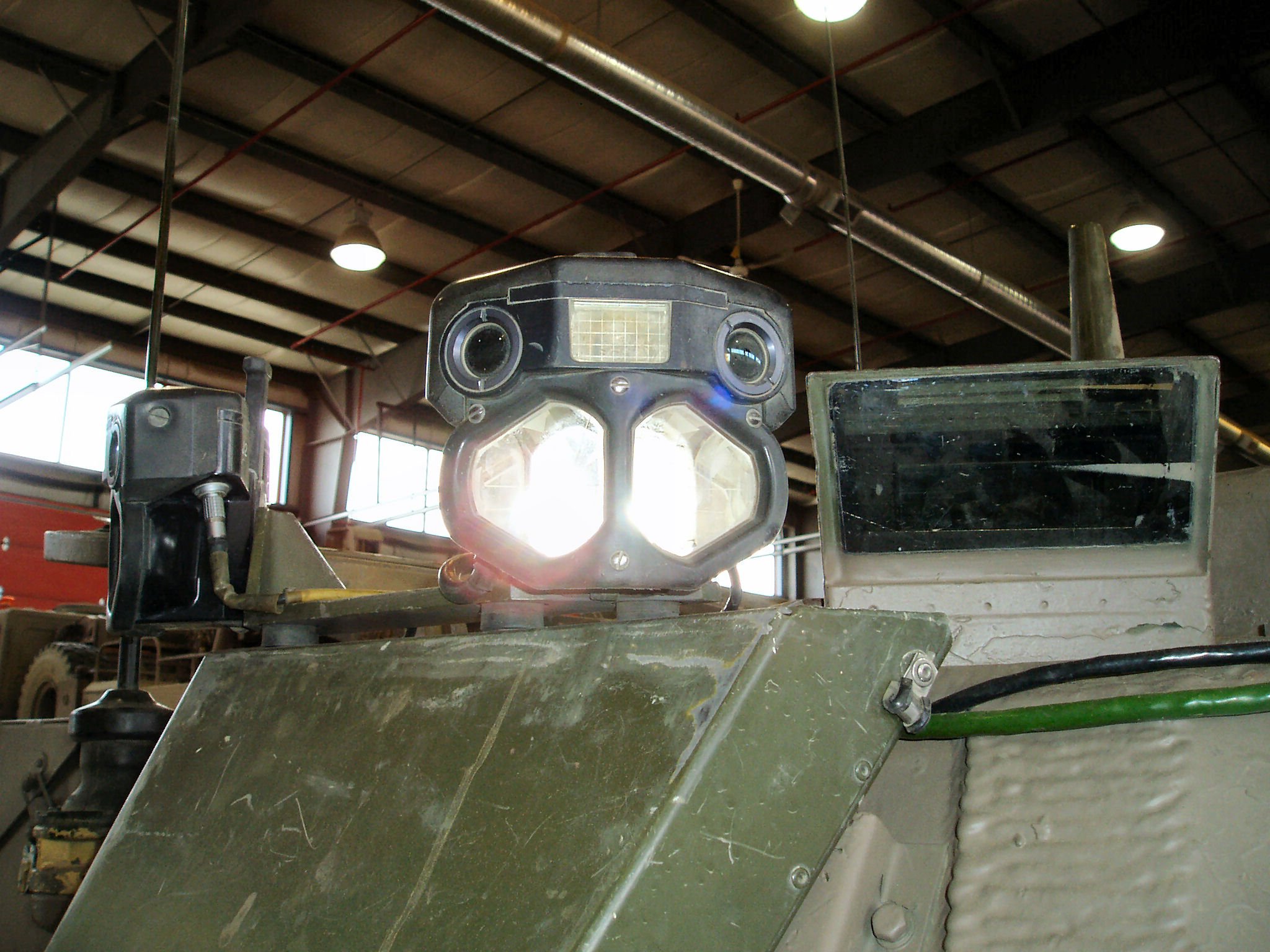

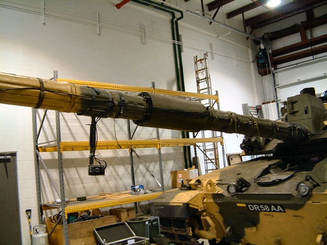

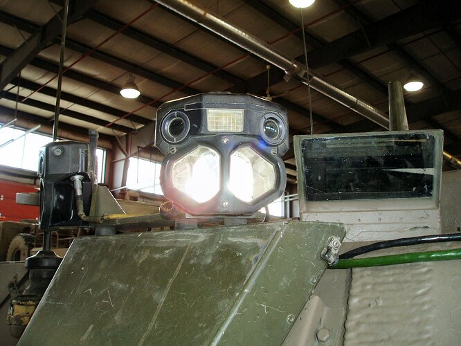

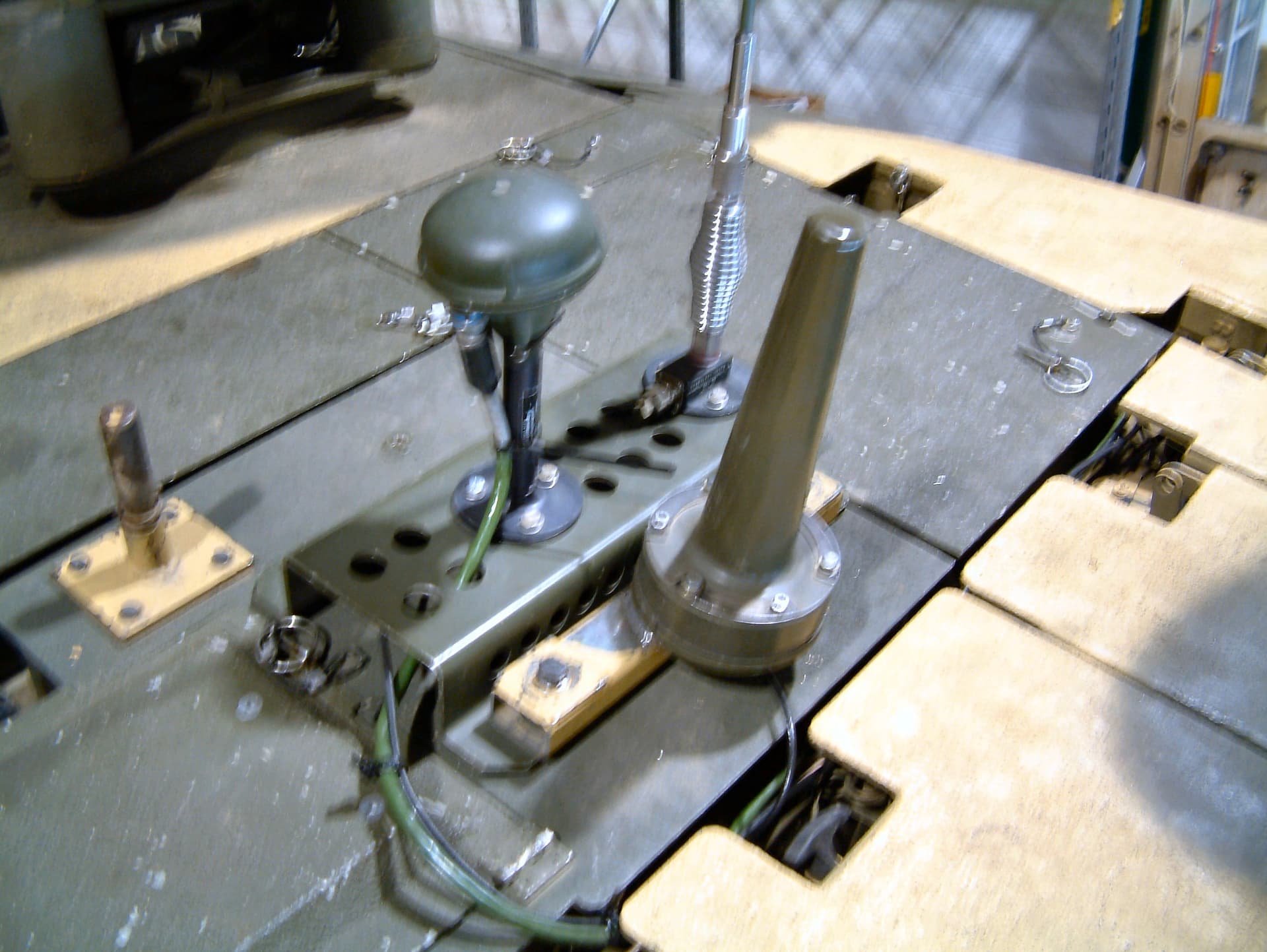

@BattleFront_Models Having just browsed through the photos on my computer, here’s what I have (none of these are my own pictures — I found them online about fifteen to twenty years ago). The last one isn’t Challenger 2, but shows the sensors well.
Just for ref, the above Cr2 is a BATUS one in the TES fitting hanger up at Crowfoot

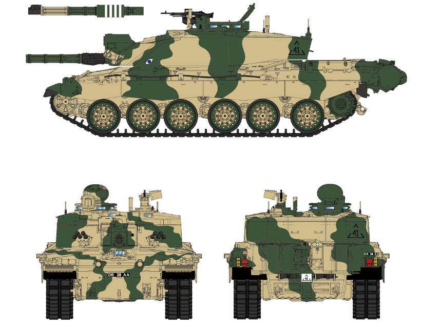

is perfect for out the box and paint scheme you posted in the original question is from the instruction sheet.
