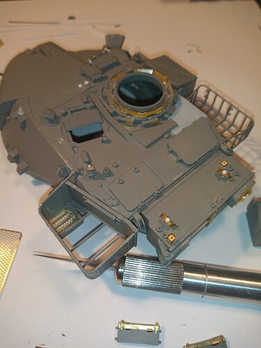

TOGs barbettes are built up.
Nice and straightforward … carved away a few areas for PE replacement parts which were better detailed and added some white plastic cut to shape.
Rear barbette. Added the lifting lug to the top and the white strips as the 1 to 1 has a slight lip in those areas. Still need to add the fan mesh screen to the rear.
Front section. Again, another lifting lug and added a white plastic square to the front of the access cover and drilled a padlock hole in it. The part behind was drilled through for the spring loaded securing pin shaft to sit in. The handle would flip over the blocks and then you could secure the cover and padlock it shut …
You can just about see the padlock hole… Drilled out with .3mm bit.
And both dry fitted.
Still needs the armoured plate fitting that sits between the barbettes and the turret roof edge… Will use the PE part for that and get it all mounted tomorrow night.

TOGs barbettes are now secured on, and PE in place, and the inner side basket PE is fitted.
Added MENG washers and nuts but they looked a bit to big, so cut off the nut head and they look ok now.
Top view of turret.
And basket mesh.
Still need to fix in one grenade box to the RH basket.
Will try and get the cupola finished tomorrow.
