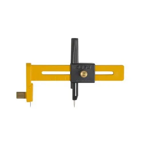

Dspiae circular cutter was the worst, useless tool purchase for me ever.
I have the drafting circle templates, used rarely as i prefer to use masks.
I have the yellow/black thing, not used as it doesn’t cut true circles in the smaller 1/48th & 1/35th truck wheel sizes i need.
I also have the Dispae, which does cut true [repeatable by 20 times ] circles, ONCE you have got used to use it properly (key is to use the height adjust for materiels used) BUT it is so fiddly to get the correct size in the first place, as the measure guide on it doesn’t relate to diameter or circumference

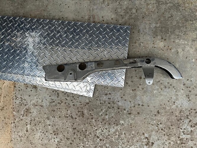

As for as punches circles, If there’s one thing I do well, it’s punching circles. I have Micro Mark sets, a few intermediate sizes from Harbor Freight, and some large two piece punches that’ll make perfect circles in sheet metal. I think my largest one is over 1 1/2 inches, but I’m not going to dit it out. Good for knocking out holes in your hood for hood pins, or dfferent motorcycle apllications like this:
No drifting drill bits, marring of chrome…
