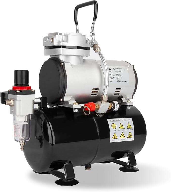

So, long story short, decided to swap my terrible leaking compressor with a normal one. After some research and seeing people recommending an oil-less compressor with a tank, with some recommendations for the Timbertech AS186, I got it.

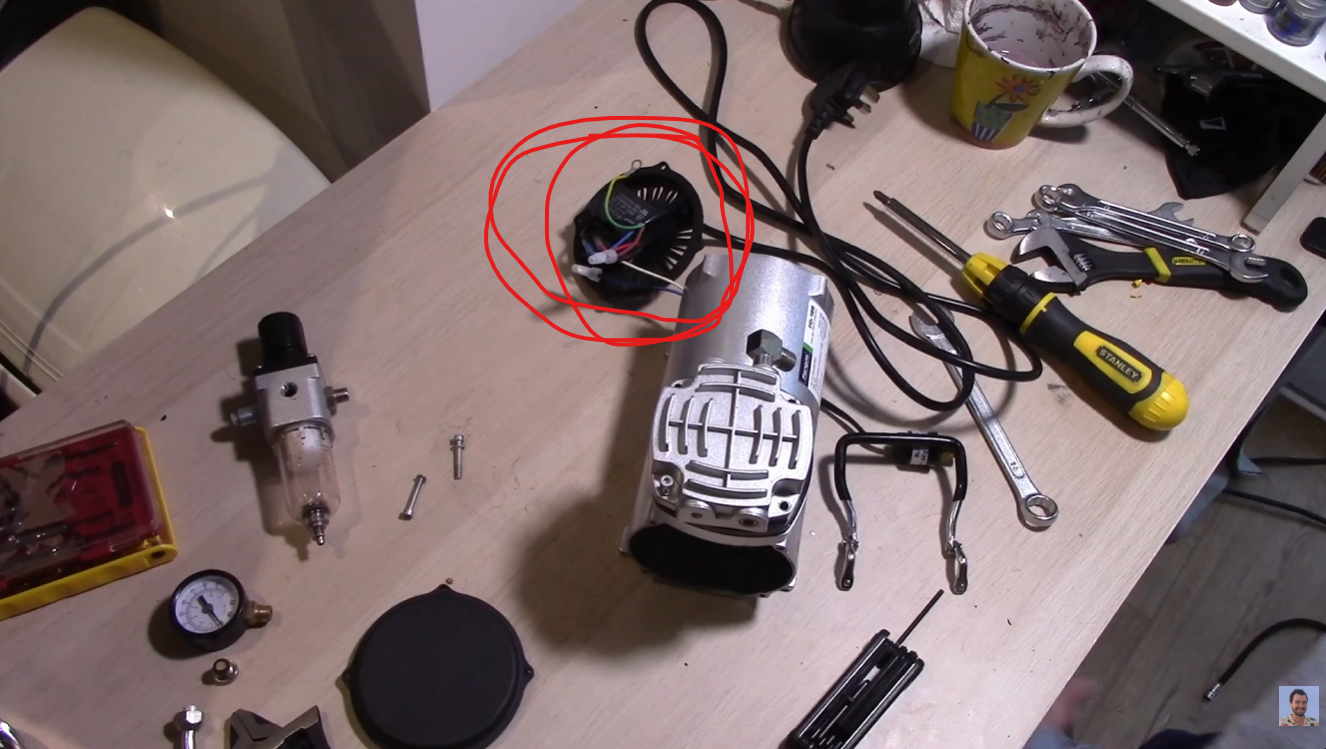

It arrived, and immediately burnt out upon turning it on for the first time.
Turns out I didn’t do my homework.
It operates in the American 120~ volt range, whilst where I live we use 240~
So, that probably burnt it out
I returned it and got refunded, but, after looking it up some more online, people are saying that it’s a bad cheap mass produced product anyway?
Basically, what I want to ask, should I just get another one, this time with a 240v to 120v adapter, or should I get a completely different compressor? Something more highly recommended by veterans and experts of scale modelling hobbyists?

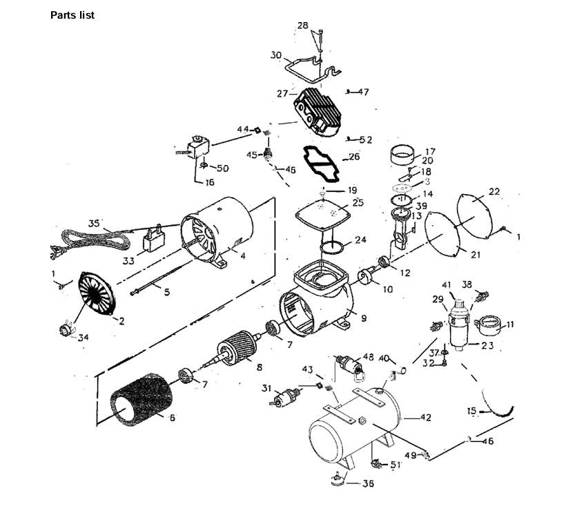

If you find some locally sourced comressors we can help you choose. Also you can check the AS186, it has probably blown the condenser (pn33) it has.

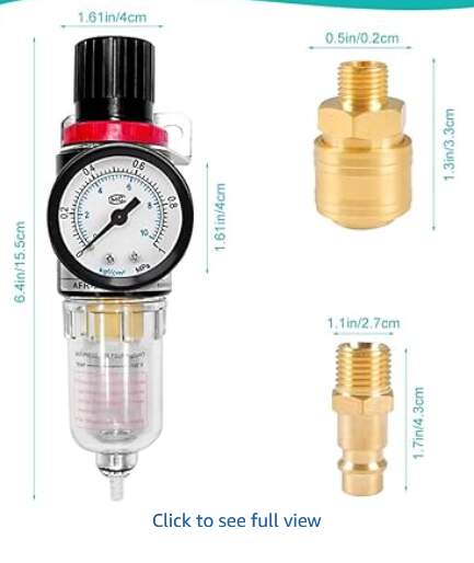

You should be looking for a compressor with a tank,
an air pressure ccontrolled on/off switch, an air pressure
regulator (actually a reducer) and prefereably also an
oil&water trap (catches liquid from the compressed air) .
The pressure reducer is often built as a combined unit with
the oil/water filter. Many different types but they look something
like this:
There are also units that contain an oil cup to add oil to the air to
provide lubrication for air tools. You do NOT want that type.
I use a Flowze compressor which is exactly the same as a Timbertech but being in the UK it is a 240v model. It’s lasted 10 or so years without an issue. I realise you get what you pay for, however it has more than met my needs.

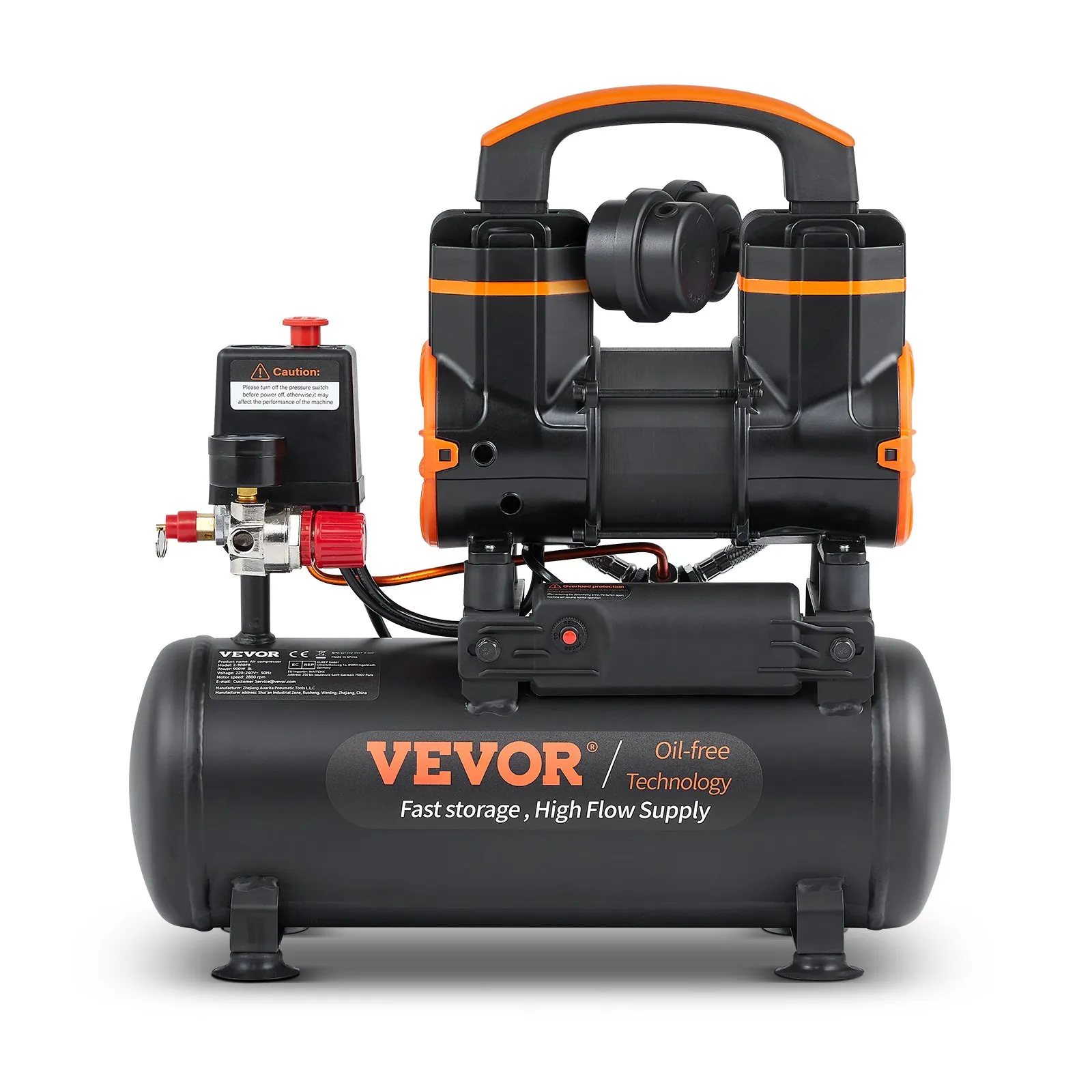

If noise and space are not a problem, the easiest way is to get a compressor from a hardware store, not only you can use it for the airbrush but you can also inflate tires, use pneumatic tools, etc. and the cost is similar to a many modelling compressors.
If you still prefer an specific one, here you have several models:

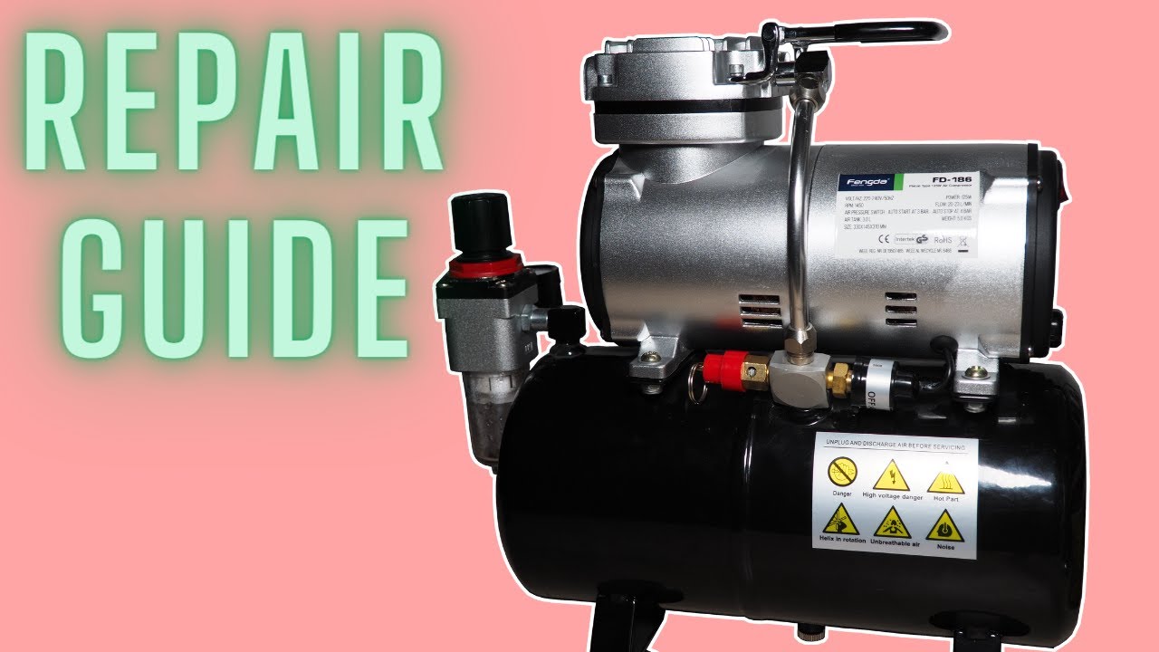

Or this one from Gaahleri:
