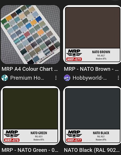

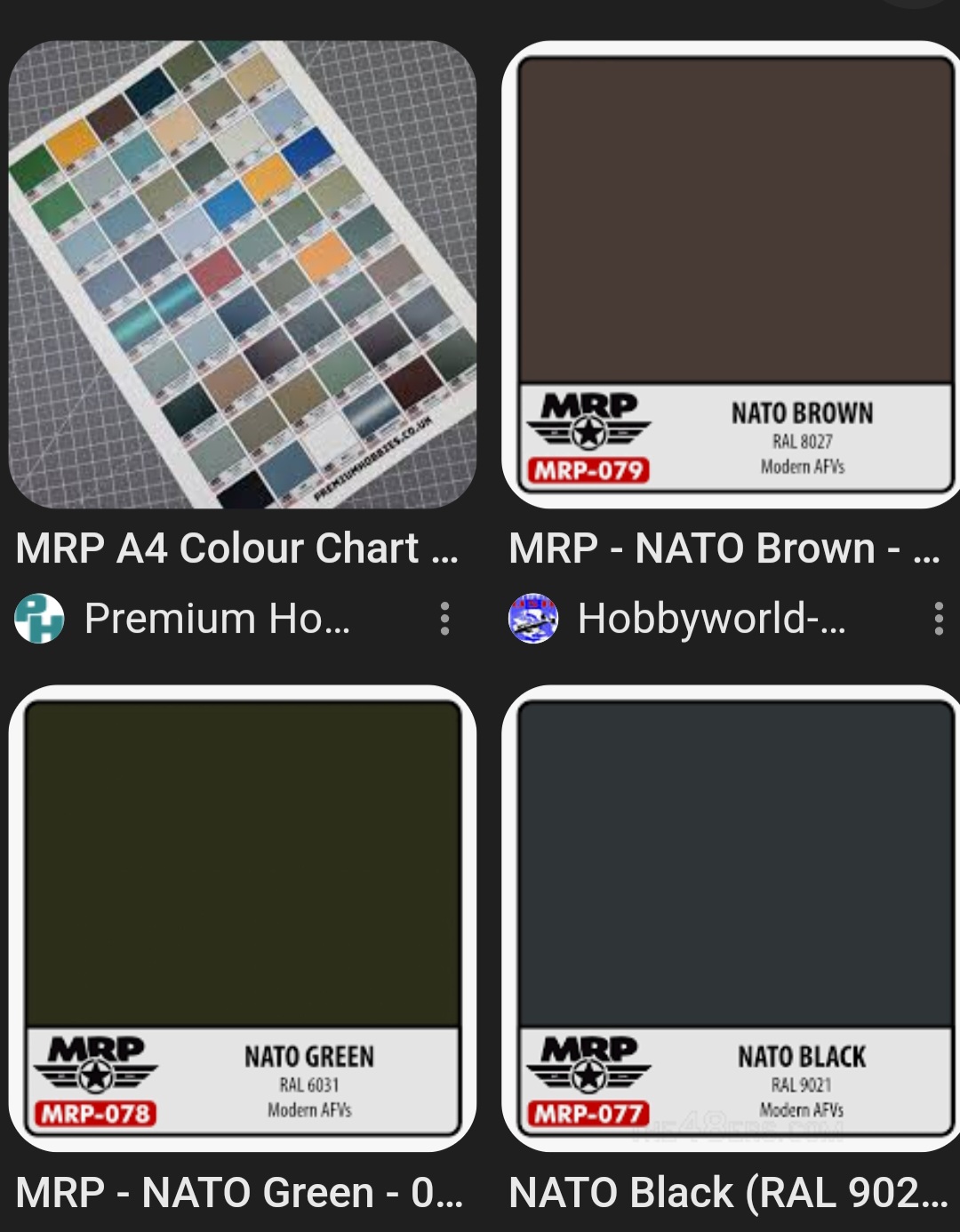

  1. MRP Mr Paint for NATO Tri-Color.
It’s thinned perfectly for airbrushing right out of the bottle.
The red brown & green are close enough to certain German WW2 AFV colors to “pass”. Likewise, the black can pass as Panzer Gray/Dunkelgrau RAL 7021 if the base coat color is light and then thin light coats of NATO black are applied. The colors obviously aren’t exact WW2 RAL matches…but with weathering etc are pretty close in my experience.
  1. Tamiya for NATO TriColor acrylic/acrylic laquers are fantastic too. Excellent with X20A acrylic thinner but outstanding with Tamiya Lacquer thinner in my opinion.
I give MRP the nod because it’s ready to rock & roll straight out of the bottle and will do what I want. Tamiya can be sprayed out of the bottle but in my view needs a fair amount of thinner to spray similar.

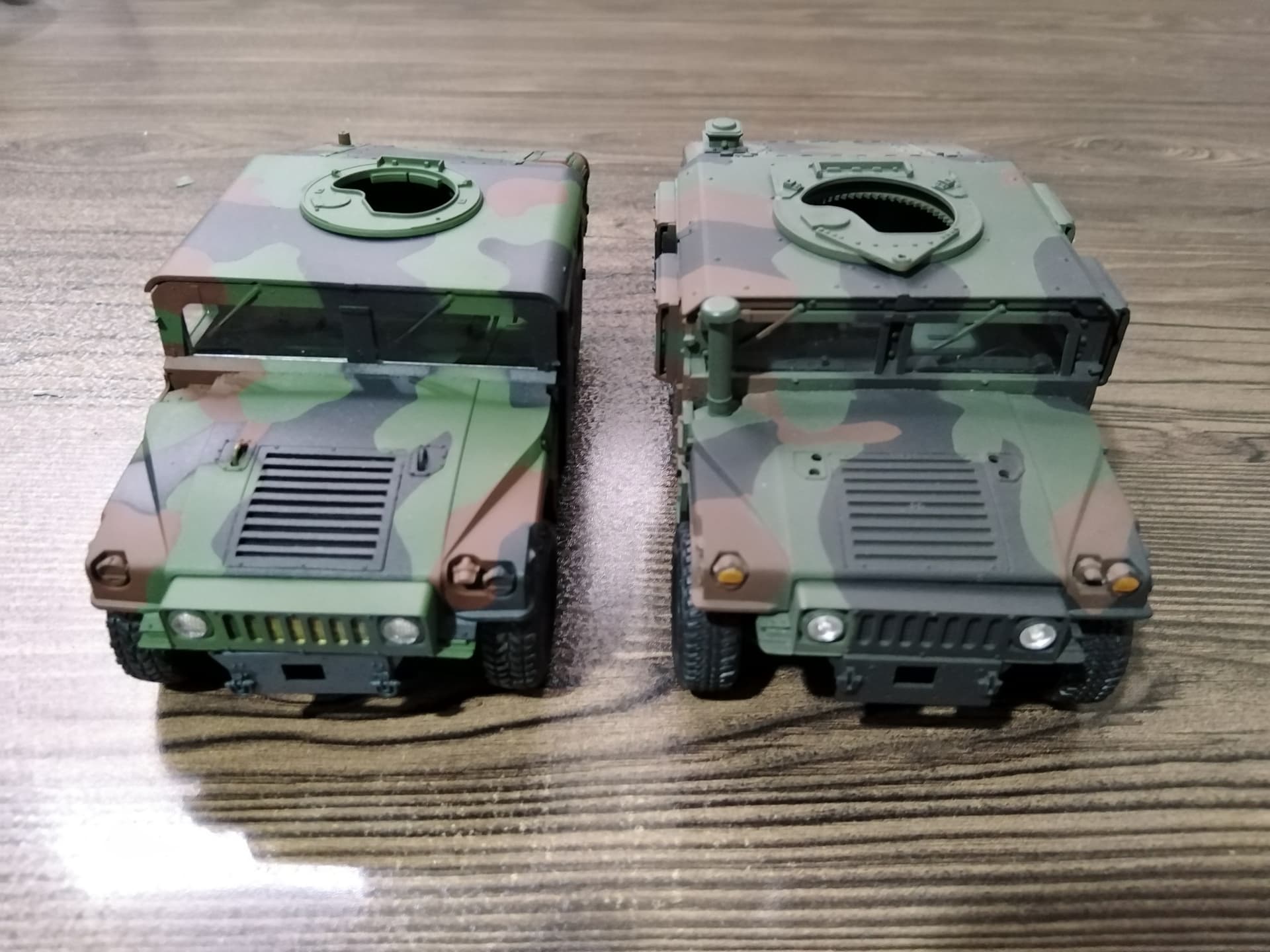

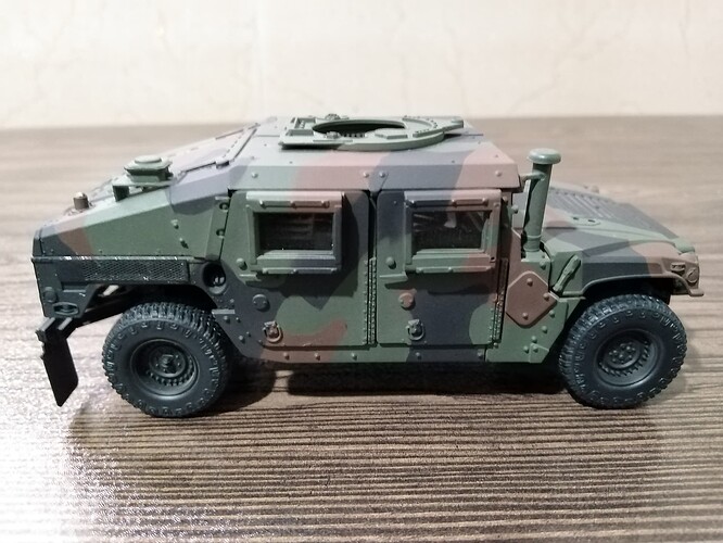

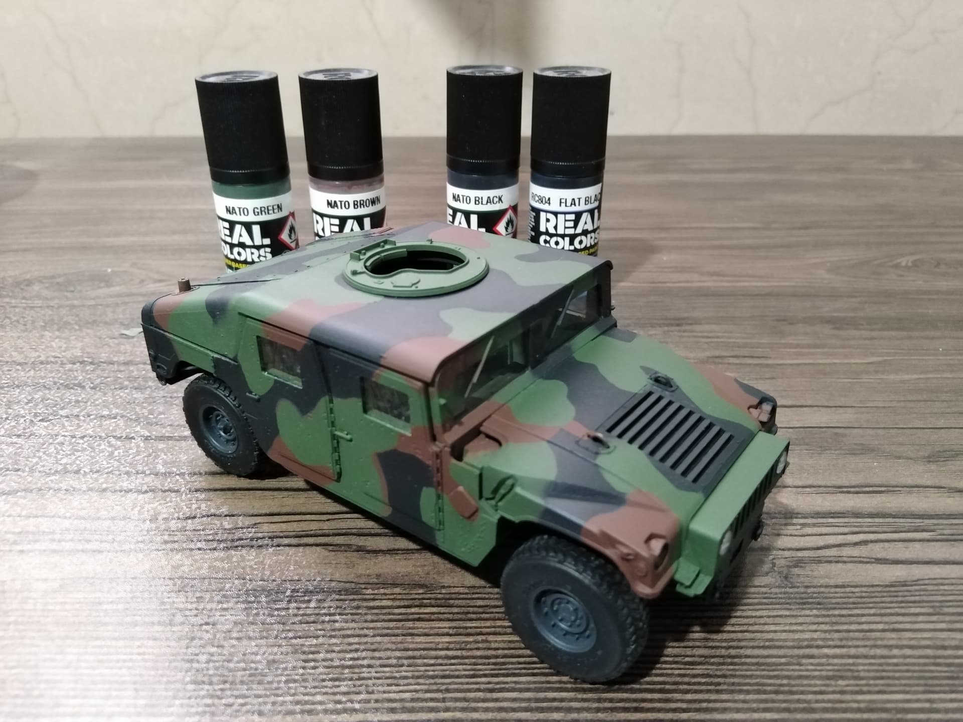

I’ve always Trusted Tamiya Paints

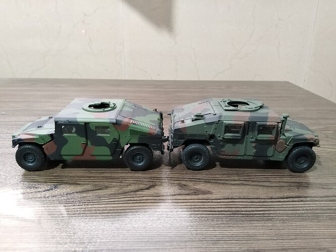

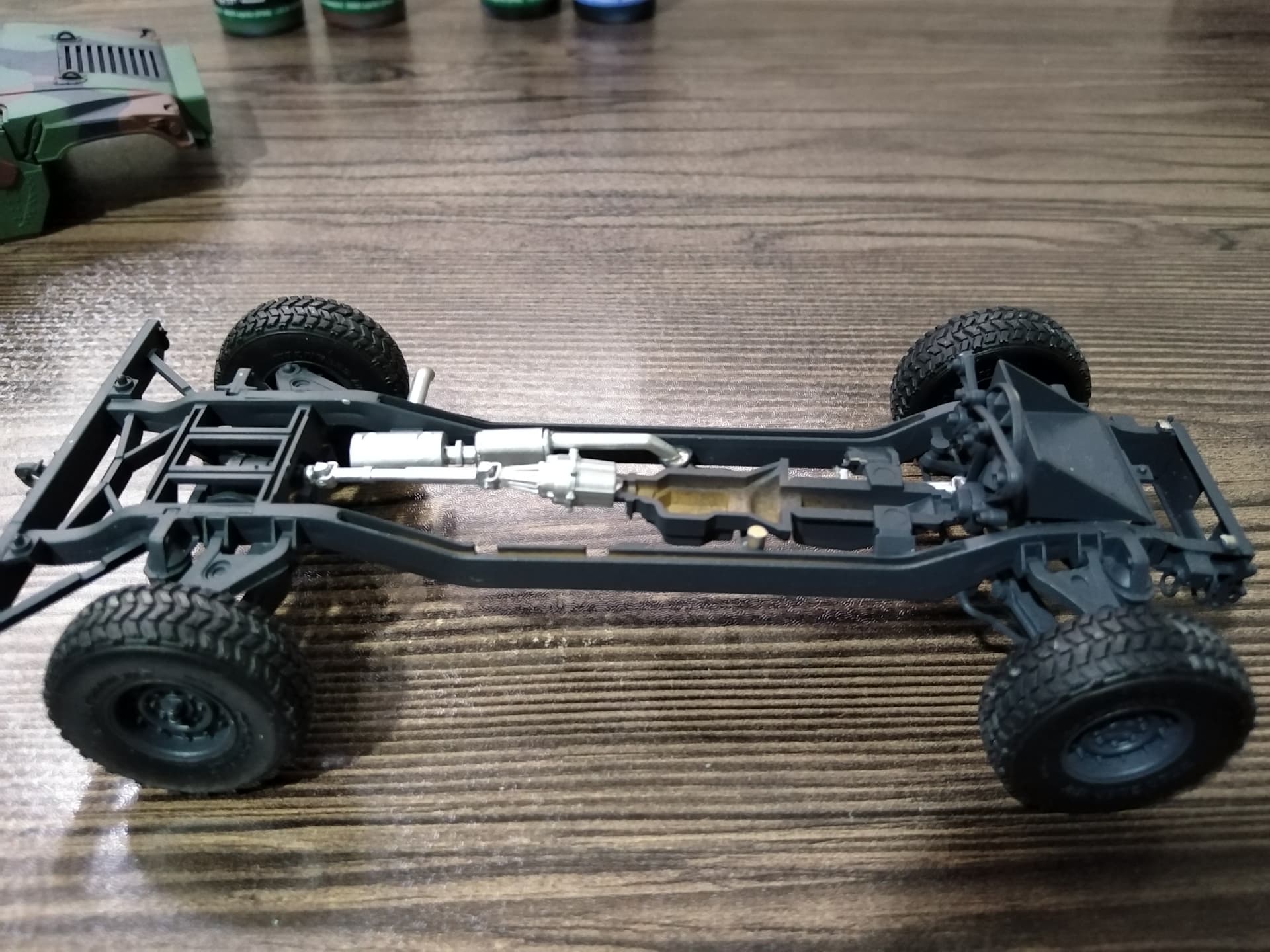

They are not Real !!!
I tested them on paper first & they looked good but when I applied them on the model, they were terrible!
Here is my Bronco M1114 painted by AK Real Colors & my Academy M1151 painted in Revell Colors,
They are too bright, the NATO black was more greyish blue than black so I had to add flat black to it
But you can see on the chassis & wheels how incorrect the paint is!

I dont personally think you can say they are wrong or incorrect. They simply offer a different tone and finish. AK RC range give a more new/fresher paint scheme that look like the vehicle has just come off the factory floor.

The shade is too bright for what it should be!
It’s not even good for fresh factory painted!
Not even good for French!
Not all AK Real Colors are wrong in shade but NATO colors are wrong
