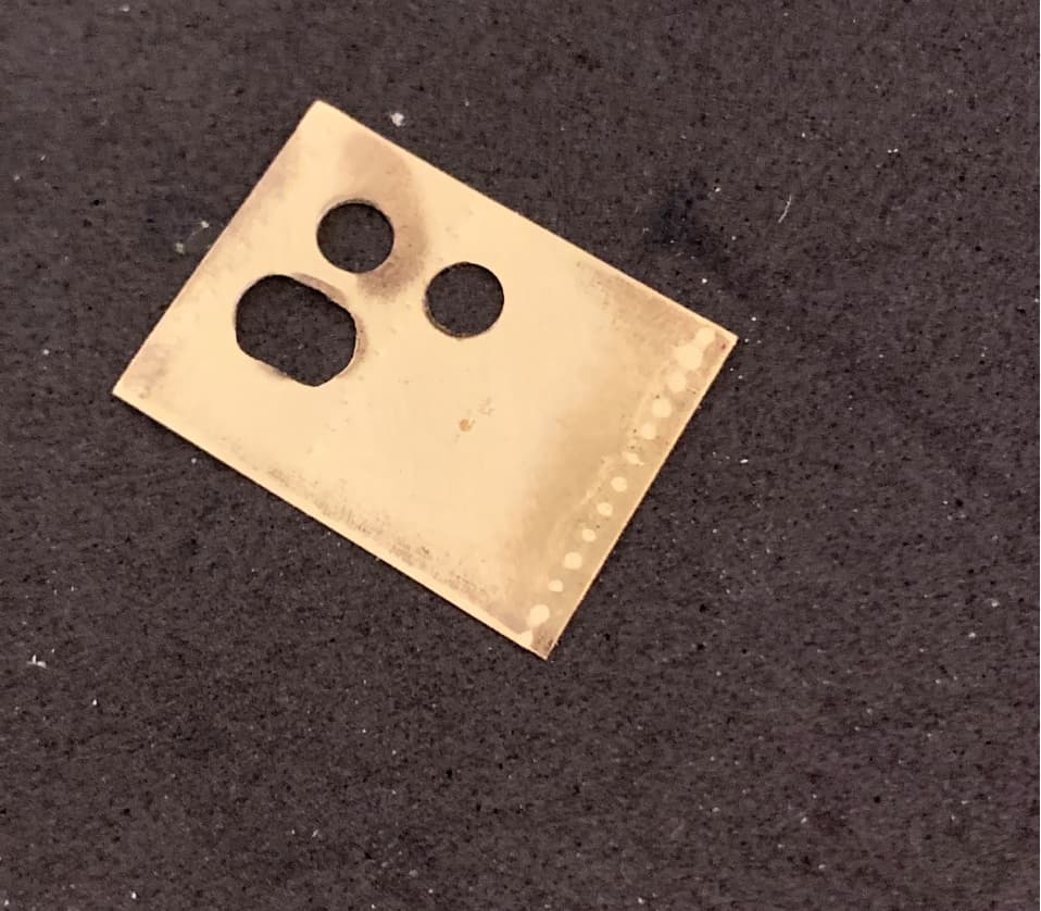

I use kitchen shears most of the time. I use an older worn #11 blade for scribing the fold lines. I’ve posted a few different times on here how I do it, with photos.
You can also use various punch sets to get disc shapes, or to punch circles into your pieces.
That looks good!
