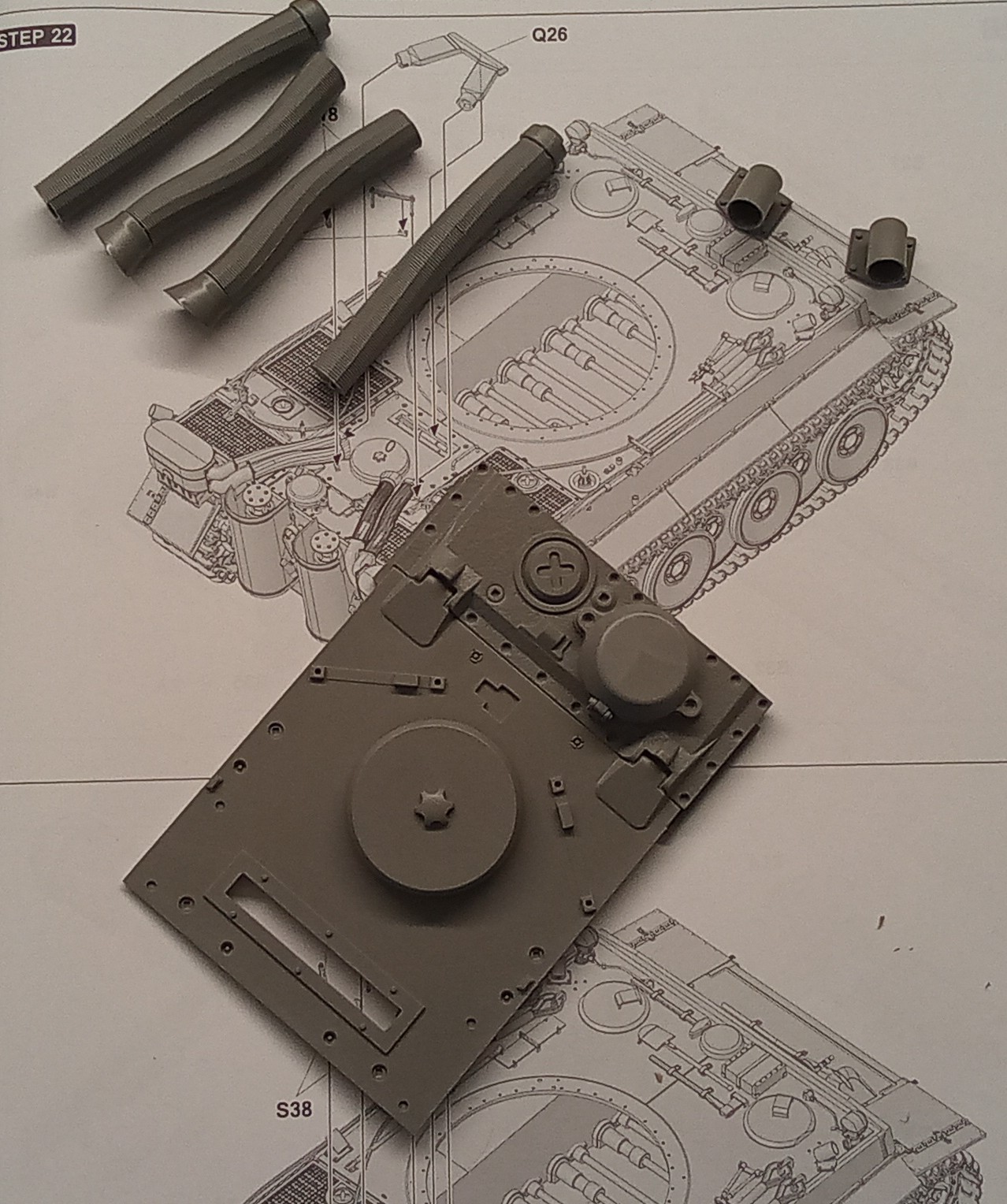

Am I missing something here, step 14 calls for three smoke pots, R8+S50+S63, and step 20 calls for two, same combo… But there are only four R8 provided for five pots? What am I missing here? And, there is no smoke pot right mid hull, is there any science behind that? It’s keeping me awake at night…
Well, first of all, those are not smoke pots.
They are S-mine launchers.
Secondly, this is a mistake in the instructions, not on the sprues.
The two launchers at the rear corners of the vehicle, are supported by arms, and the kit provides two appropriate bases for them, with the arms molded in. They’re not on the R sprue - they are on the Q sprue.
There is no mine launcher at mid right because the mine would destroy the antenna.

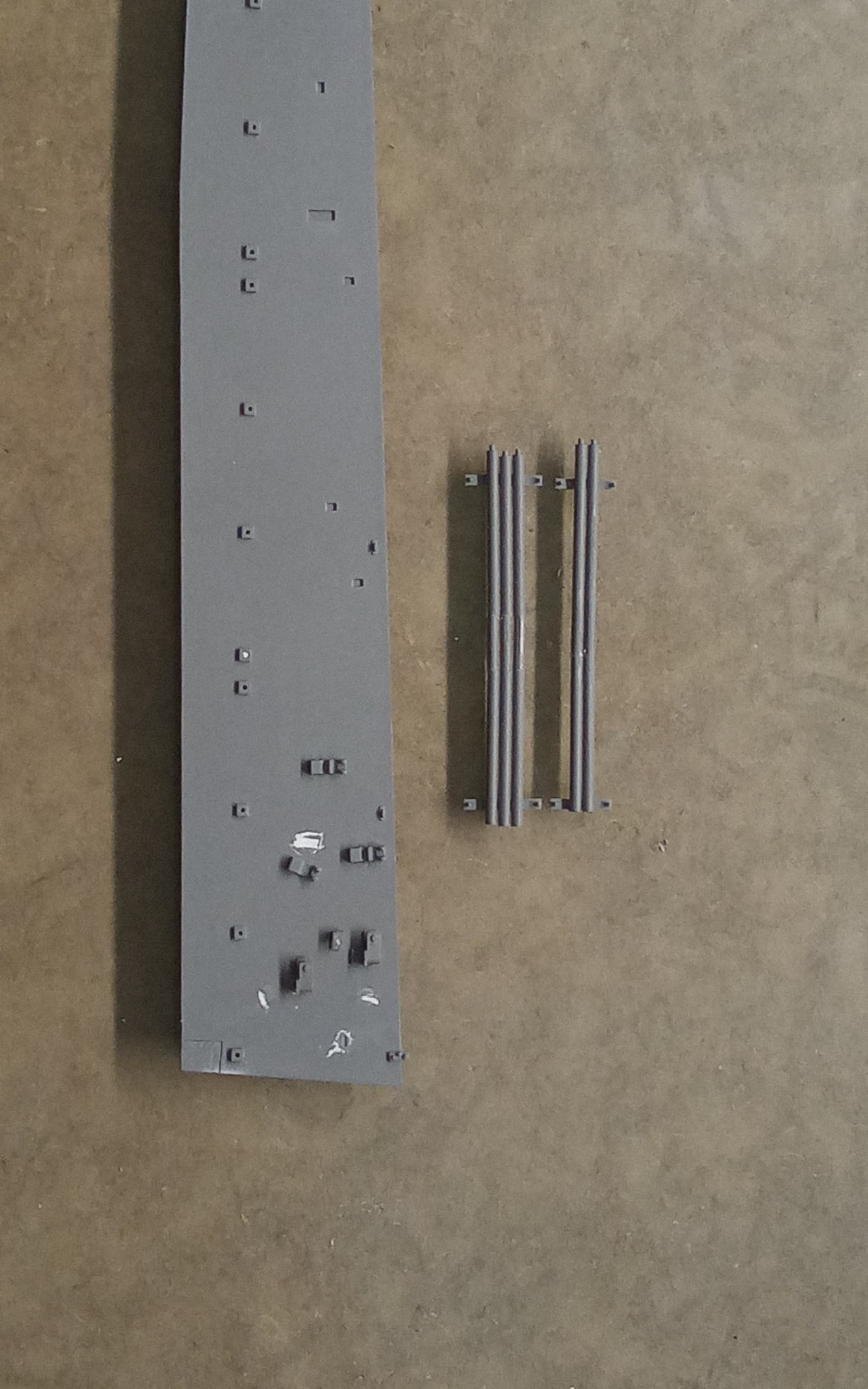

A couple of the identifying features of S21 are the steel rope layout, left hull, and the barrel cleaning rods, hull top, split three to the left, two to the right. Thanks to David, I’ve recreated both, as seen below. Yes, they’re rough, they need some cleanup which I will be working on today.

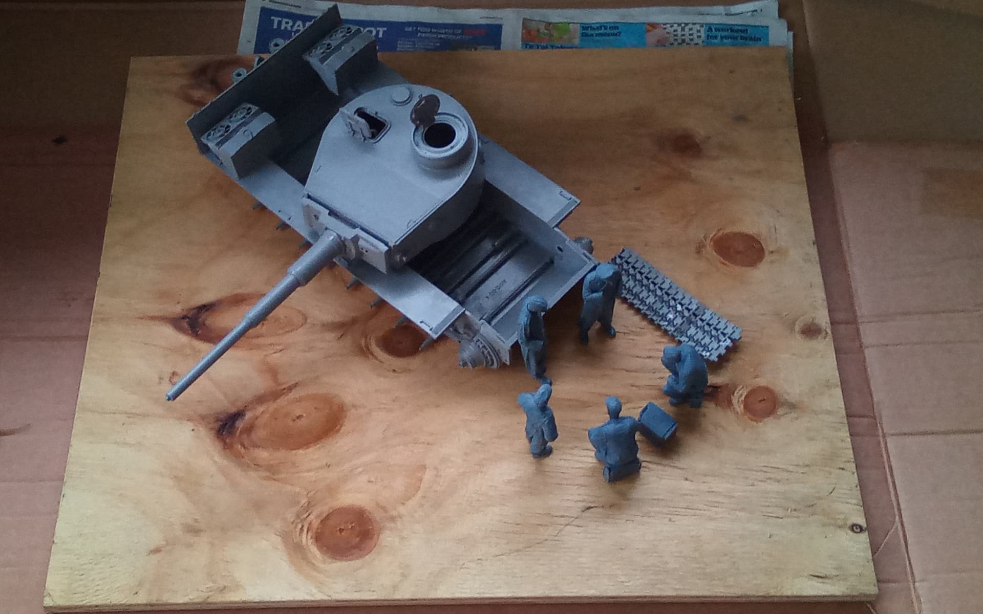

Also, a layout of where this is going, I’m thinking a track pin has broken and the guys are taking a break for mail whilst repairing it, with tools scattered about. I’m thinking one half of the base a bare earth road, with grass in the corner under the barrel. Basic, but more likely to get done, and done well, rather than trying to pull off some masterpiece that will take forever, only to have it looking like last night’s McDonald’s cheeseburger that fell down the back of the couch when I was yelling at the ref on the tv, who never listens.
Other identifying features are the original wide rommelkist, which I need to work on, and the starter crank on the classis front.
Something like this for the groundwork

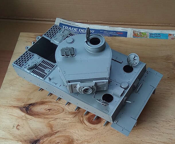

Progress, albeit incremental. Will have to start throwing paint soon…

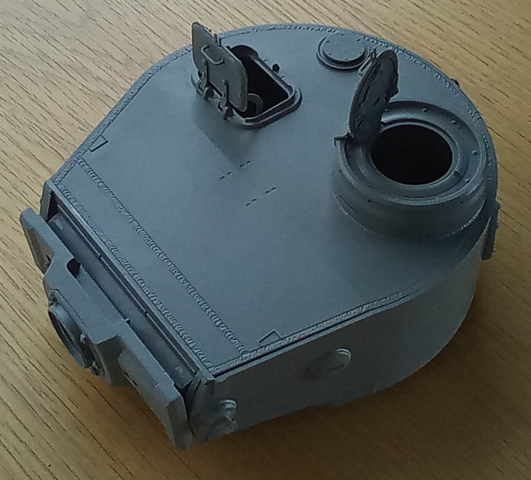

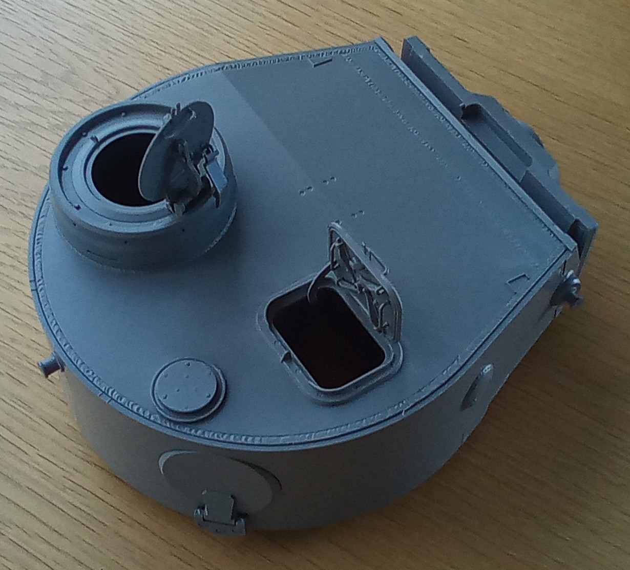

I hope that cupola’s not glued on, because it’s at the wrong angle. It’s not a rotating cupola. One slot must face exactly forward.
David
Hola David,
Cupola is resting in situ while I continue work on the hull, it’ll be fixed in place with a visor facing forward, hopefully some time this week.

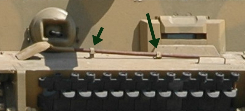

Right, I’ve this ready to prime, all the sub-assemblies are there, a quick question, the starter crank on the front is held in place by one clamp, is that correct? No brackets at the ends? Ive googled this looking for a clear image, tiger1.info being the start, but am still wondering.
Thank you,
DR’s Tigers had two clamps on the glacis plate, a standard feature of 1943 Tigers. They were intended for a large shovel.
It’s not clear whether DR were issued with any of these shovels, but certainly they didn’t carry shovels around. They put the starter handle shaft here.
David
