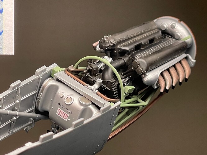

Without going too far, my 2 engines presented here are an emblematic case. What will you see after they are housed in their nacelles on the wings? Nothing, or almost nothing…
And despite this, how much time did I waste to make them that way?

Ok, let’s say that the engines are definitely a complex part of the kit. My hope is that the final look can be as close to the real thing as possible. They were finally mounted on their mounts and each inside their respective nacelles.
The nacelles themselves were painted on the exterior with Tamiya XF-83 over a light pre-shade, just to not look like they just came off the assembly line The entire interior is Tamiya AS-12 as per the instructions.
I don’t like spraying directly from the rattle can at all, so I previously collected some of this paint from it in an empty jar. After a few hours to let the paint lose the propellant from the rattle can, I simply sprayed it from my airbrush diluted 1:1 with Mr. Leveling Thinner.

Looking good. Btw, are the engine cowling covers designed to come off as Tamiya did in P-51 and Spitfire? I remember seeing guys detailed the engine in those fighter planes and they were able to take the covers off if they so desired. It would be shame to hid those engines.
Well Mike, looking at the instructions that follow the answer is: YES, WE CAN! (
mmmm. this expression reminds me of something…).
Jokes aside, small magnets are provided to glue inside the cowlings that allow you to attach them or not, hiding or showing those engines!
After the time and effort needed to bring them to life, I also think it’s a shame to hide them forever.
Bye
Dan
I also mounted one of the supplied magnets inside each engine heads, which will work with the ones I will mount on the cowlings.

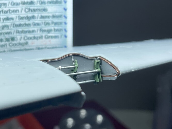

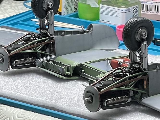

Today’s updates are about the wing root, its connection to each wing half, followed by the main landing gear and its connection to the engine nacelles, and finally the connection of the nacelles to the wings.
The whole thing has become quite heavy and quite large, also creating some difficulties for me in photographing. By the way, the effect is impressive. Everything fits perfectly, the details are stunning, there is really no need for aftermarket in my eyes. I think I have no particular merits, you just have to follow the instructions to bring out a beauty, just a good painting.

I attach some photos of the various steps, up to the current construction phase.

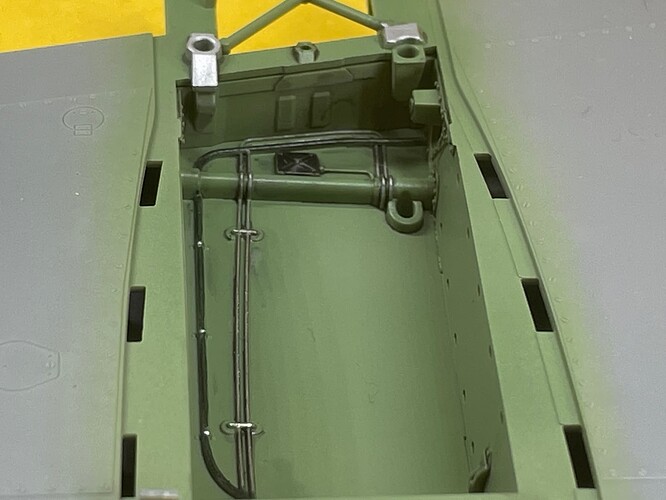

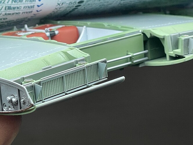

Hi,
as anticipated in my last work progress were missing the main landing gear retraction arms, brake lines, and radiator pipes to complete the landing gears, nacelles, and engines detailing.
So here are the missing parts

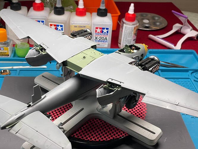

Now a general view of the construction site.
[/grid]
Oops…something went wrong during assembly? Maybe there were a Mosquito version sporting a high mounted wing?
Oh yes, I’ve got it now.
