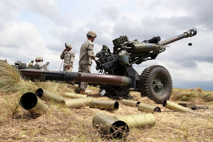

Due to its design, the M119 can be fired while still attached to its prime mover. Nothing says shoot and scoot more than that.
The Brits send a whole bunch of them (L118s) to Ukraine, where the Ukrainians are putting it to work.

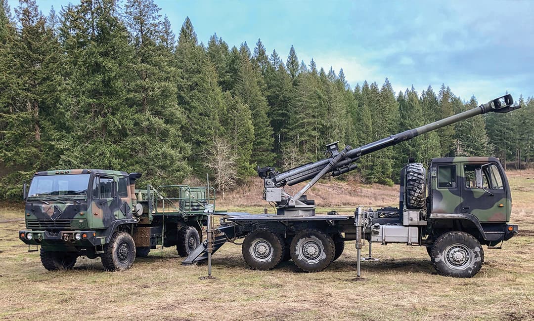

Technically, the U.S. Army has been working to mobilize the 155mm M777 with the wheeled SPHs or mounting a simplified M777 on the AM General “Brutus.”
However, some people said it’s not really the M777, but takes components from the M777 and strips it. So it’s not as if the U.S. Army can plunk an original M777 on a FMTV and say it’s “good to go.”
“Brutus” was tested and fired by the U.S. Army and then the budget crunches and Continuing Resolutions affected plans. The U.S. Army’s wheeled SPH Competition happened and then faded from media attention with no clear winner announced or made public.
https://www.amgeneral.com/what-we-do/vehicles-chassis/brutus-155mm-mhs/
An USMC CH-53K “King Stallion” can max lift 36,000 lbs. “Brutus” weighs in at 29.620 lbs. BUT, the CH-53K can lift 27,000 lbs and fly 110 nautical miles (203 km/126 mi). So perhaps CH-53K can fly closer to 100 miles with “Brutus.” But you need to haul the ammo for “Brutus” though too…
