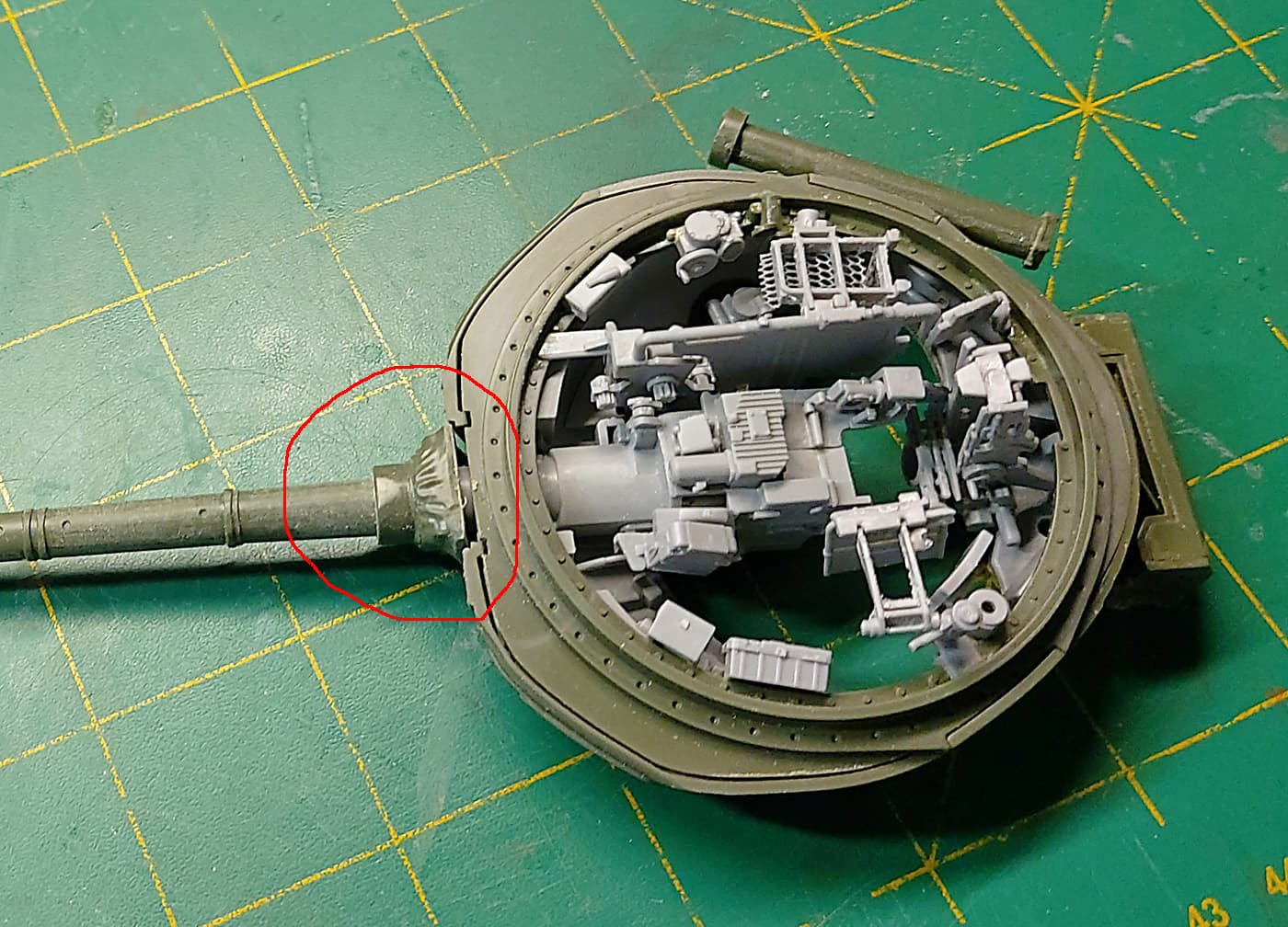

A question for the experts. - The kit has a odd shaped piece on the top of the turret. See image and the red line. Is this Amusing Hobby’s doing or has the T-72 got such a shape on top. And if so is it welded on or removable? I’m trying to figure out if it would lift out with an explosion.

That piece is Amusing Hobby addition so the turret can be easily built/viewed. On some real tanks there is a welded panel in that area, and Amusing Hobby does follow the weld lines. Look at the outside of part E35. All the photos I have seen show an intact turret blown off, no hole in it. So it should be glued in place, but what you do is up to you. You could always leave it off and say it was a bad weld job!

This is a T-64 turret (look at the smoke dischargers) but I guess the T-72 has the same top plate welded to the main body.
Olivier
Regardless of which type of tank it came off it gives me license to flip the lid!!

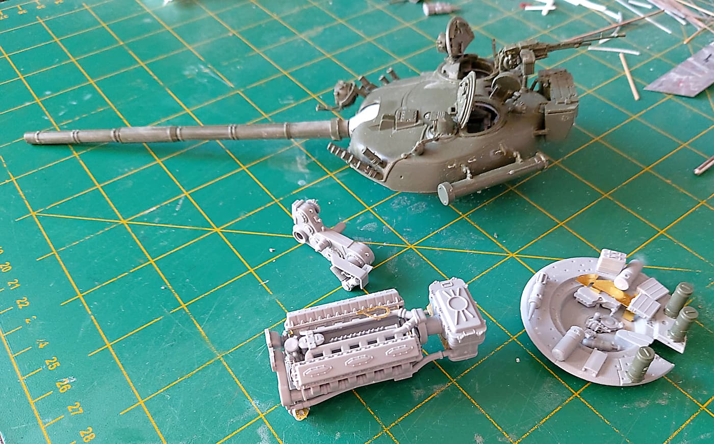

Building in sub assemblies. The turret comes to pieces. I was going to paint the turret as a test. But then worried about getting the rest of the tank to colour match.
Parts locations are often very vague in this kit. But seeing it will be ‘blown up’ then I’m not being too fussy.
The three green items on the turret floor, in the lower right of the photo, are propellent charges for the main gun ammo. If the tank has blown up/burned, they would no longer exist. You should remove them.
Ken
Thanks Ken. I know! My logic says to build everything then start removing what would go bang. And thus destroy what is nearby. Im trying to figure out if i should break or melt parts. Bit of both i guess. The pronect is very much a suck it as see one.
