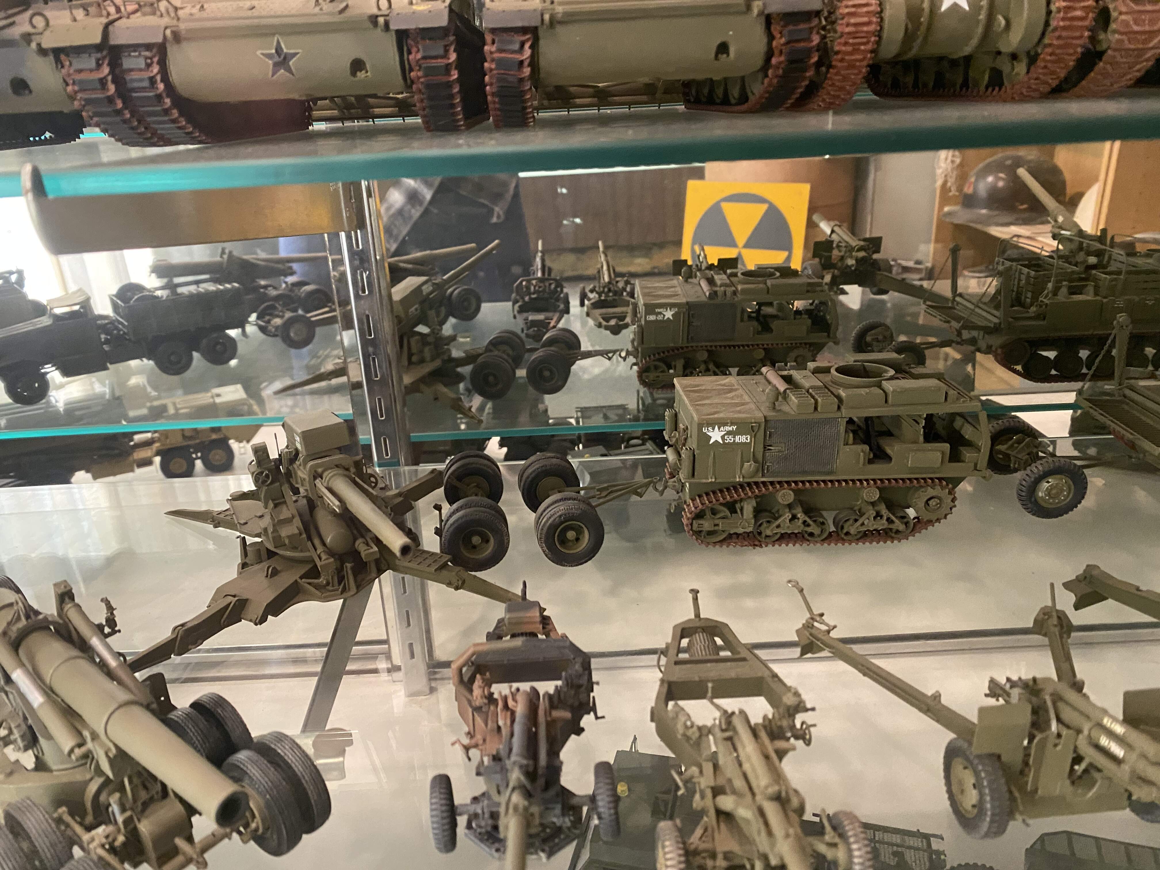

I’m neither of these but I’ll share my observations. I have about a half dozen kits in my wooden toy collection that I built pre 1973. How am I so sure of the date? They were left in my father’s house by me the day after I graduated high school. I never set foot in this house again.
They were saved by my youngest sister who fancies herself the family historian in the early 80s. She carefully packed several dozen and stored them and gave them to me later.
The ones I chose to keep were long out of production Renwall kits and my 1/25 Tamiya Tiger I. Does anyone remember the 1/32 Monogram Stug and PzIV with optional battle damaged side skirts? I threw these away. Forty years later now, I think I probably should have kept them.
All were assembled with tube cement. None had rubber or vinyl wheels. Several were brush painted and some painted with Testors paint and a siphon feed artists air brush (with canned air sitting in a pot of warm water :joy:) heady stuff for 1970. I remember buying lots of little bottles of thinner and it being a horrible mess every time I airbrushed anything. Sometimes it still is…
The only real deterioration I’ve noticed were all the solid runbber tires on my Dragon/DML kits (BTRs, etc) from the mid 90s exploded off the wheels between 2004-2008 or so. They got resin wheel/tire combos after surgery.
I dust everything once a year that isn’t in glass display cases. Stuff gets slid around on shelves but doesn’t move much. I’ve been in this house since 97 and I’ll probably be carried out of it when I finally leave.
Other that the tires I haven’t really had any real problems, but again, I’m not a craftsman like some of you dudes are.
Looks like I’ve had too much coffee again this morning.
That’s an Adams Sky Sweeper in the case.
Edited to add the Lacrosse and Honest John launchers got touched up and had new decals added in the early 90s
