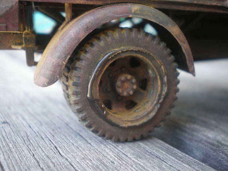

Ye olde vinyl t*res. I built this Italeri Blitz around 1998 and the kit had probably been in the shop for a few years before I bought it, so it’s maybe approaching 30 years old now. They gradually melt the plastic hubs as you can see, soon I’ll have to turn it into a wreck, or maybe sink it up to its wheel-arches in a river-crossing dio…
:thinking: :tumbler_glass:
Resin wheels!
There is a reason why I want to replace all vinyl and DS in all my kits…
I have the same kit, built a little earlier than yours and the wheels started acting up after a few years.
Indeed – makes me wonder about all those older tanks with poly-caps (if they were vinyl) holding wheels etc. in place. I vaguely recall the melting issue came up either in olde Armorama or Missing Links maybe 6 or 7 years ago, and someone who may have known what they were talking about mentioned Italeri’s old vinyl had a higher acidic content than Tamiya’s. No idea about DS, happily I’ve never touched the stuff.

Awww…really? You never, ever rolled something across the table? I did, but of course for higher purposes i.e. to photograph trucks etc on a slope as though in motion. OK no it didn’t work.
Yes good point re. sunlight – cheapskate that I am I’ve always used el cheapo artists’ acrylics to paint camo etc. There’s a reason they’re cheap, the pigments are unstable & react to UV light not in a good way. Not such a brilliant ploy here in Oz, the scheme on that Blitz is a travesty of what I originally painted.

Well absolutely you’d think so, but that Blitz has gone the other way – cruder - the brown was much beige-r, the green fainter. I haven’t looked at it for years so I’m still trying to work out what’s degraded…the white content?
Edit – this is the only surviving image of it from 2016, not easy to see but enough to tell the camo’s not contrasting the way it is now…
