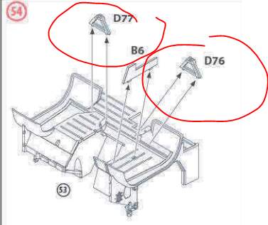

In some places the instructions are not clear enough and the kit’s engineering is not “dumb proof” as I was able to prove, with several errors in the assembly.
I assembled this part incorrectly, which I only realized when I joined the cabin to the chassis. It was necessary to remove the engine radiator. Since the engine will be closed and most of it hidden, this won’t be a problem.
It is necessary to be careful with the alignment of these two parts, as it is on them that the cabin will be connected to the chassis.
Guide pins would be very welcome in this place.
Same as the previous point, these small pieces are the “bed” of the cargo body. Gluing them out of alignment is VERY easy since there are no references for assembly.
A mistake here will misalign a large part of the kit.

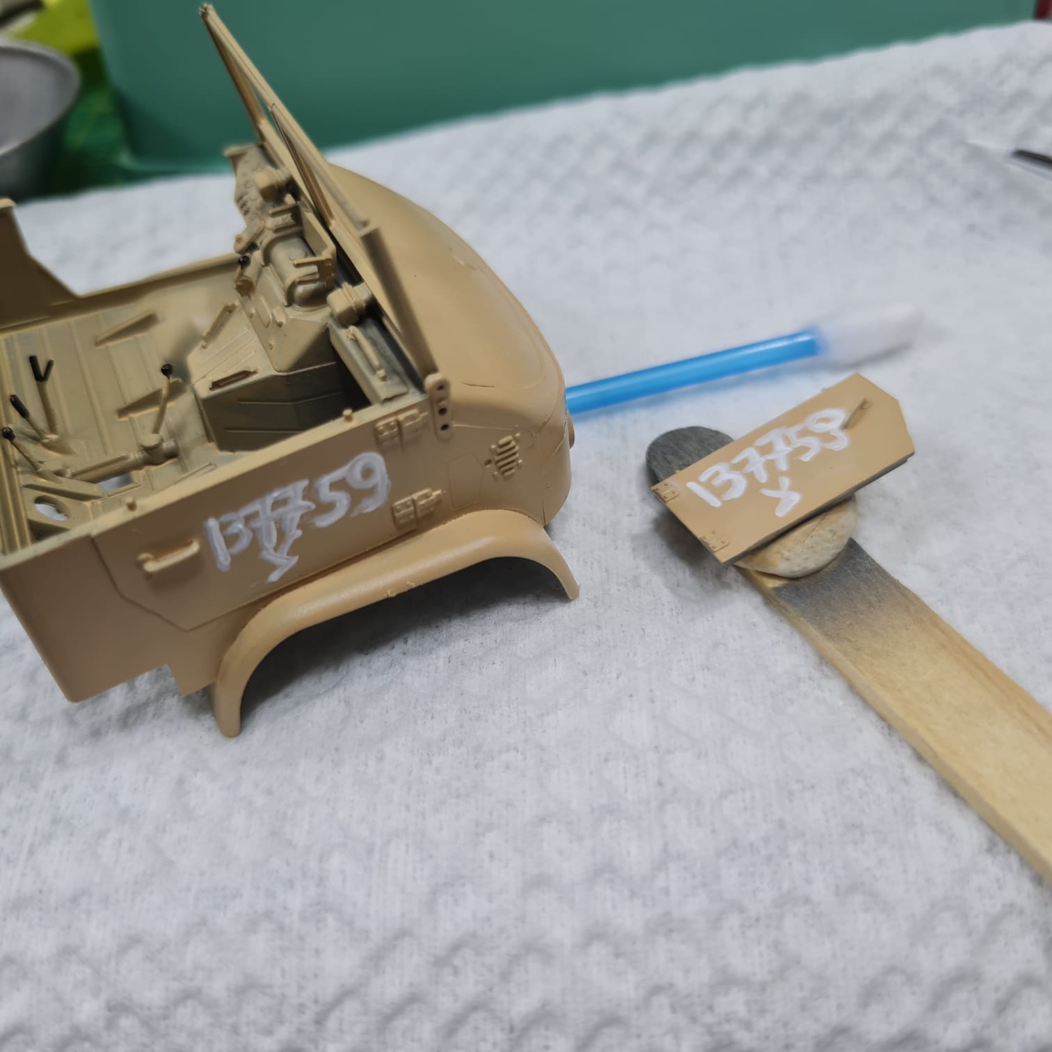

I made an acrylic color, which seemed close to the color used by the Egyptian Army in the 1970s and painted the large blocks.
My paint booth is a real mess! :sweat_smile:
In the markings, I mixed the two photos, creating a fictitious record.
In the photo of the Egyptian Unimog, the IDF license plate painted on the door appears to be 137795, always starting with the number 1, traditionally used for license plates of captured vehicles.
On the Syrian Unimog, I found the number 9 painted on it interesting. I noticed it in two places on the side, and on both sides of the rear, with the license plate in the center.
I assumed that its IDF license plate ended in 9 (justifying the 9’s painted on the sides).
So, I modified the license plate of the Egyptian Unimog to end in 9 and made the markings on the sides like the Syrian vehicle and painted the markings, trying to copy the “font” of the image, lol
Acceptable result so far :sweat_smile:

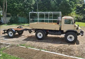

Looking carefully, the Egyptian truck appears to have a structure made up of some supports along the body, with crossbars on top.
A guess is that, in this case, there may be three supports.
Some photos from the internet:
In these photos we have supports for all tastes, lol. Trucks with two, three, and even four, like in the last photo.
I’ll do it with three, plus some reinforcements on the top.
Interesting photo too in that the sides of the truck bed look like they’re corrugated. That may be tough to replicate!

The ICM kit is a Unimog 404, the one in your pics over the Canal is a 416, basically the same chassis but cab, body and wheels differ.
Egypt used the 416 while Syria mostly 404 and some 416. Seems the IDF had already captured some syrian 404s back in 1967, but also received some firefighting and ambulance models as civilian aid from Germany. During the YKW many more 404/416 were captured and put to use inmediately.
