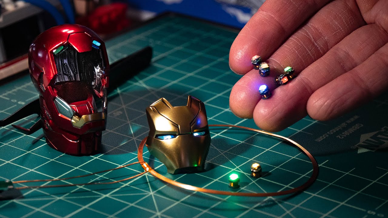

If you want pre-made lighting, there are tons of stuff available in model rail road and doll house supplies. If you just want to add lights to your own fixtures, like the Miniart stuff, you can get LEDs in various sizes, prewired, and even with resistors installed, on eBay. T0603WM 20pcs Pre-soldered micro litz wired leads Warm White SMD Led 0603 NEW | eBay
