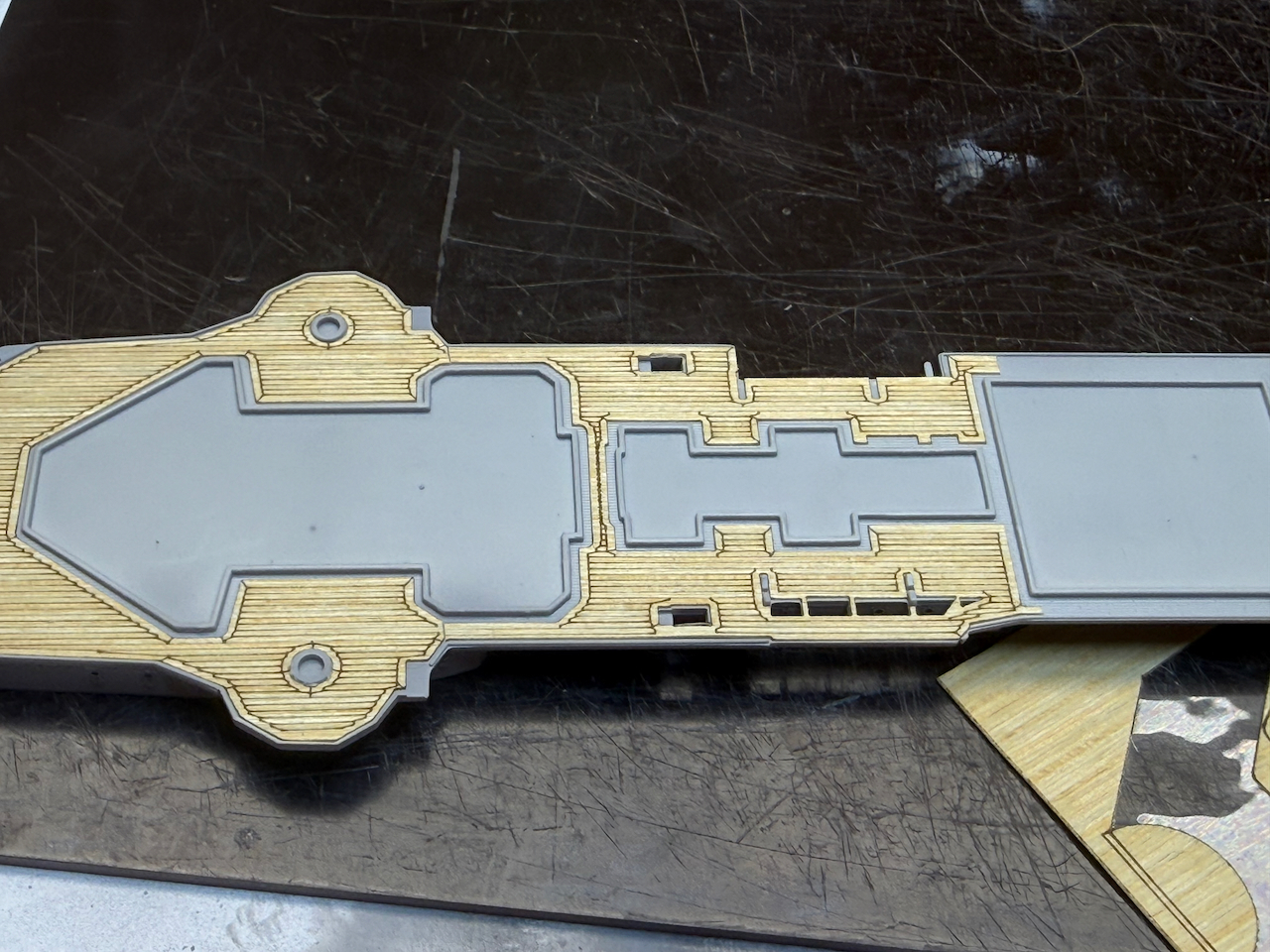

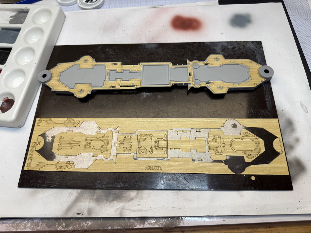

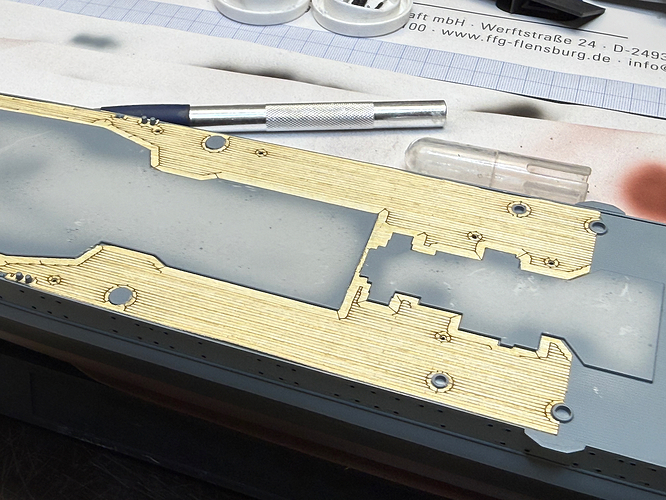

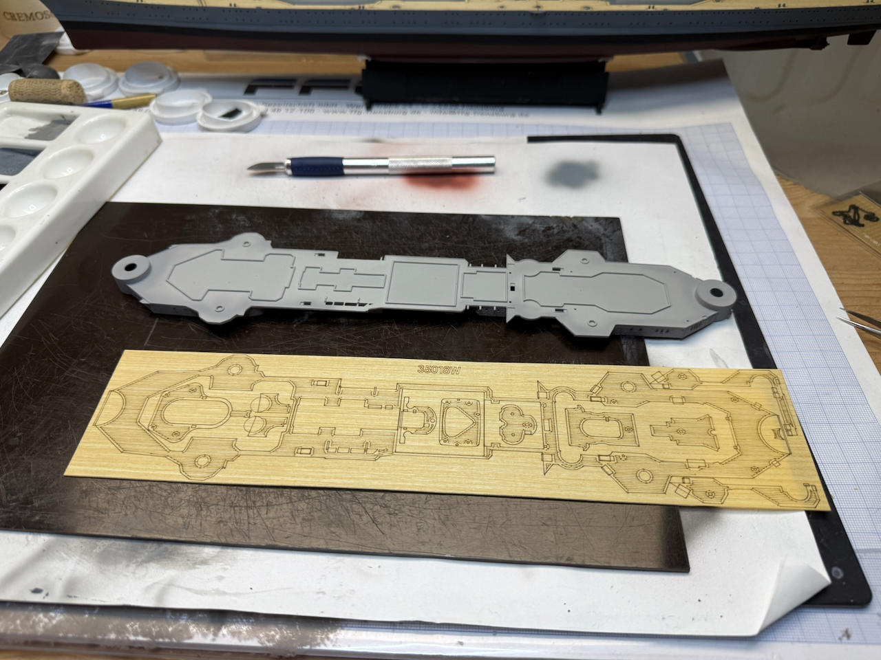

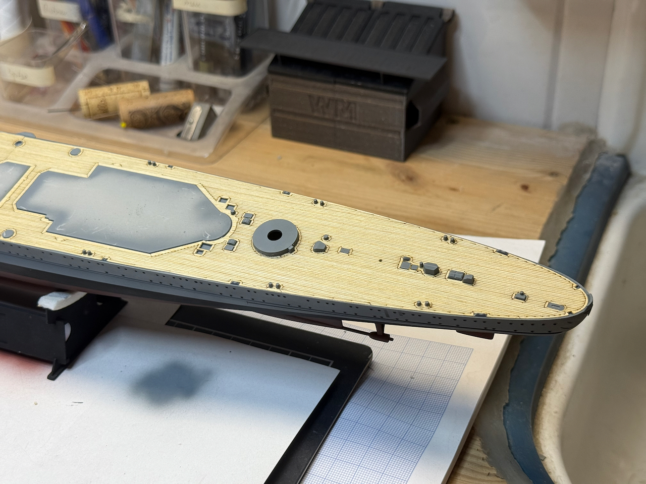

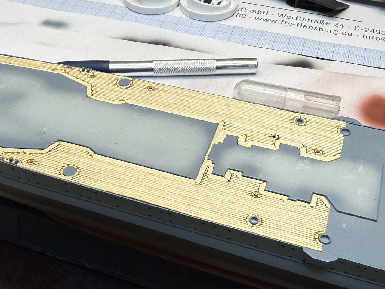

I started to lay down the wooden deck. The deck is very fine, thin and delicate, and the fit is really good. However, it is a bit tricky to get from its protection sheet, and the laser cut in several areas is not going all the way thru, so patience and a sharp knife are necessary all along.

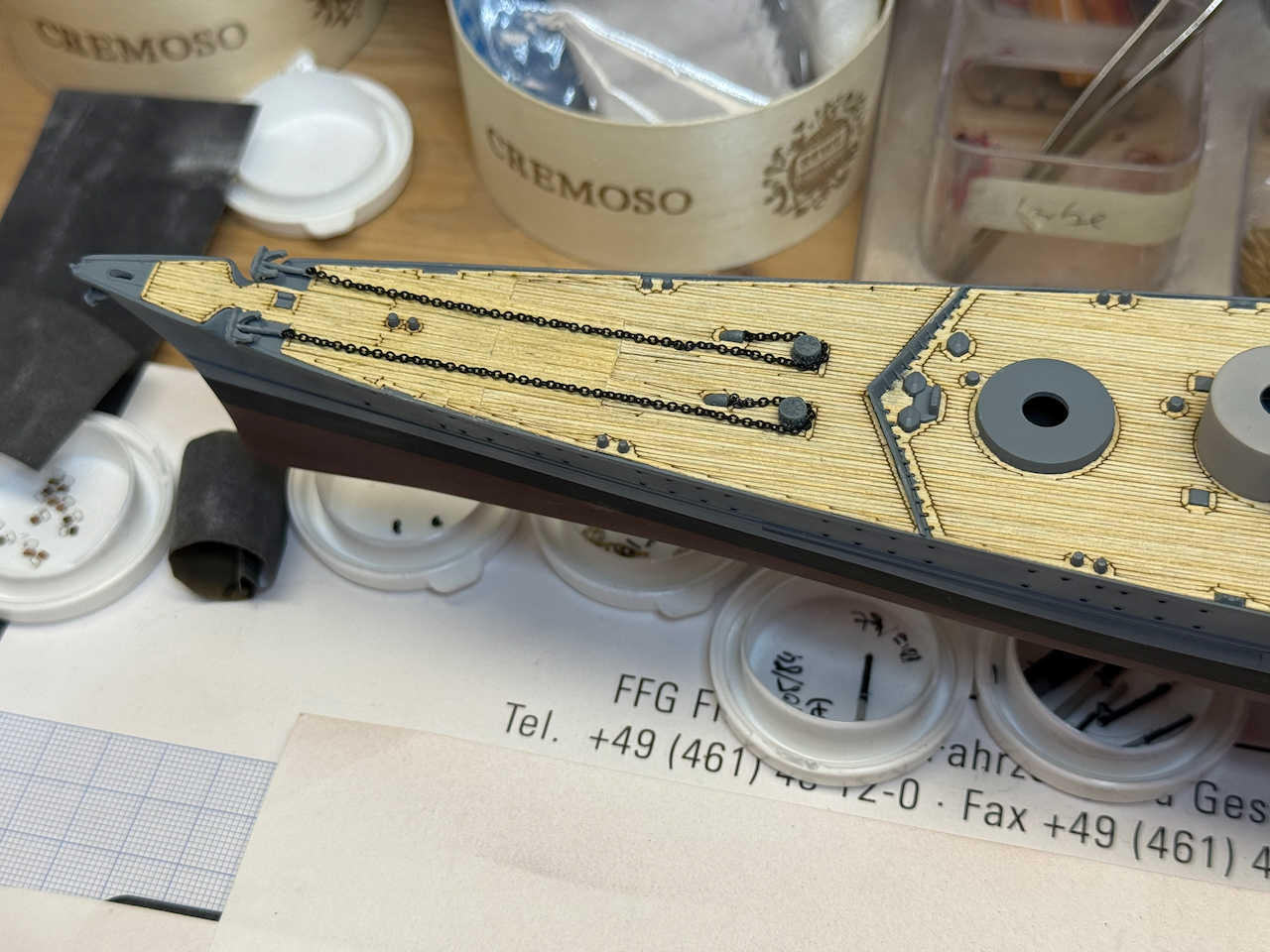

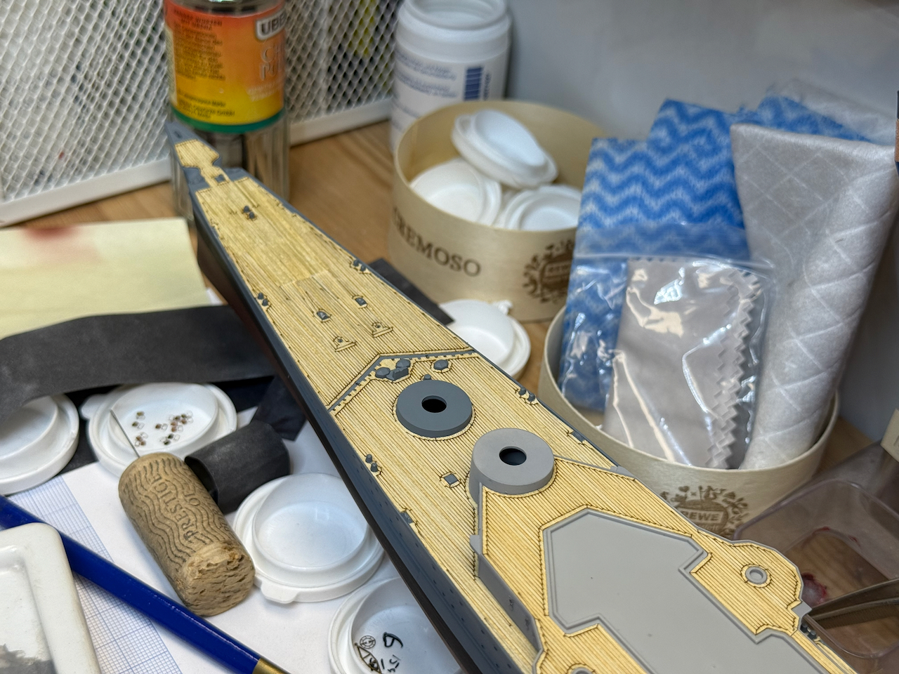

Forward part -

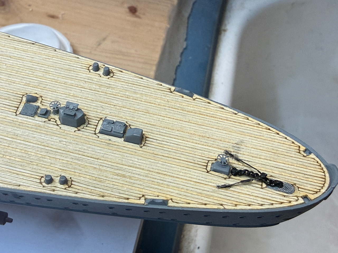

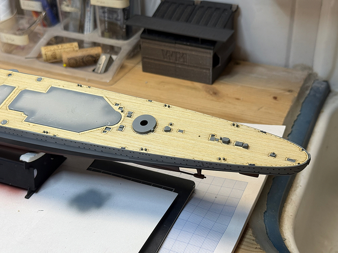

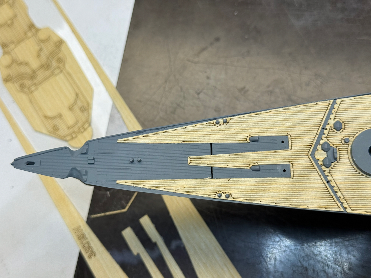

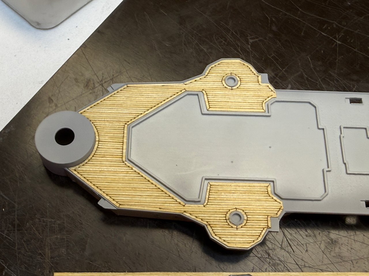

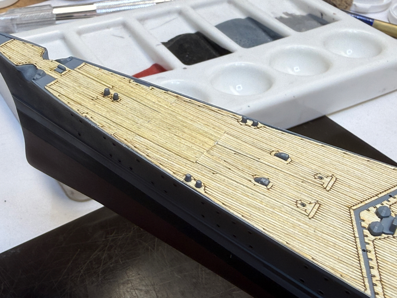

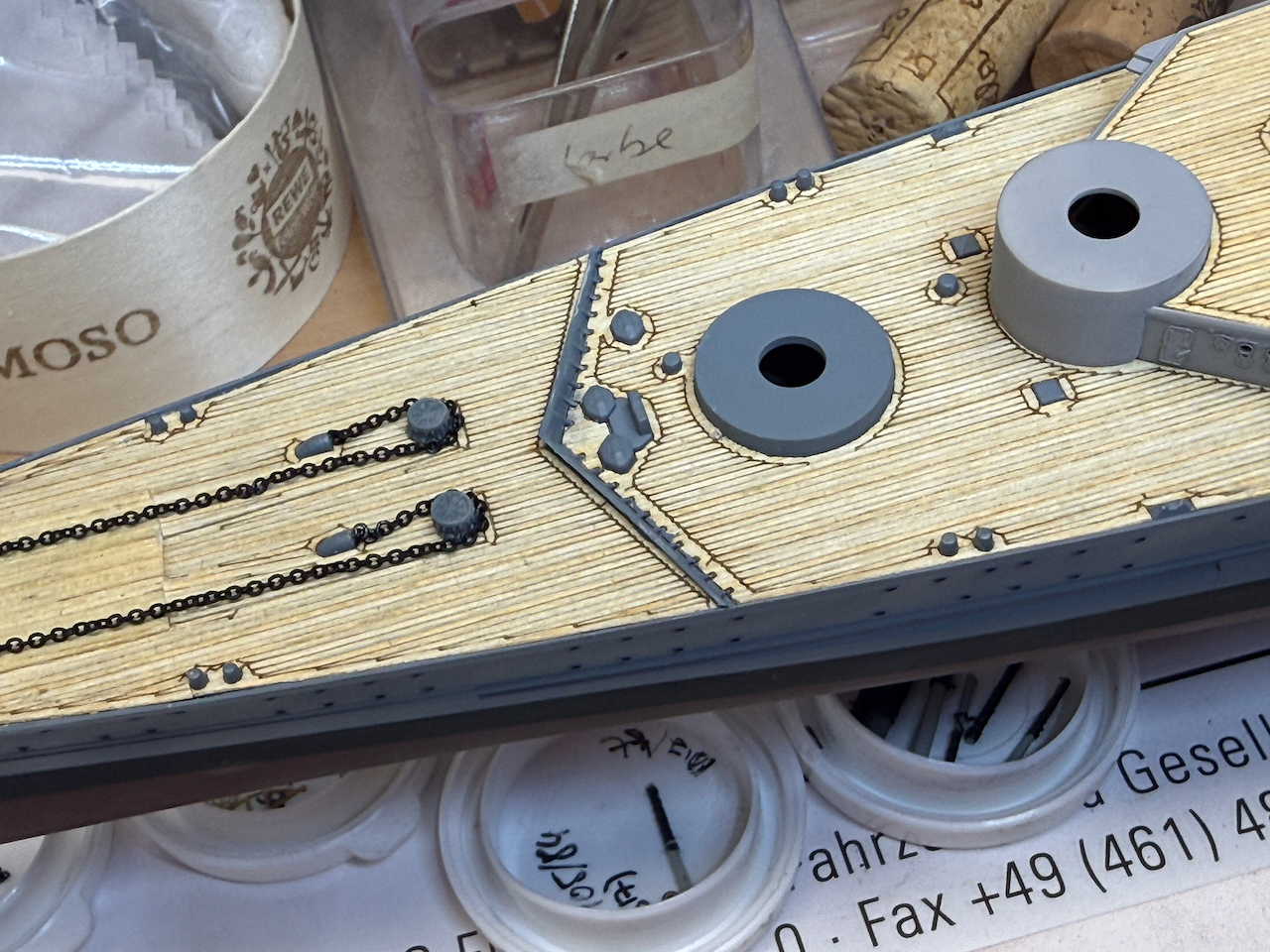

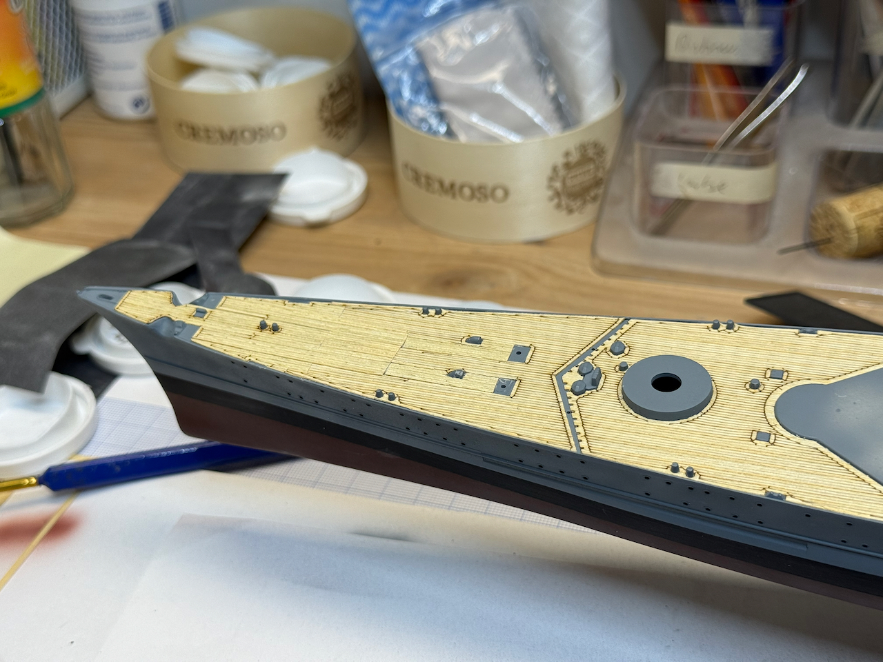

And now the interesting part, the foc’sle. The difference between the Prinz Eugen’s hull and Blüchers deck, or her foc’sle shape respectively, becomes very obvious.

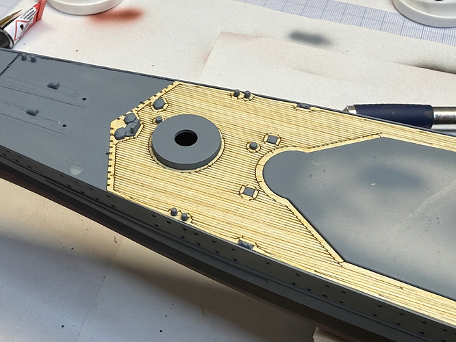

Joining the two wooden decks was more like a trial and error endeavor, and I missed taking pictures along the way. So here is where I ended up first.

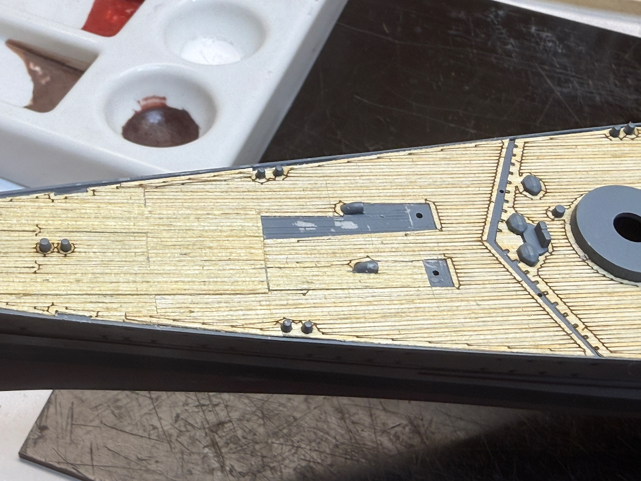

For some reason, the Blücher deck parts that go under the anchor chains escaped me at first…
So time for some fixes…taking some of the wood off again, port and starboard of course.
And replacing it with the correct parts - much better!

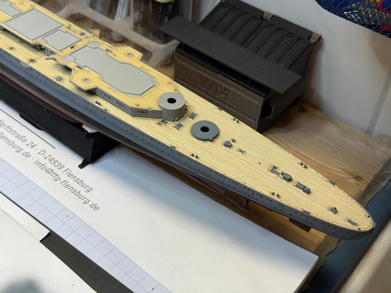

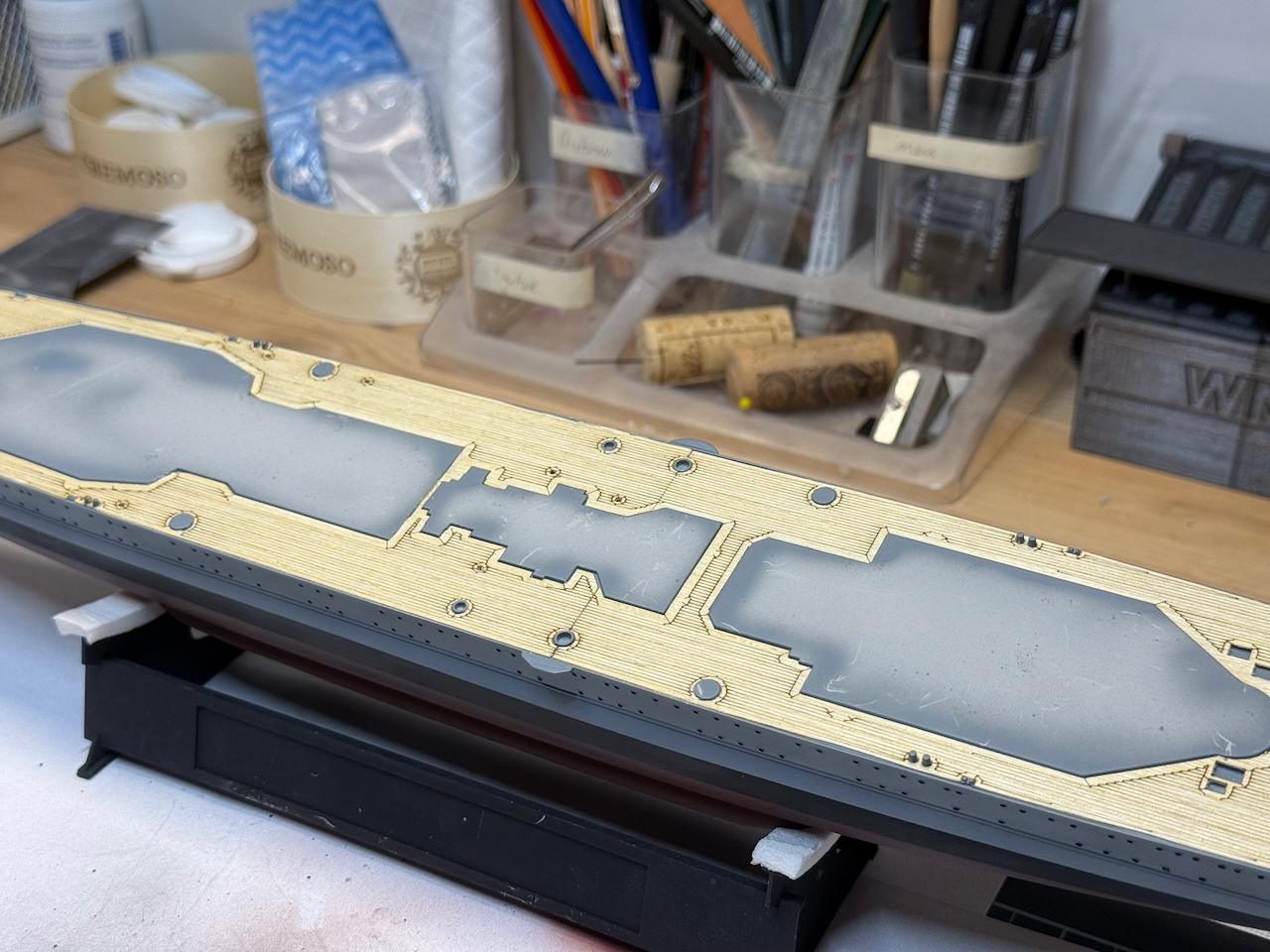

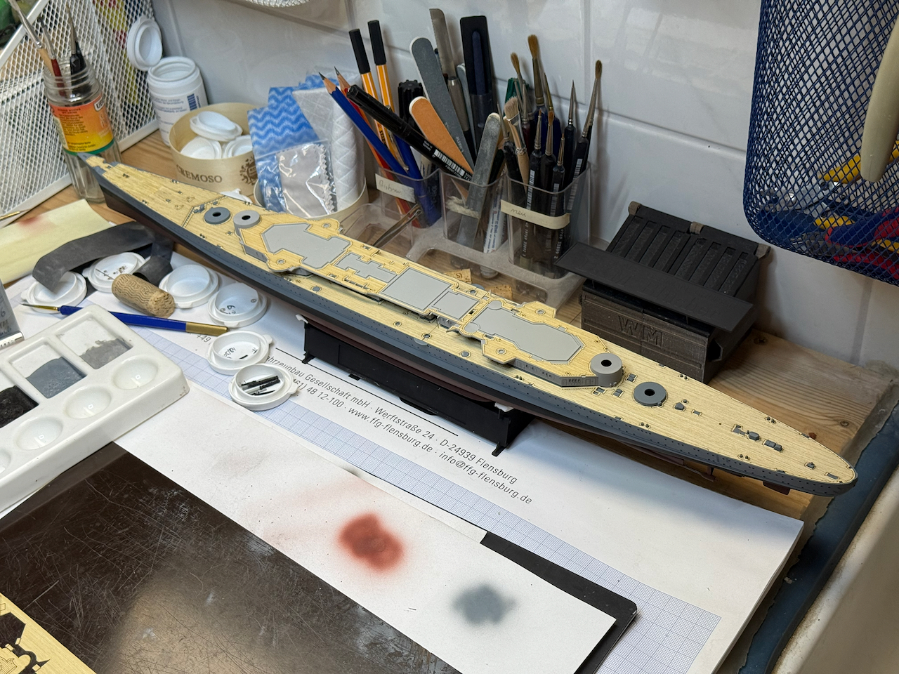

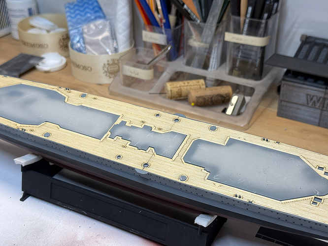

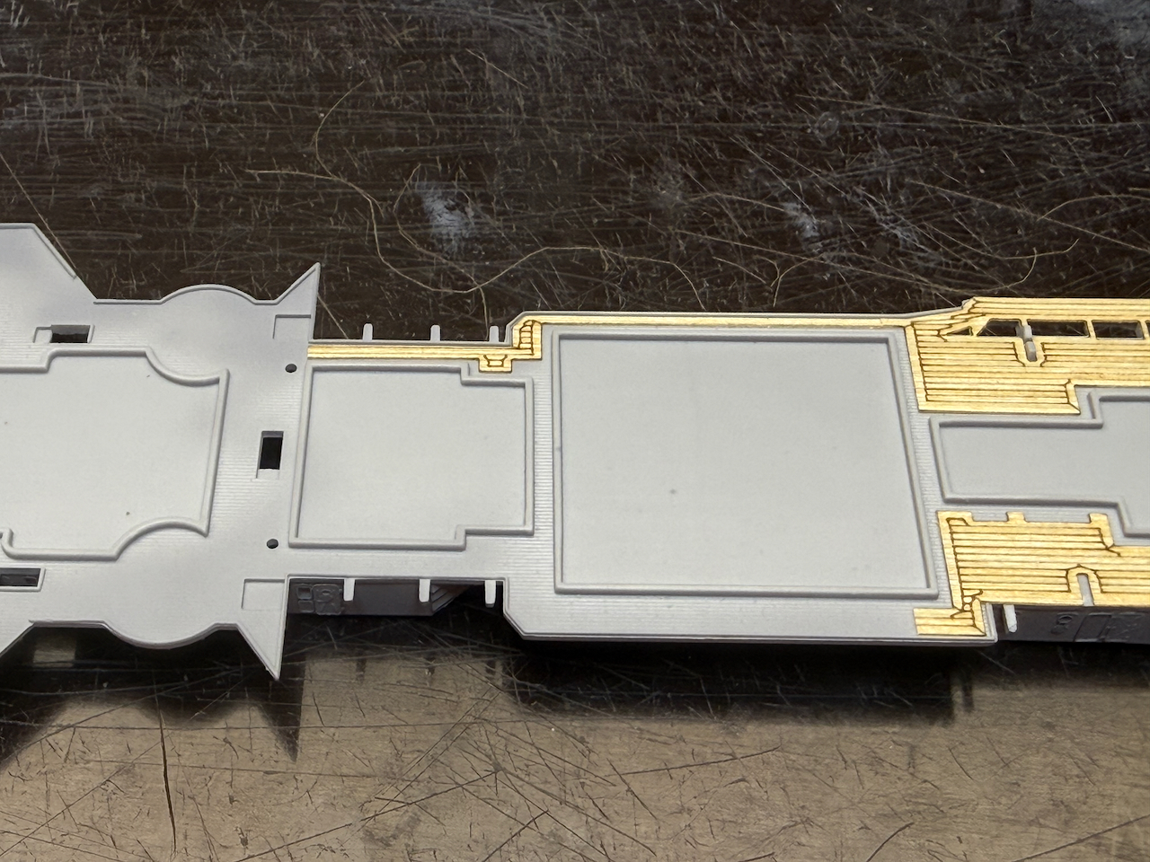

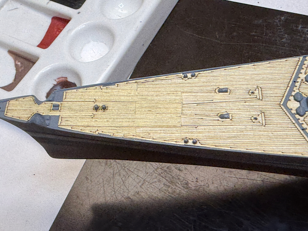

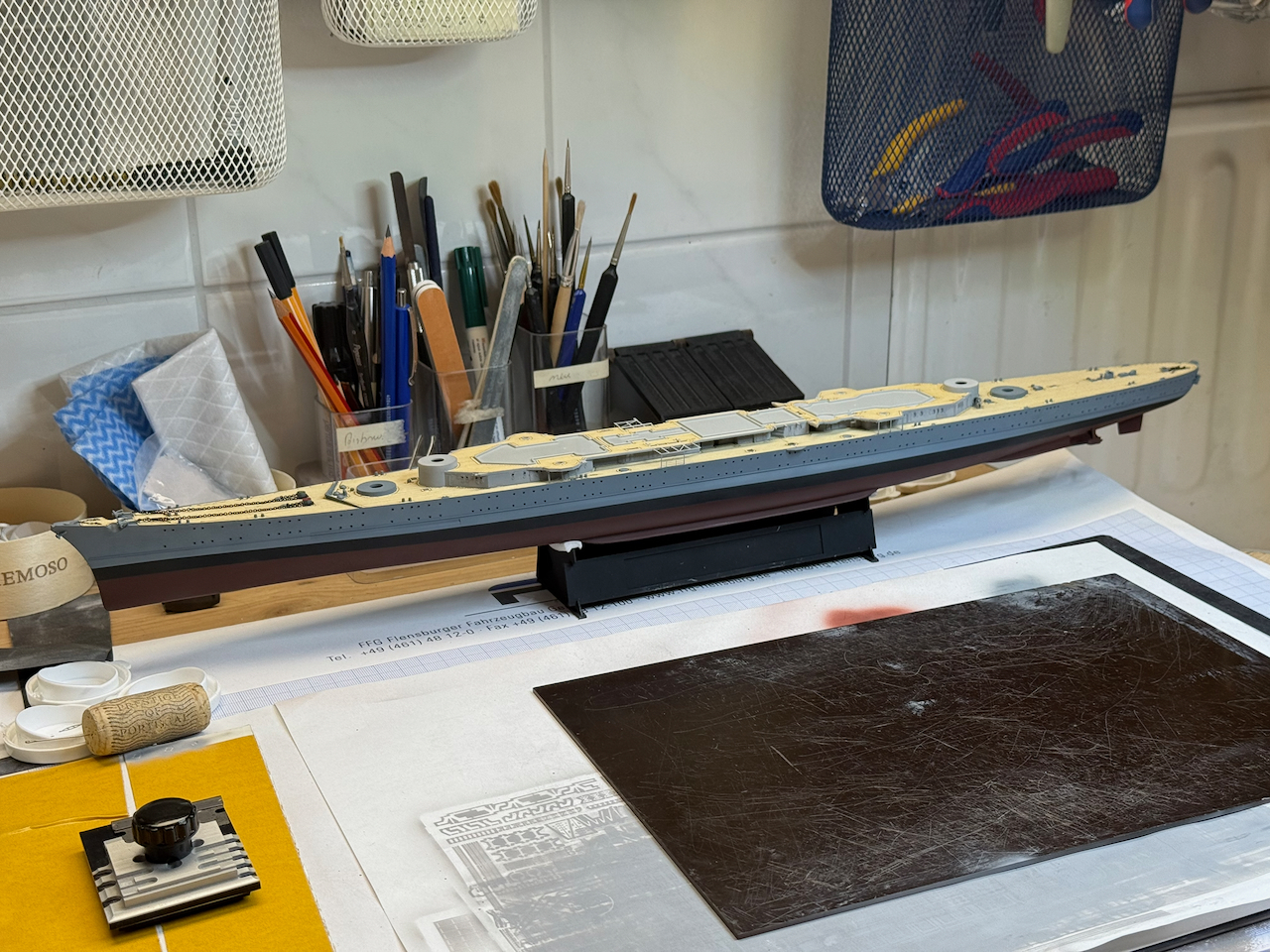

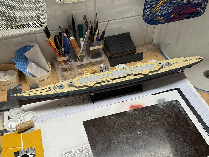

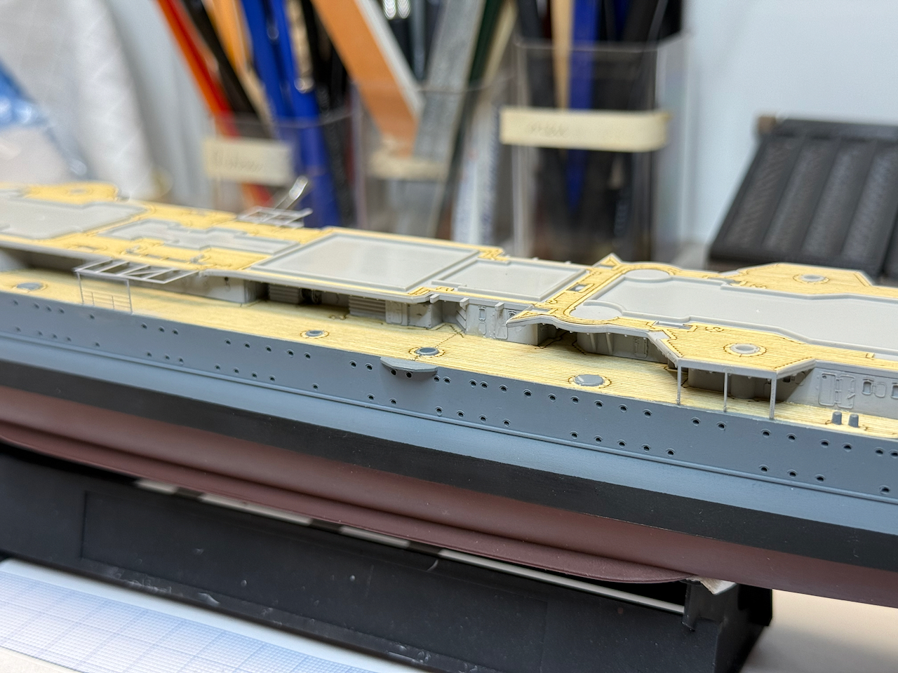

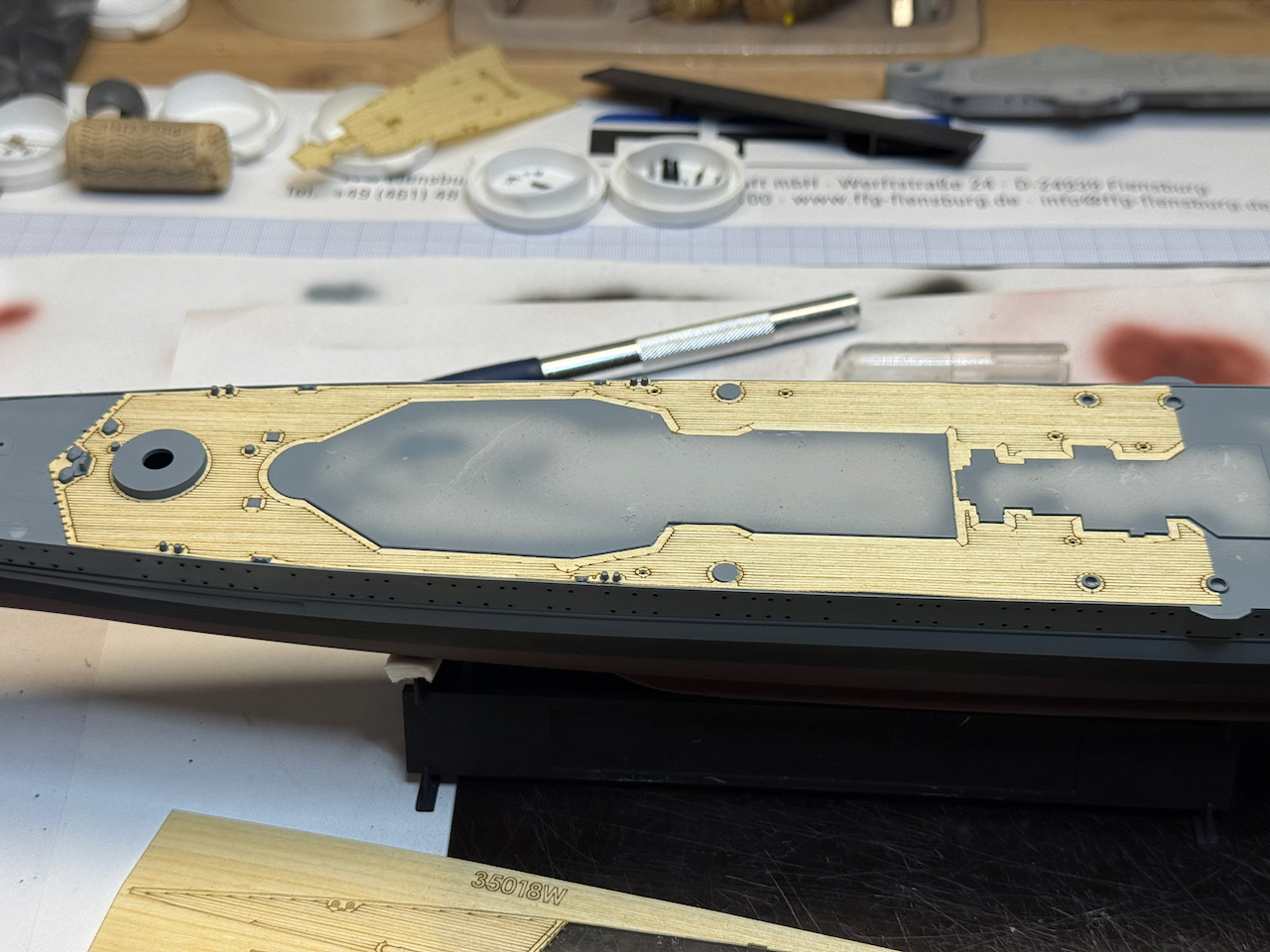

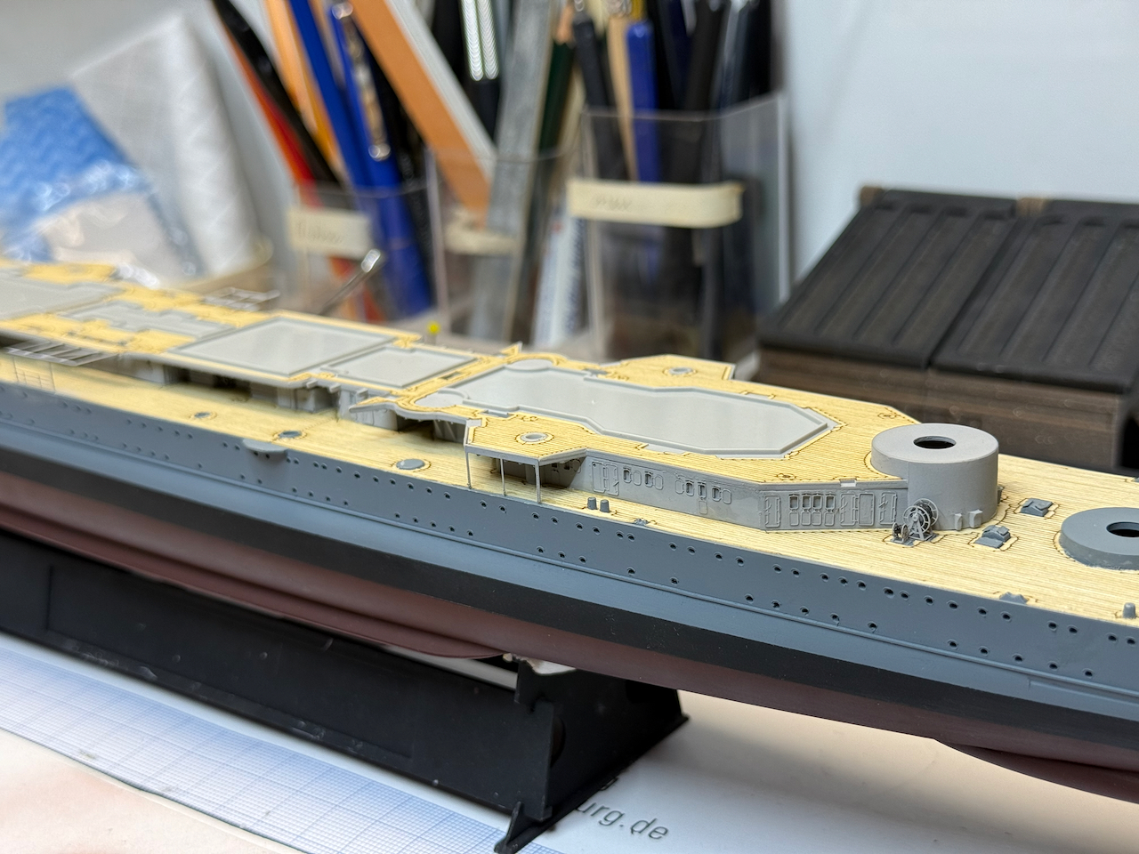

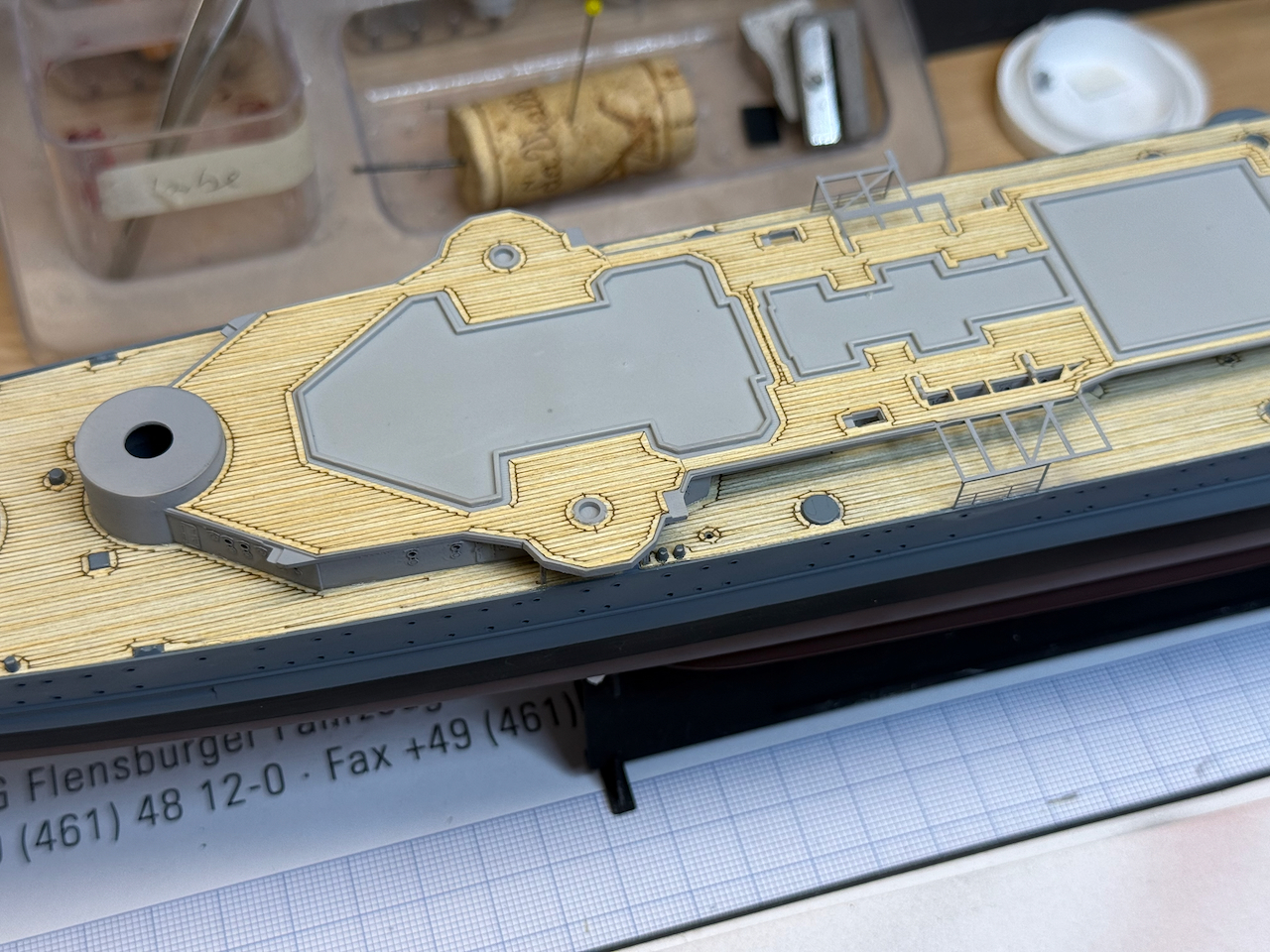

Next, the after part of the wooden deck, completing the main deck.

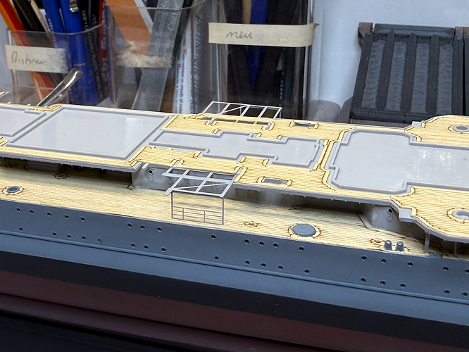

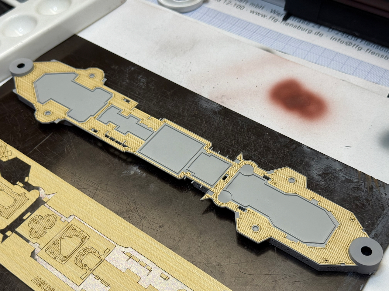

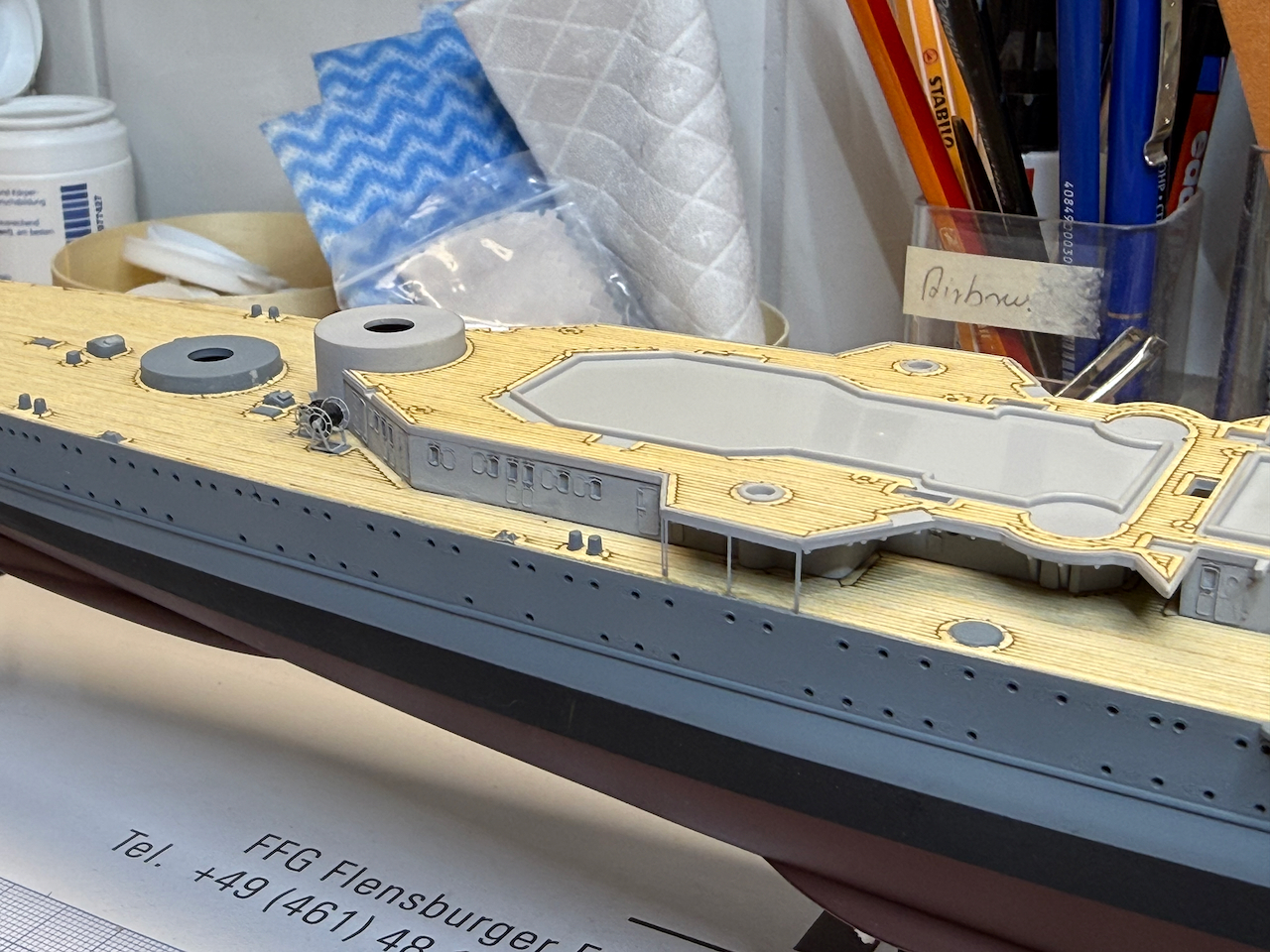

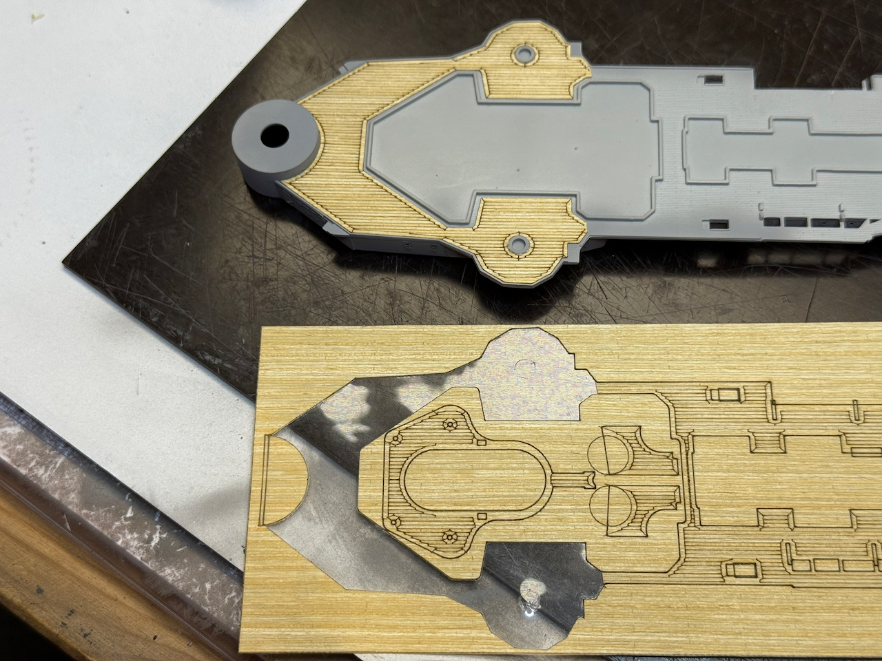

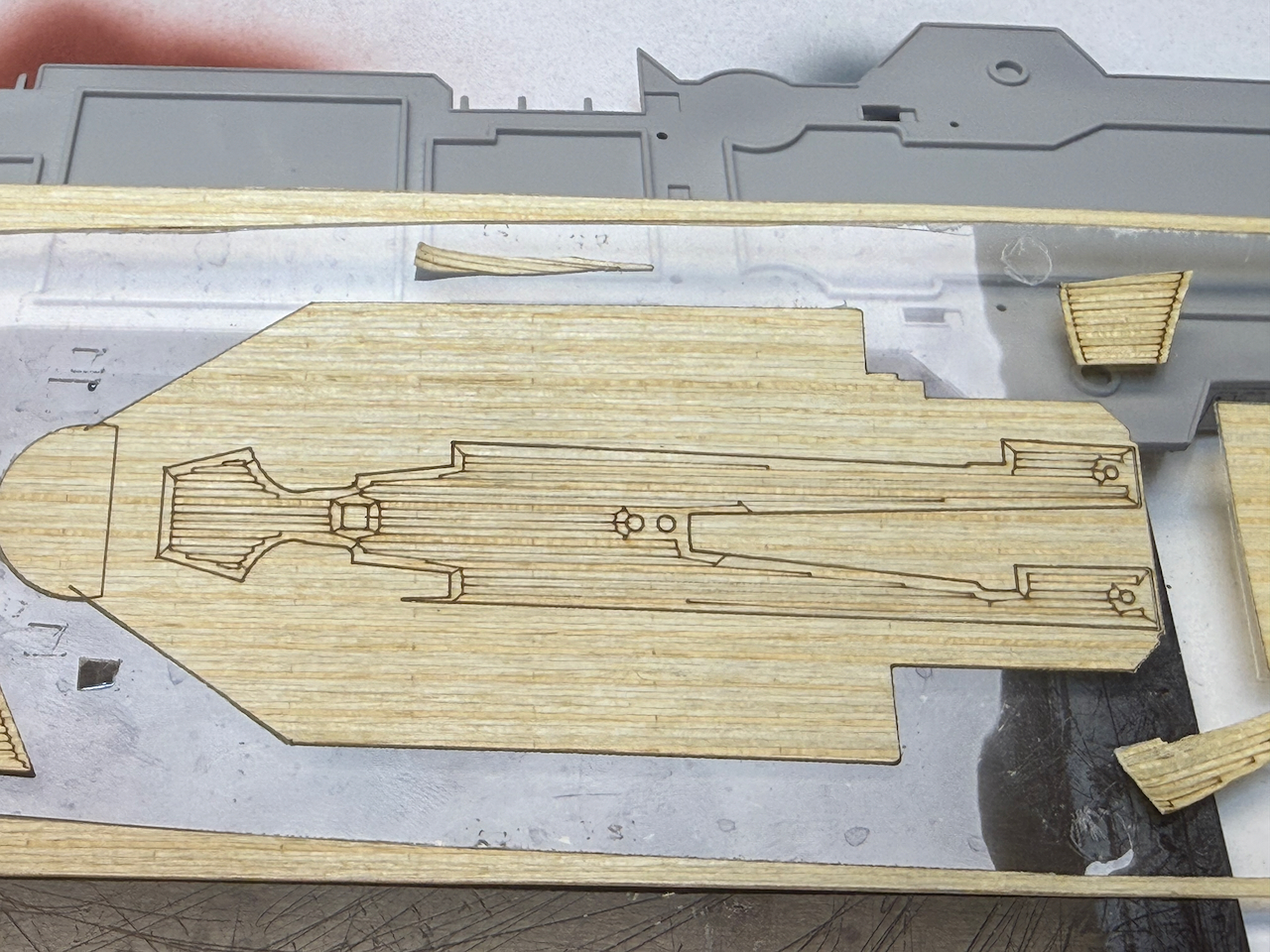

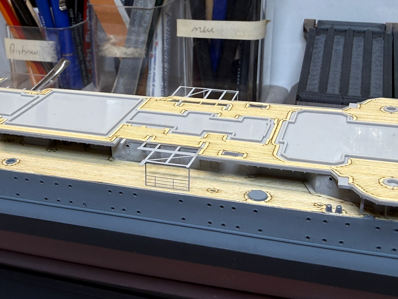

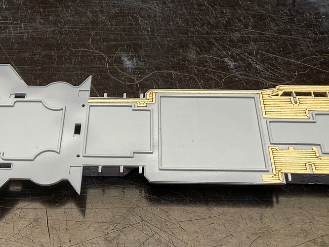

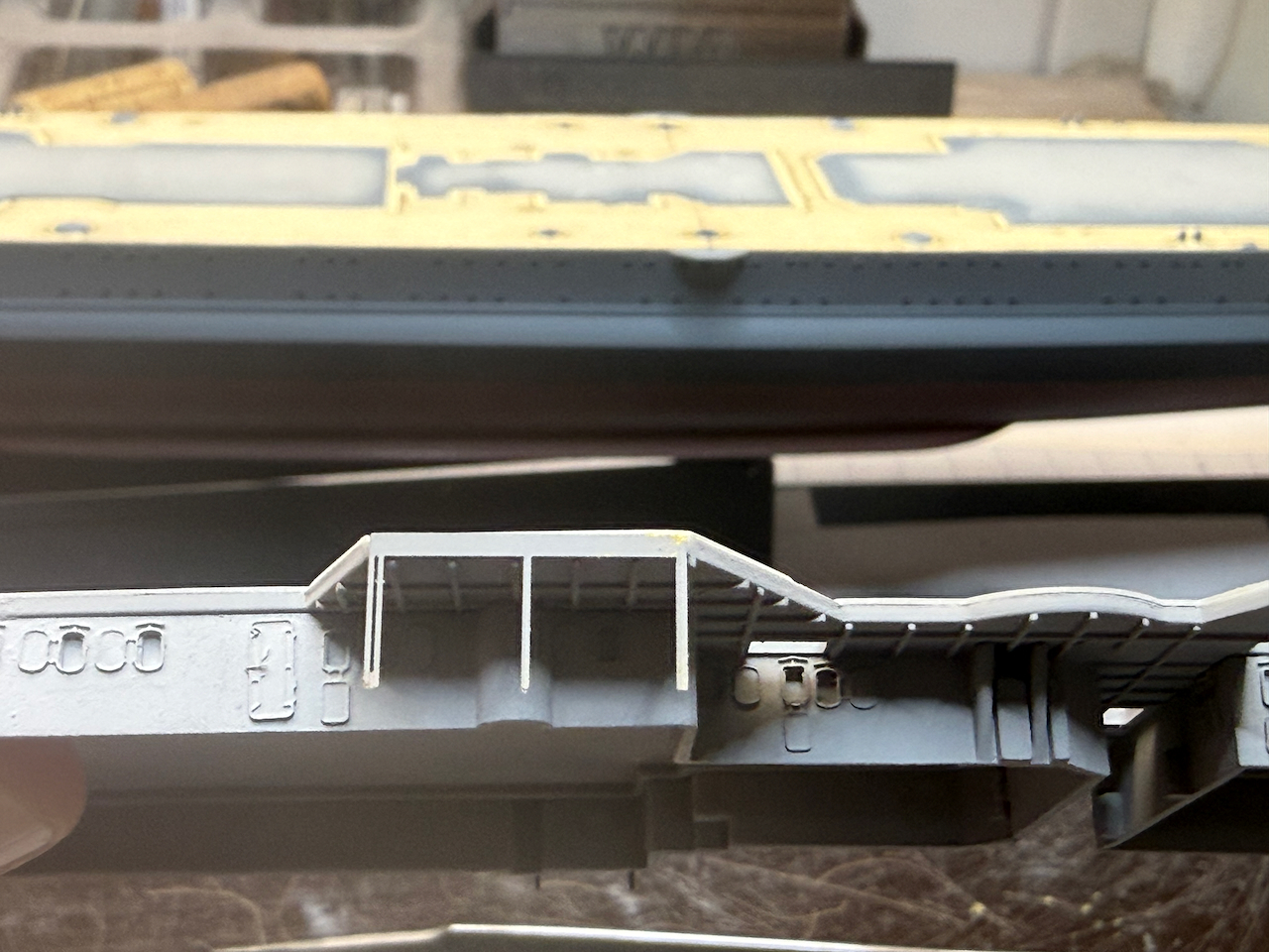

Once at it, continuing with the first superstructure deck.
This is one piece for the entire deck…I don’t think that this is a good idea, as I fear misplacing parts or endings up with wrinkles and bends. So I cut it at points that won’t be too obvious and lay it down in several small pieces.

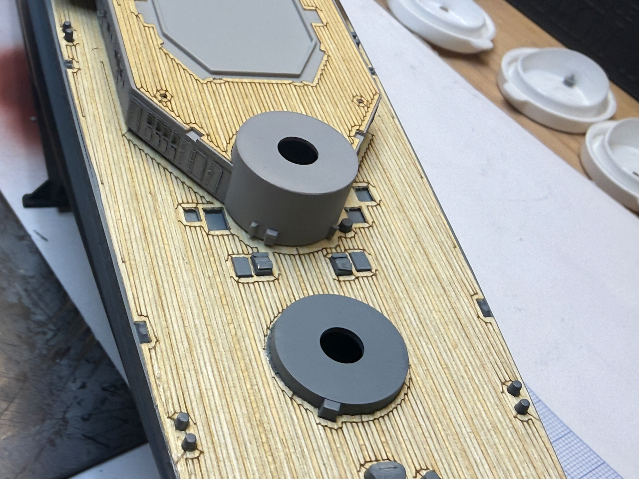

The first structure deck is only test fitted for now.

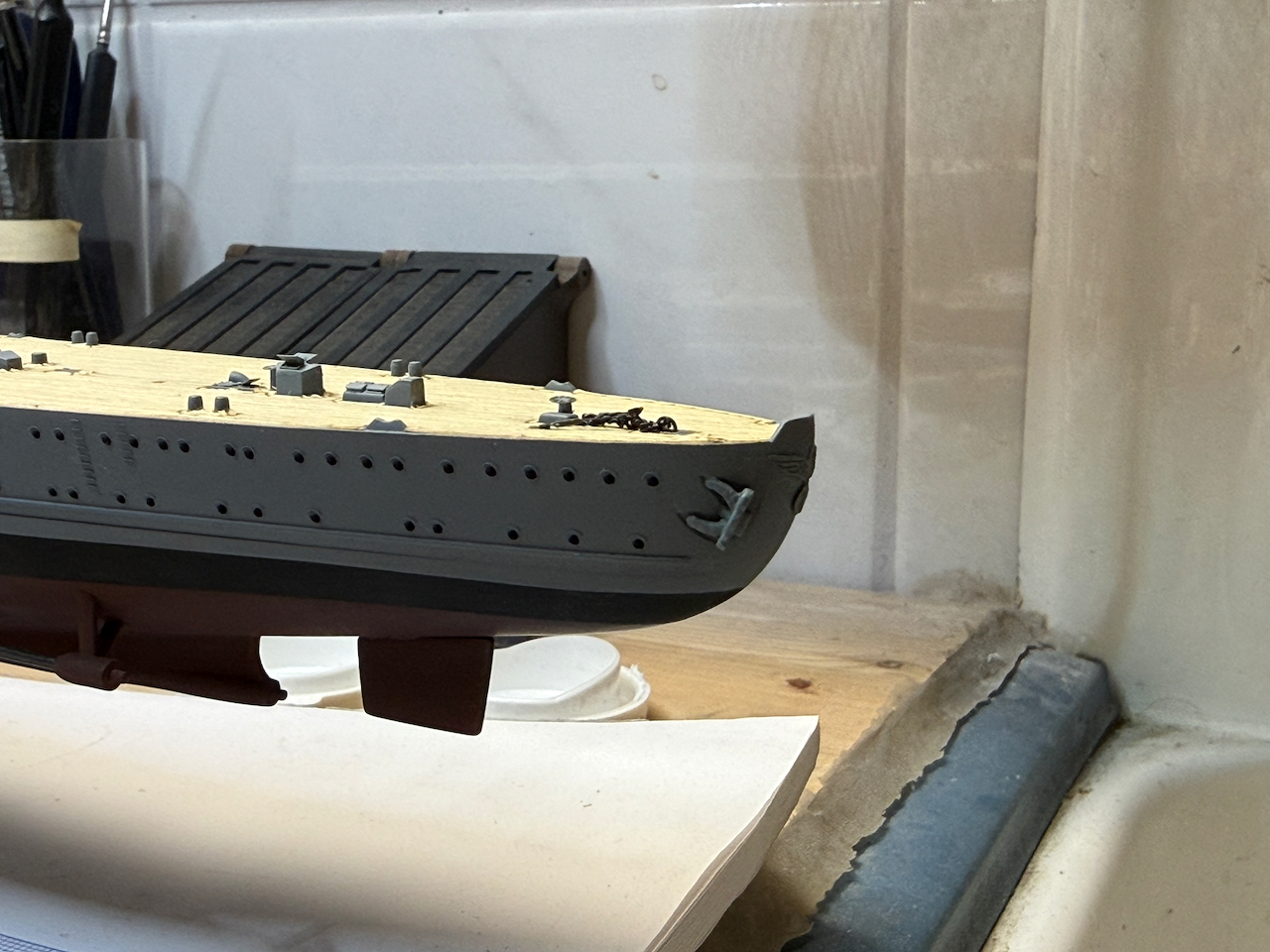

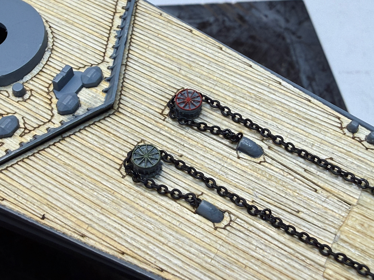

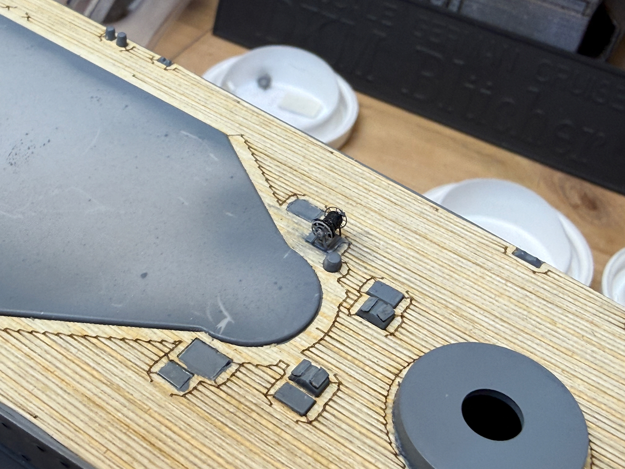

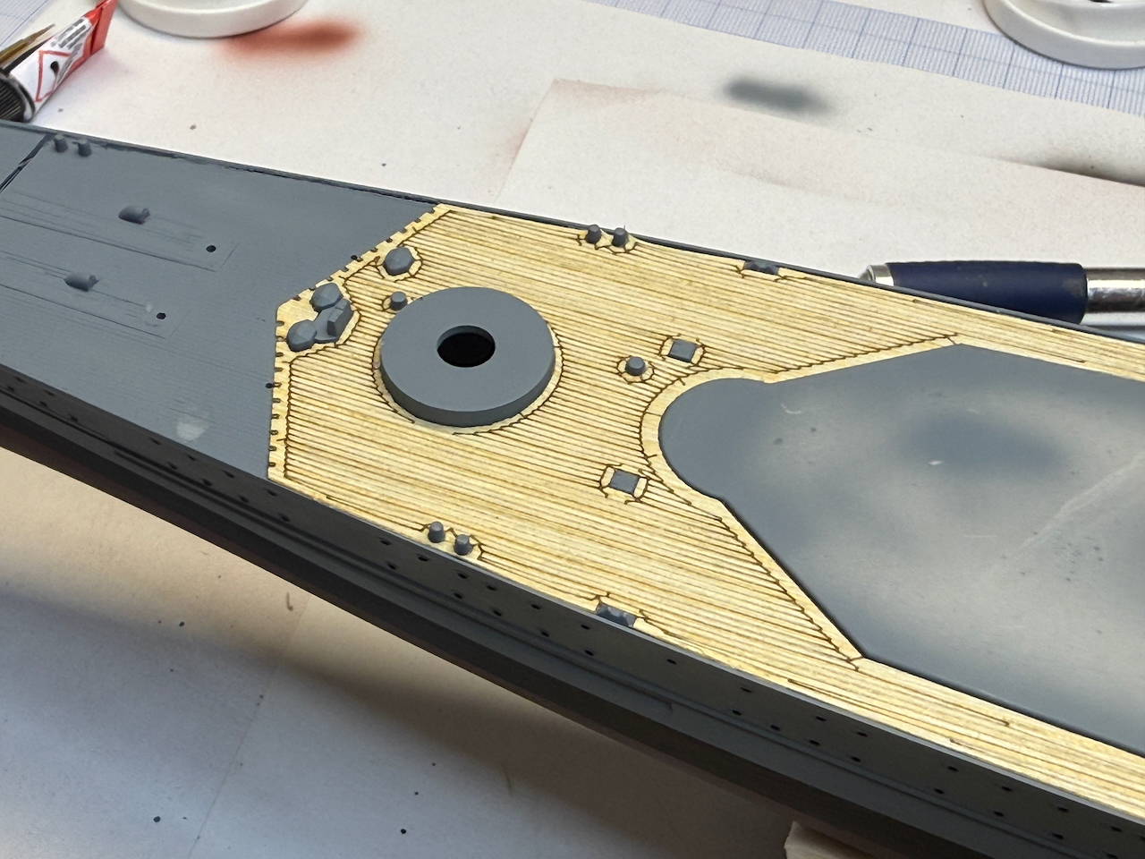

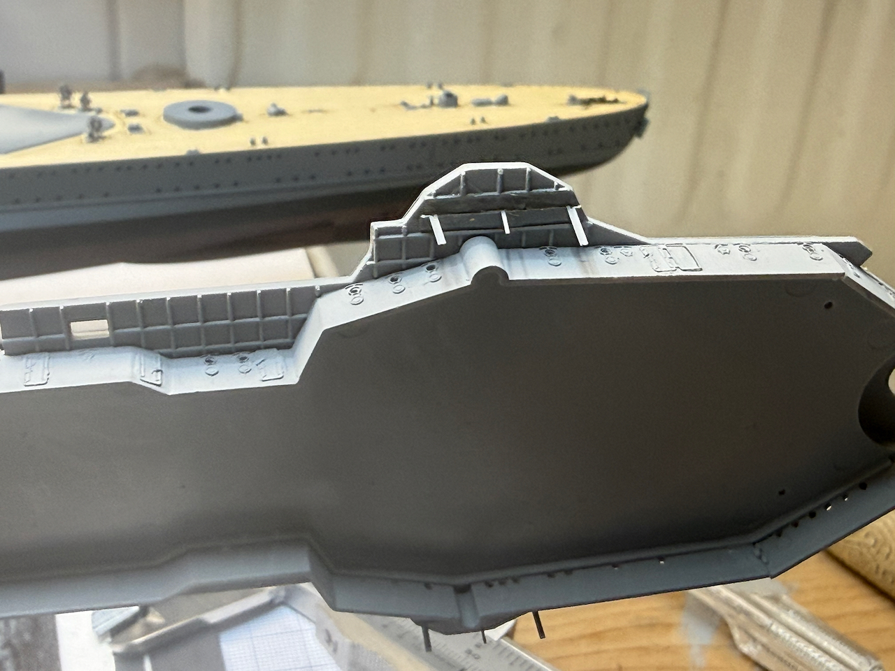

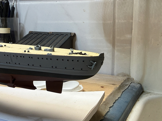

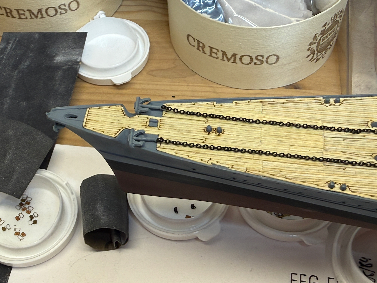

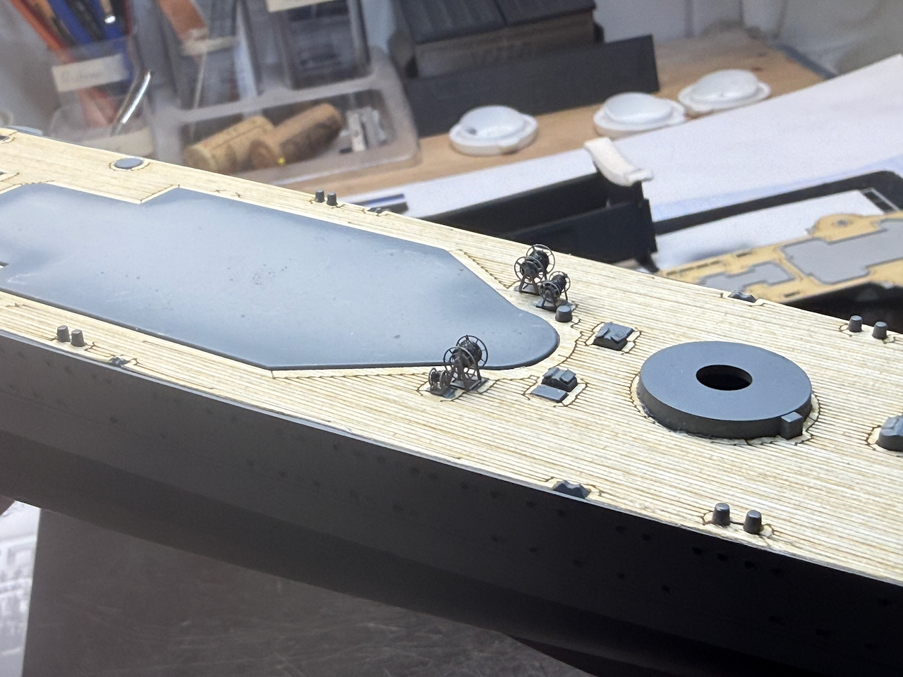

Last work for now, the forward anchors. Not completed yet, some details and the chain from the bow anchor will be added for the next update…

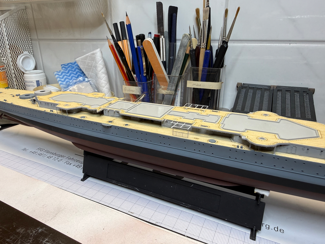

With that, the joining of the two different decks is pretty decently concealed.

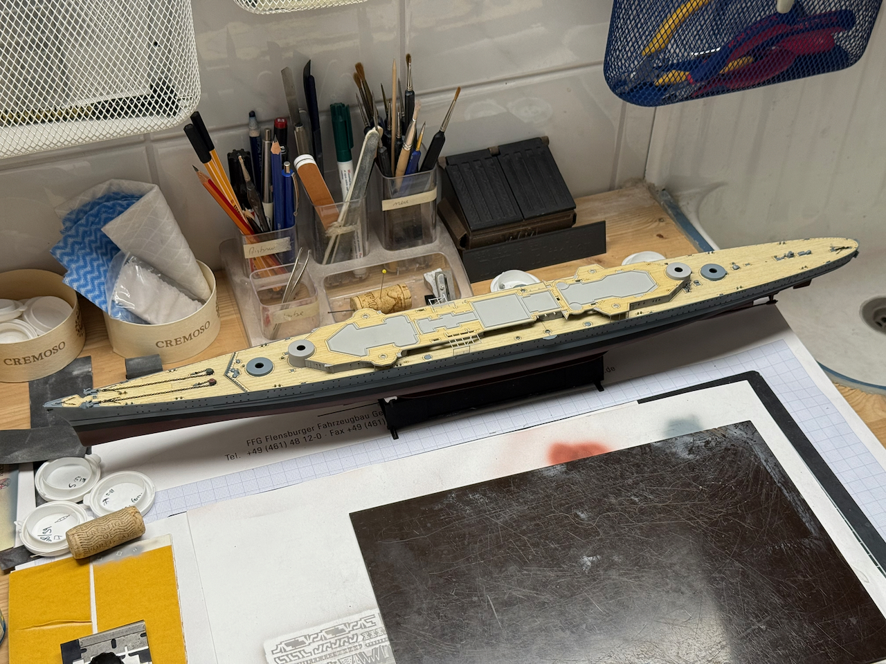

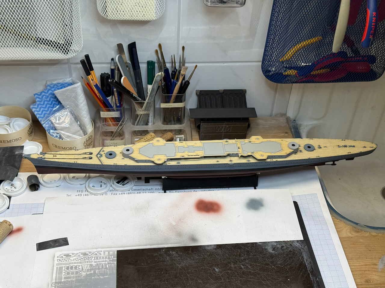

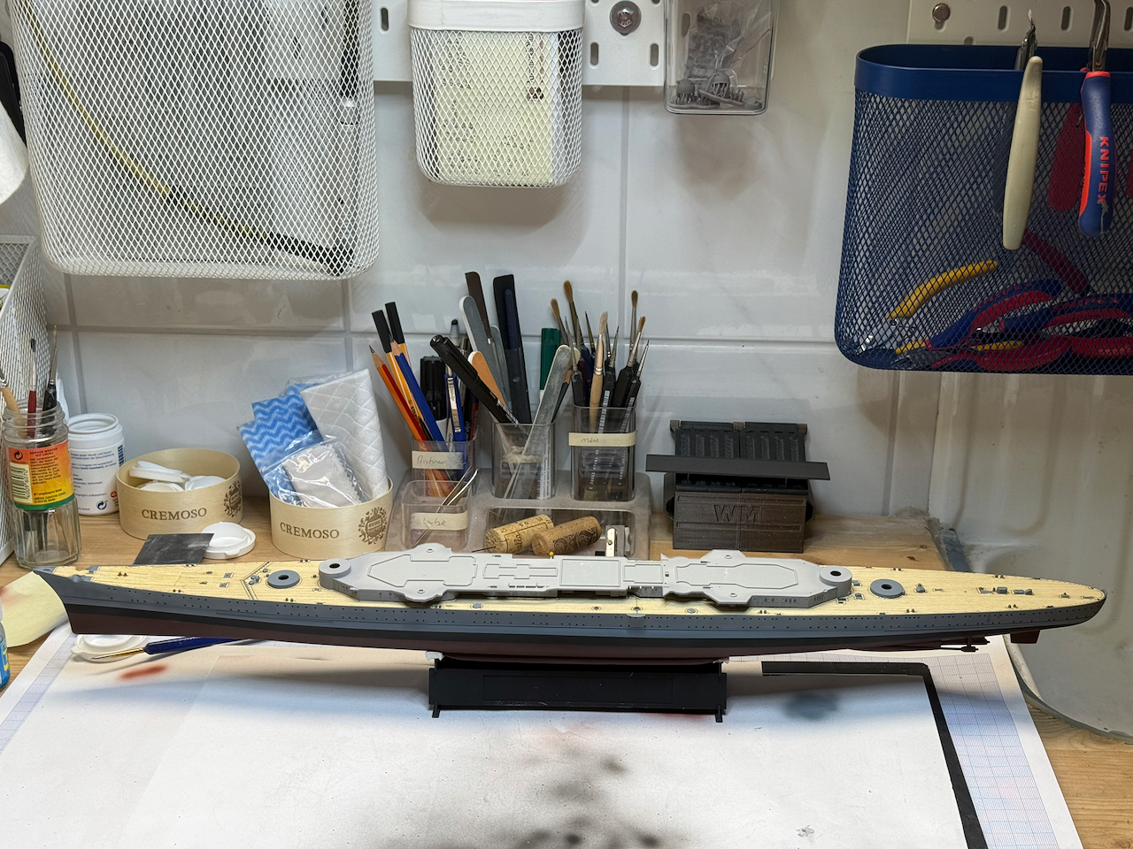

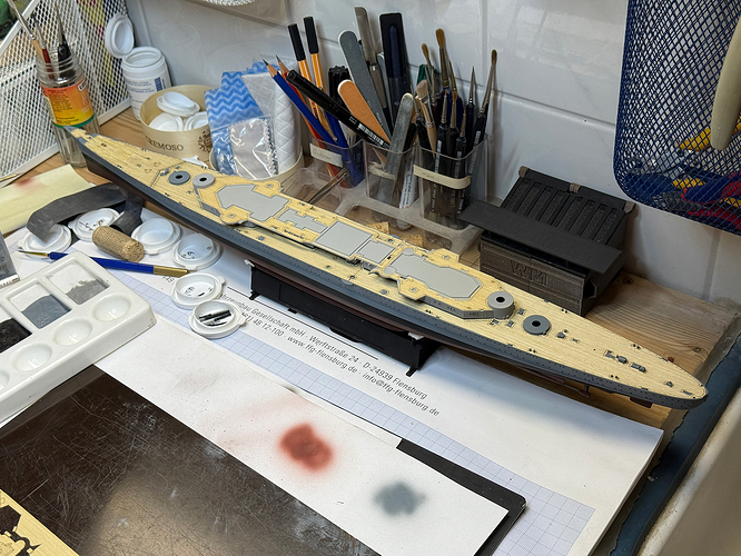

Here’s where I am right now, the first upper structure only test fitted.
