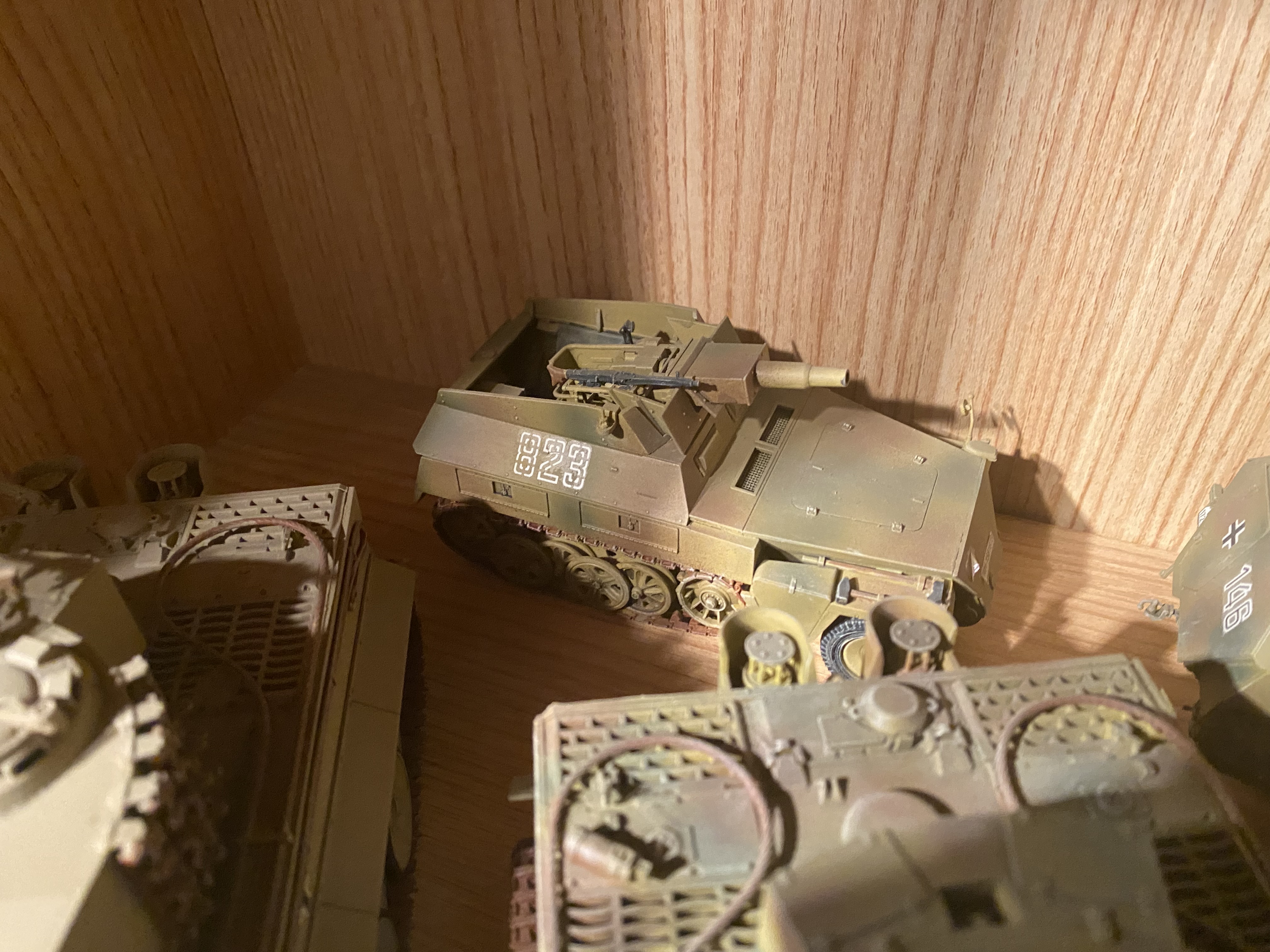

I had to go looking to find them but I knew I’d built a bunch of these back in the late 90s. They are all Dragon kits.
I don’t recall much about the builds other than the tracks- for individual links, they weren’t bad at all.
Apologies for the pictures, there are lots of shadows on the backs of the shelves.
The star antenna broke off a long time ago. Note the lawn ornament poses.
Nice work on all of them.
