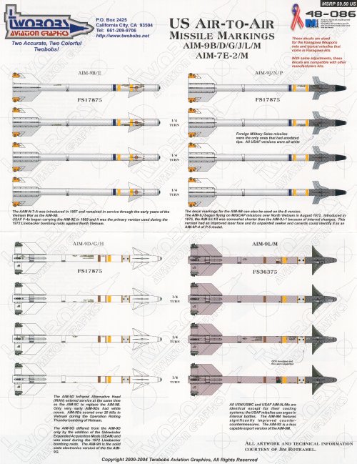

From what I’ve been told, AIM-9s were white up until the early 80s(?)and the 9L. Then they switched to grey. Captive carry/ training ones are blue or carry a blue band signifying no warhead or rocket motor. (A lot have the IR sensor still and are used for “lock ons” in ACM training. ) This is the US norm. The RB-24s were built in Sweden (SAAB?) and had some Swedish tweeks (fuse, etc) . Same for the RB-27/28. (In fact if I remember correctly the RB-28 was a mix of AIM-4 models with upgraded seeker and proximity fuse)
Same with JASDF aircraft. Photos are either toothless or have "blue " training rounds.
