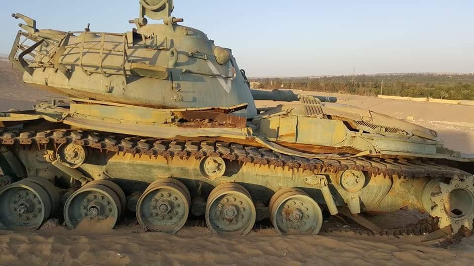

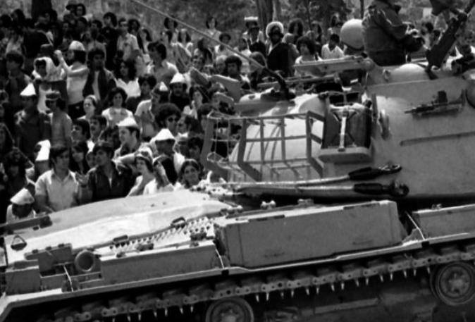

Looks good. If you are interested in historical accuracy there is a detail you need to change. Magach 3 tanks that were upgrades of Magach 2 (M48A2C) had different engine deck grilles next to the air cleaners than the ones M48A3 had. This something that very few people have done because there is little info and pictures on the exact details and dimensions of the actual thing.
Notice the 3 hinges next to the air cleaner
The grillers are raised to make room for the openings for the air inlet and outlet at the side of the air cleaner.

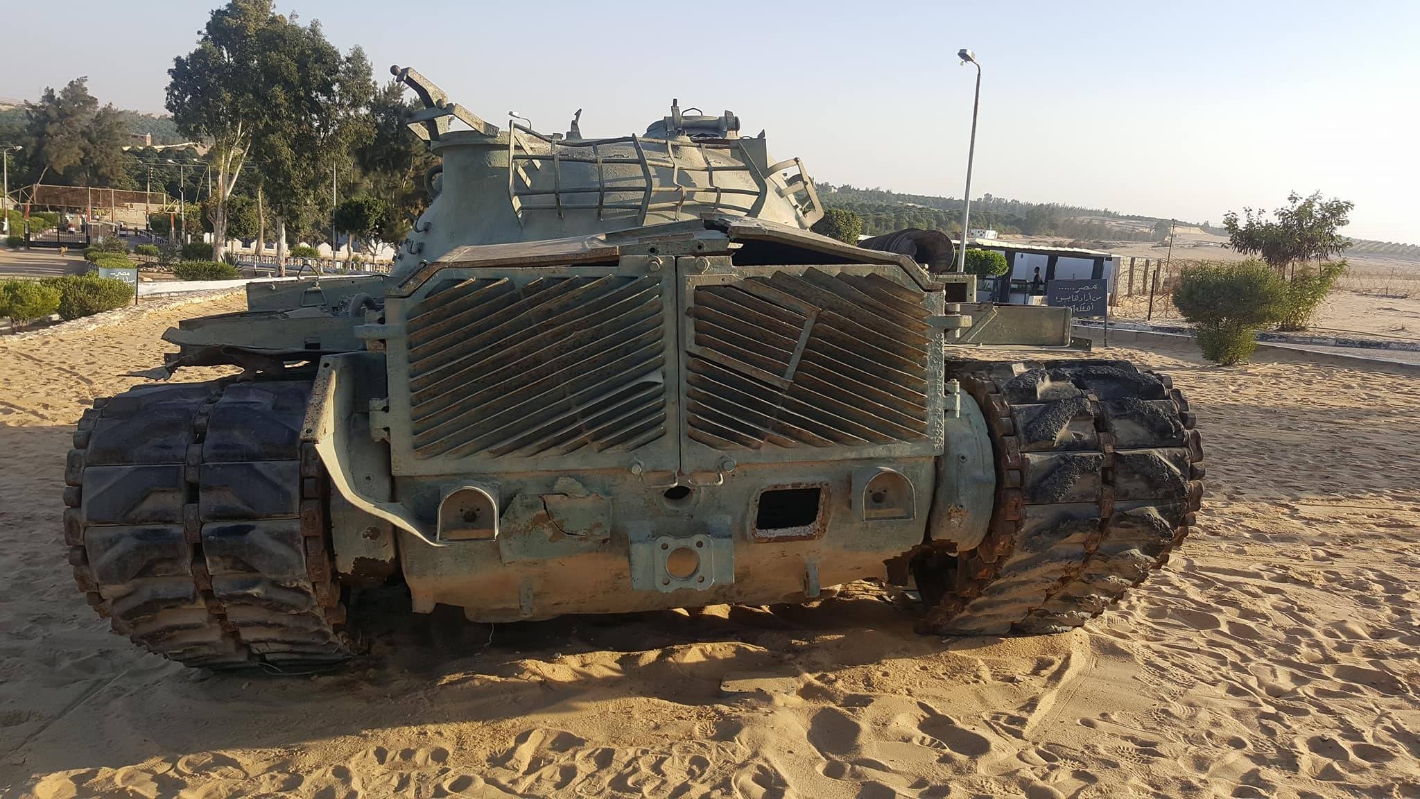

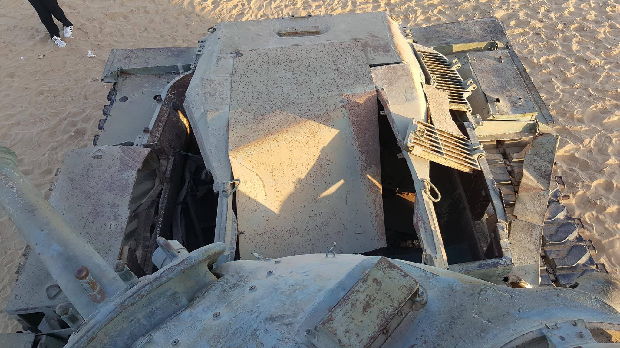

Like this
The distinctive square and bulge of the A3 engine deck grilles do not exist.
Also the A2 engine deck cover has different angles when compared to the A3 sideways.

Nikos, I think I see what you’re talking about, and I remember discussions on the difference in engine decks on converted Magach 2’s from old posts but I have zip for detail pics. I’m perfectly willing to attempt to make this as accurate as possible and I do have several extra engine covers/top hulls to work with, I just need to see a couple of detail shots to at least approximate it. I do notice the apparent very large size of the armored air filter housings. They look even taller than the ones in the DEF and Desert Eagle conversions. Is this possibly something unique to the converted tanks? Any chance the IDF bought any of the BMY conversion “kits” that the US used? That would make this a bit easier… maybe.

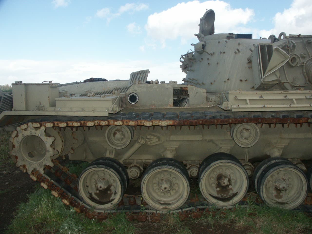

The height of the outer grill support is almost the same height as the armored air cleaner box, only the hinges protrude and a small part of sheet metal.
15079098_1350536091646320_7647414934613194362_n
You need the DEF model or Desert Eagle armored air cleaner housing. You can use whatever type of cupola you want.
