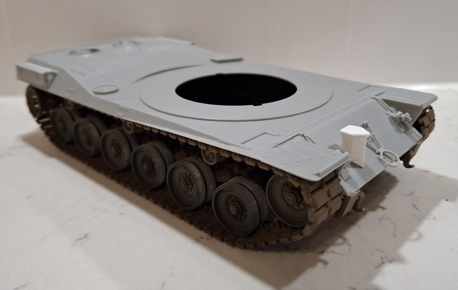

The instructions are not necessarily the most logical, but I understand this is often the case with Dragon kits, of which I’ve built precious few; however the modifications I made are as follows:
Added lashings of model railway scenic flock to the running gear as this will be a vehicle on exercise, and the flock represents mud.
I replaced the infantry telephone box on the hull rear as I believe the Dragon one is too large; as it happens I have a spare from the Revell Leo kit and merely applied that.
On the glacis plate I added my interpretation of the armoured TV camera housing, which was there to aid the Driver. Sadly, it doesn’t look much like the prototype version, but is at least the same as the rather ham-fisted version I’d devised for my earlier model of the MBT-70 using Commander’s kit.
Other modifications/additions included a mantlet cover, tow ropes, hull stowage boxes (purloined from the Revell Leo 1), ditto the radio antennae though further modified using Accurate Armour antennae bases), a Gunner’s hatch scratched, after drilling out the moulded closed hatch (why Dragon, why oh why did you do that?) – don’t look too close(!), and a stowage box on the turret top. Oh, and a pair of cylindrical containers for the bore brushes. I also added a pair of rear mudflaps.
The distinctive Dutch pattern smoke dischargers came from another Revell kit, their Leo 2 A6; decent scratch builders could have fashioned same I’m sure, but not this Callsign folks
Whilst I laboriously covered the construction process within the campaign, I don’t intend to repeat all that here; there were no great snags, but below are a series of build pictures so you can monitor the progress as it were:

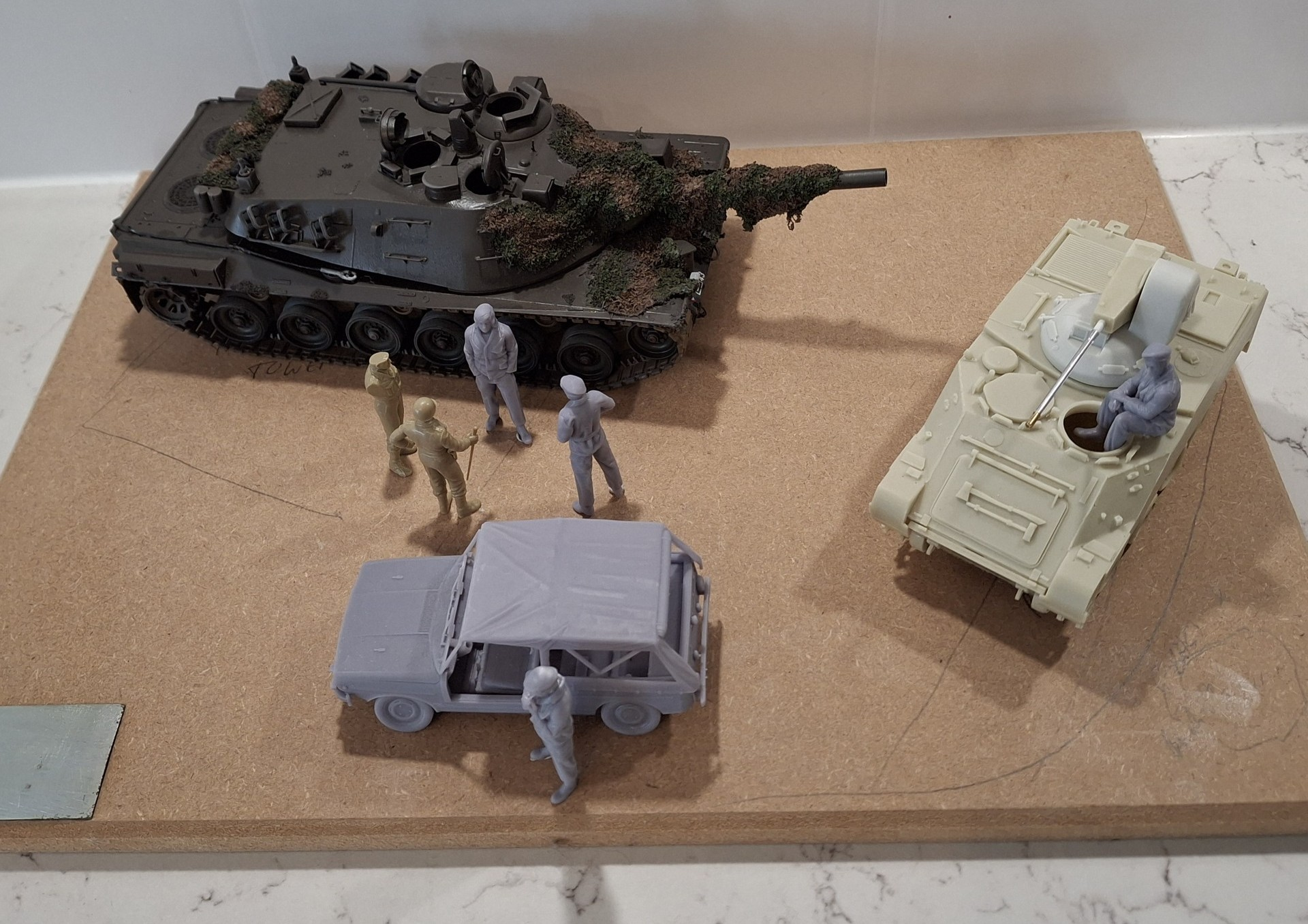

Now, how am I going to display this? Well, the scenario is, following the acquisition of a first tranche, the Dutch deployed it on a NATO work-up exercise in West Germany, in, say, 1974, which I would feel, falls about right. I have further assumed, that after purchase from the Germans, they modified their radio/stowage fit accordingly (as they did with their Leo 1 fleet) and in the early days, kept the 152mm gun/launcher; I had to emphasise the latter as I wanted to model to retain the original chunky main armament – even though it’s swathed in camouflage. It is mentioned in several references that the Germans were going to opt for a 120mm gun as opposed to the 152mm, so in due course, I imagine that the Dutch too would have adopted the same. However, in this scenario, as it’s relatively early days, they have the tanks fitted with the 152mm.
Now, any new kit undergoing participation on an exercise, is going to attract a fair bit of attention, so I devised a setting whereby the Inspector-General of the Dutch Armed Forces, His Royal Highness Prins Bernhard, has turned up to have a look and a talk to the soldiers manning one. To this end, the tank is parked along a tree-line (which I may or may not depict), and HRH has just rocked up in an equally new vehicle, albeit a softskin, the DAF YA-66.
I have just acquired some figures and the vehicle from Sylly’s Models, and this is my concept of ops utilising one of my larger bases, to A3 paper size:
That folks is the plan; I still need to acquire a round 4 more figures from Sylly’s Models. The build of the GVT-70 is complete and painted; it’s awaiting an oil wash, and some dry brushing.

First amendment; I’ve changed the planned orientation of the GVT-70; it was pointing the wrong way; I was keen to have – to me – the most interesting side available to the viewer: the cannon, searchlight, driver’s hatch, but then realised it was facing the same way as the visiting entourage, and whilst there’s not much technically wrong with that, I thought it needed to change. After all, the scenario is that the tank is on exercise, it’s the visitors who are making the difference, so parked up in say, a glade, it will be as the VIPs drive down a forest track to RV. I think it looks better. Figures as ever, will be both laborious but essential; I really must order some more from Sylly’s Mini Models – his efforts and the poses he produced have turned such dios as this around I feel and even enabled them in the first place.
I’ve also been brooding on the possibility of including the Koninklijke Marechaussee, (MPs if you like) not least after Bert’s reminder. We’ll see, I might be able to fit another DAF in as it’s a relatively small vehicle and will reinforce the story, without cluttering it all up too much.
