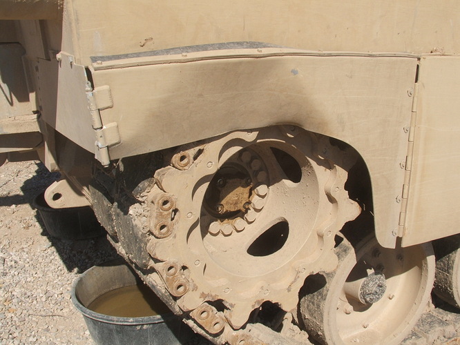

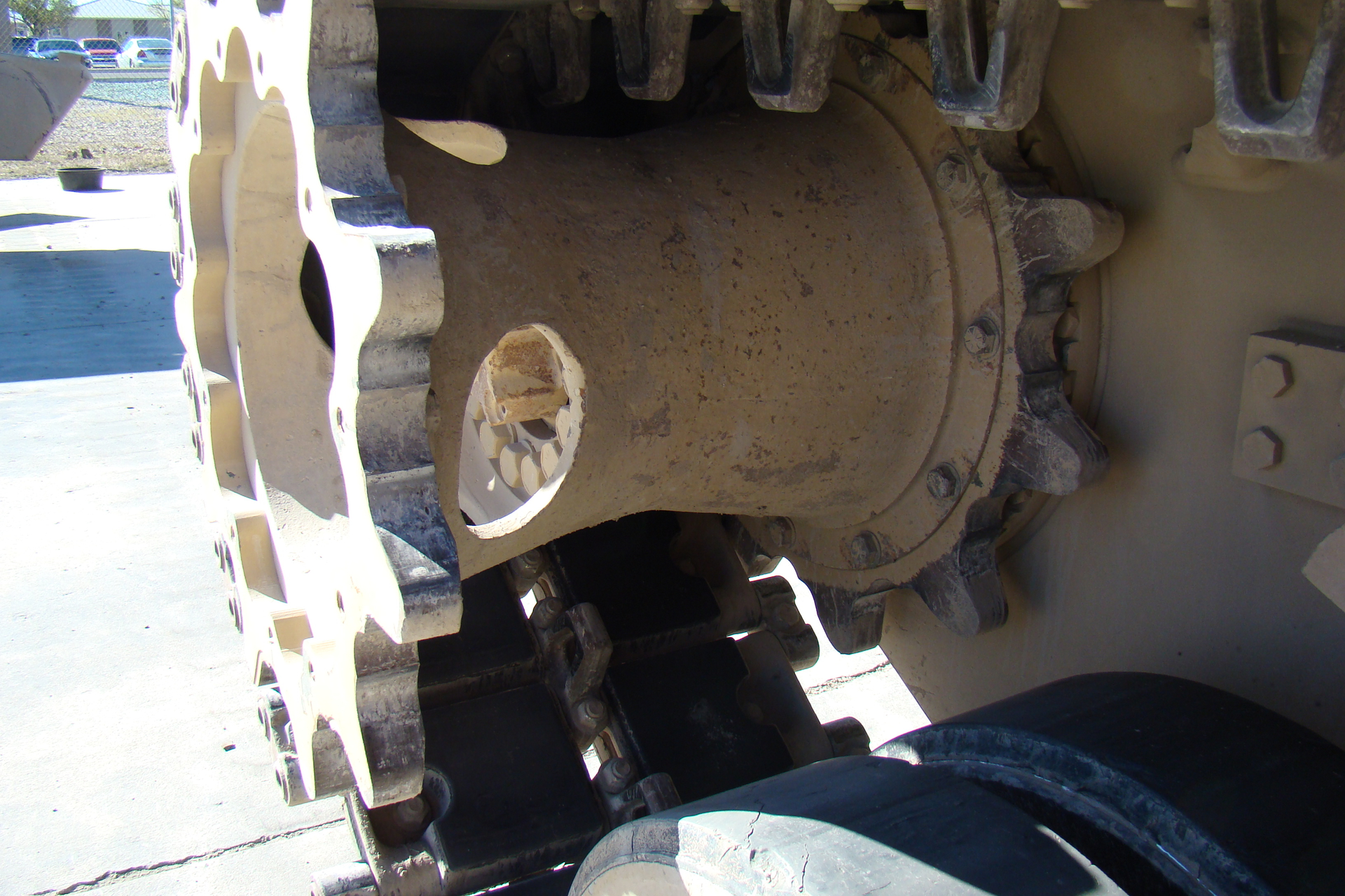

It might not be you or the paint. Sometimes we don’t get the effect we want because we’re trying for something that’s not really there. I’m not saying you are guilty of this. But I will say I used to be guilty of it quite a bit. I’ll use the Abrams sprocket as an example.
This one is in Iraq:
And this one was at Fort Hood. It had just been driven a fair distance. I photographed its interior for Meng:
That is certainly not how I would have painted it back in the day.
Now look at build photos online - especially those on Youtube where folks are trying to convince you to subscribe to their channel so you can watch how unrealistically they weather things, You’ll see some shocking differences between art and reality,
Whichever paint you use for drybrushing, it almost always boils down to just that - art vs. reality.
