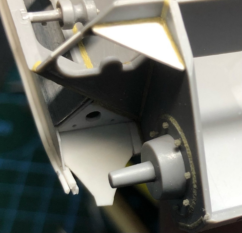

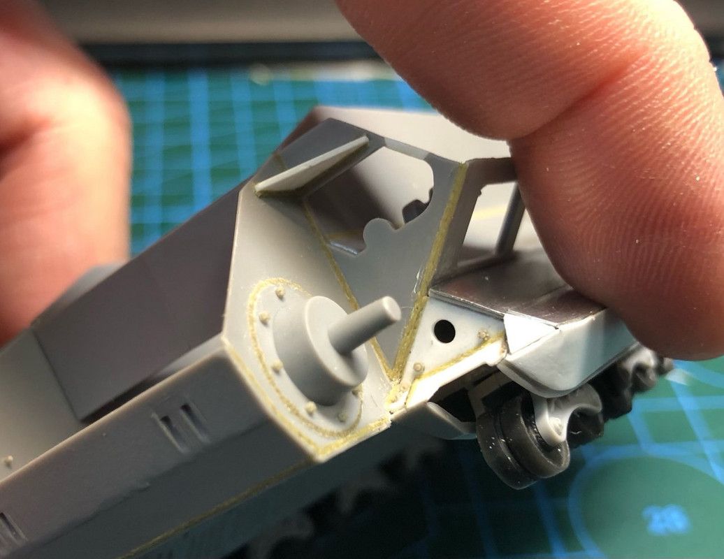

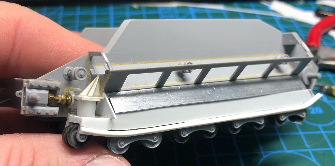

WIP with rear huthes. 3D holders. A bit oversized but this is maximum on available to me 3d printers. Workable.
I’ve decided to go further with chassis on right side. Wish me good luck. It will be hard path.

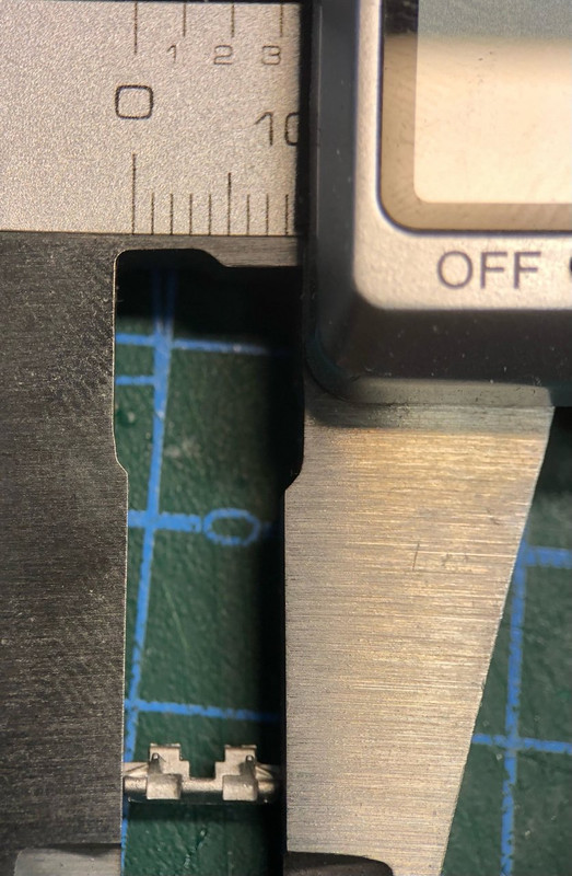

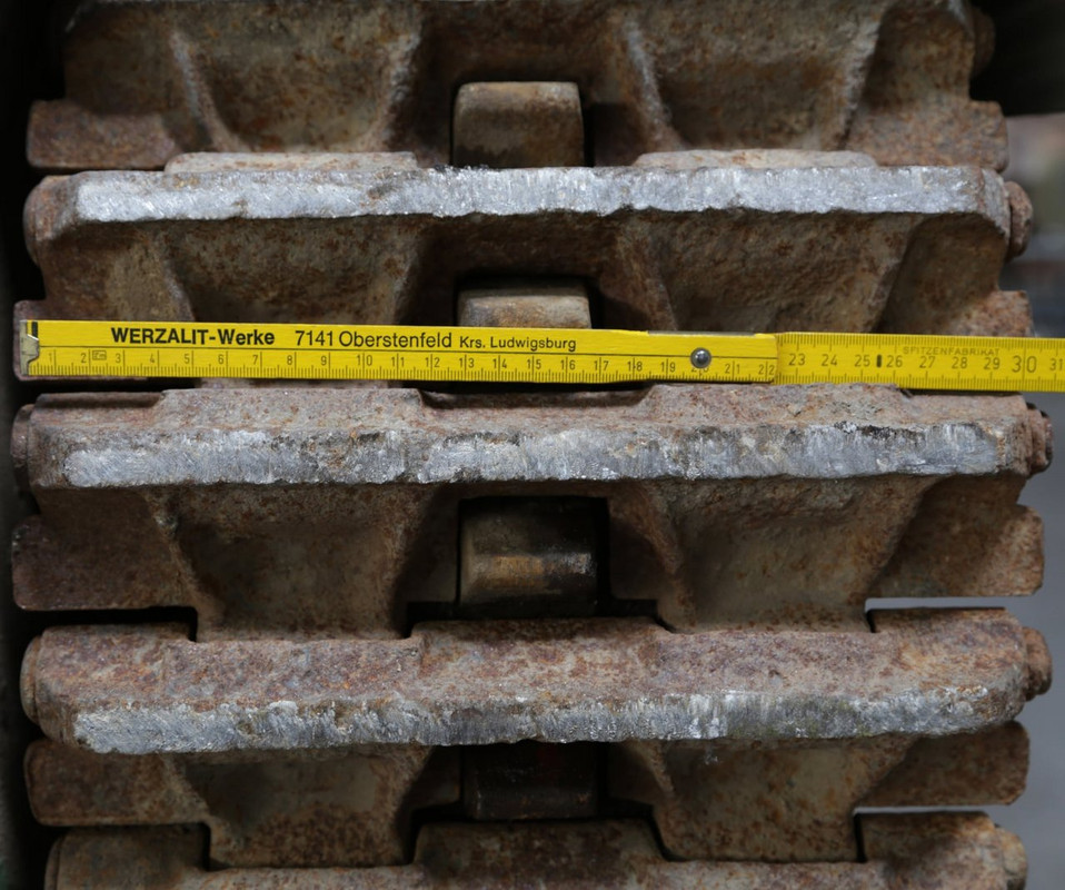

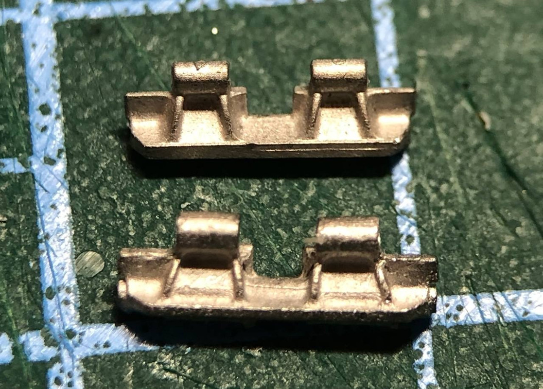

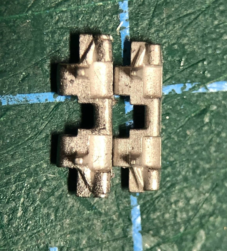

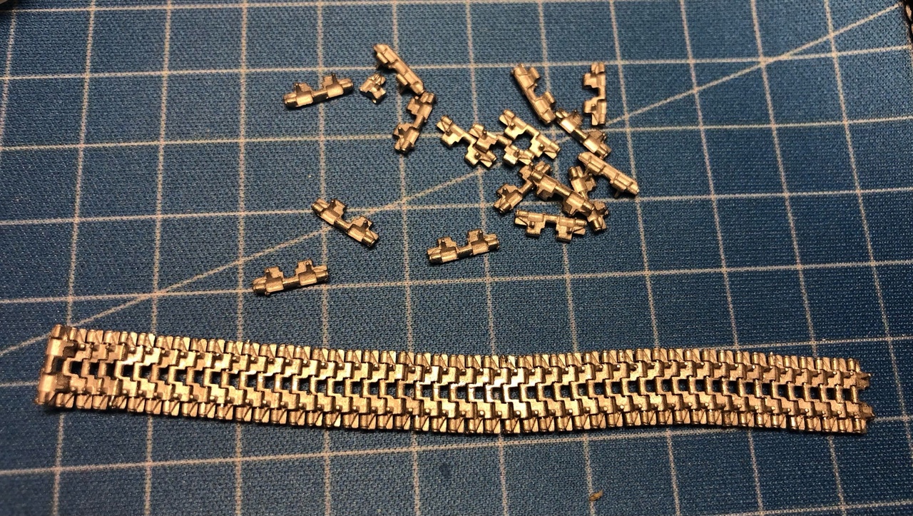

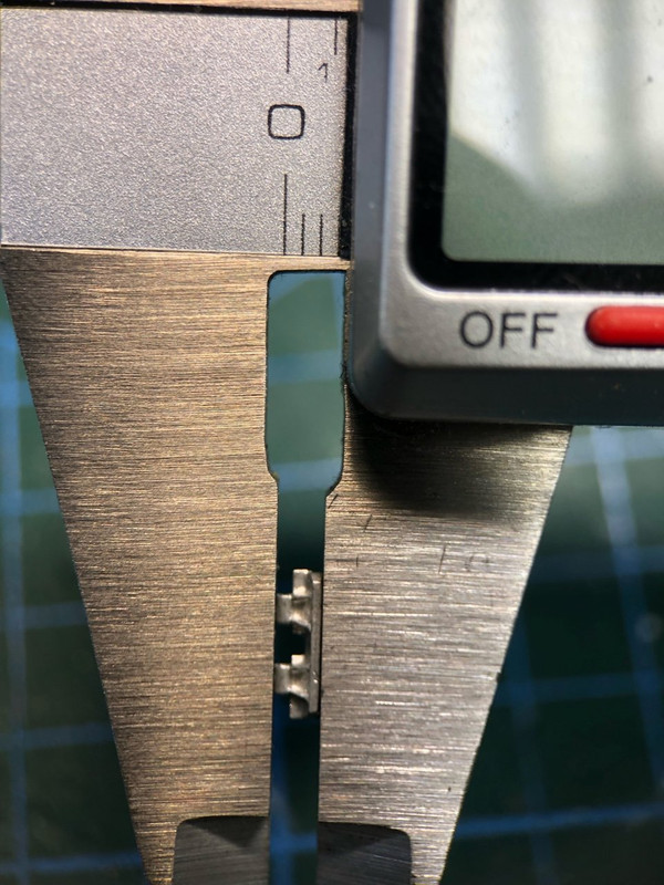

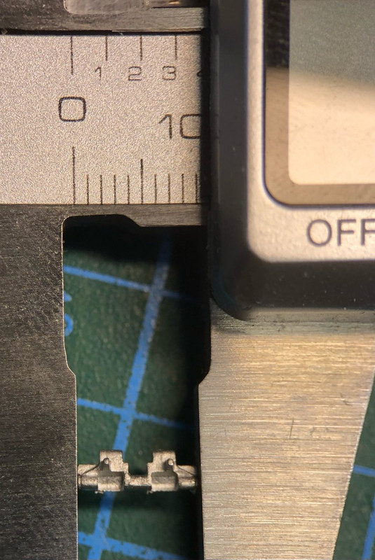

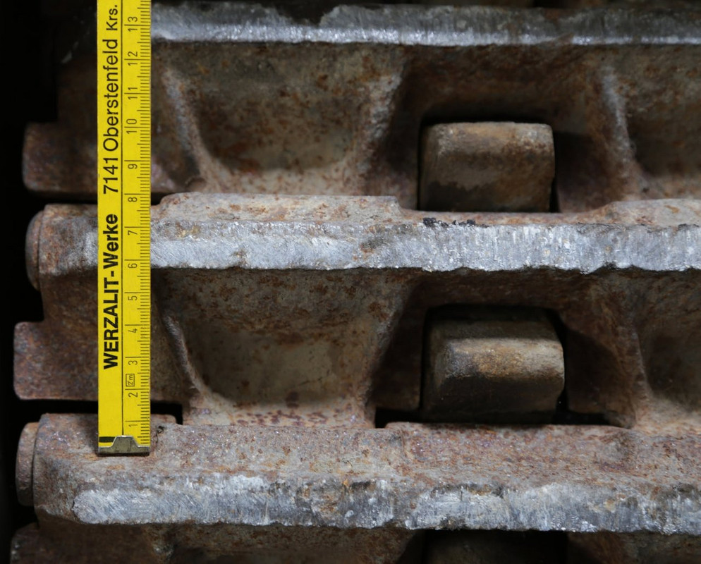

Perhaps I am only person who have Masterclub and Friulmodel FCM36 tracks. We have some very good measurements so I’ve decided to take mine.
Well we have 300mm wide and app. 90 mm height of the track according measurements. It will be app. 8,6 and 2.6mm in 35th scale.

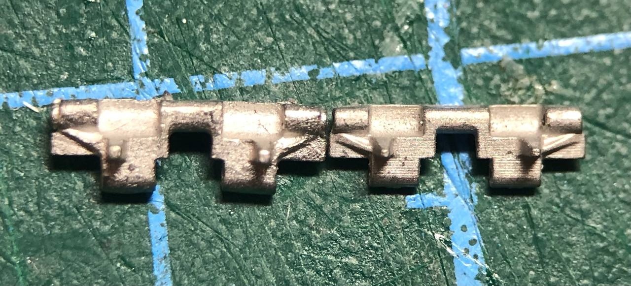

Friulmodel 8,2mm / 3,2mm
Masterclub 7,5 mm / 3,0mm
MC has sharper casting. To my mind Friulmodel is closer to the truth, but both are wrong
Often the manufacturers just make their links to fit a kit, not make them accurate. Those are very noticeable differences though.
That’s true.But I am not disappointed. It’s quite standard situation for AFV.

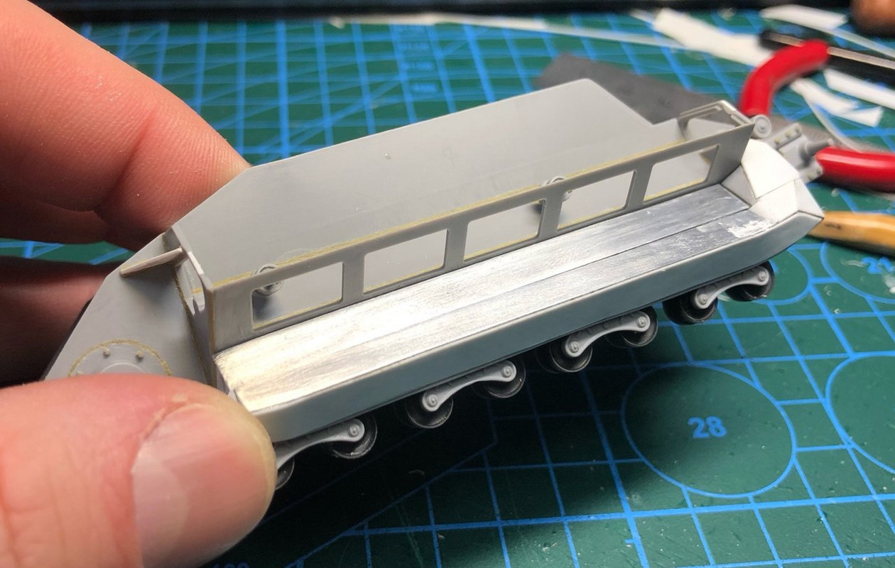

Very slow progress with left side. Much work ahead. Unfortunately first single boggie is totally incorrect. Wrong height,size and angle. I can only put some details there.

As for me. I’ve found mistake with first boggie and fixed it.

Final update of this year. Some WIP. Looks quite good

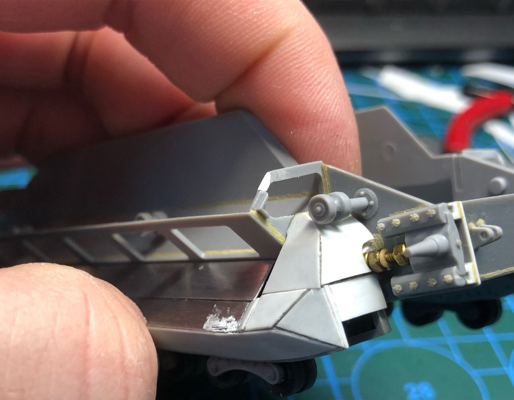

Greetings! This side of chassis is ready. It wasn’t easy but I did it. There are several mistakes because of some problems with ICM model hull measurements.
