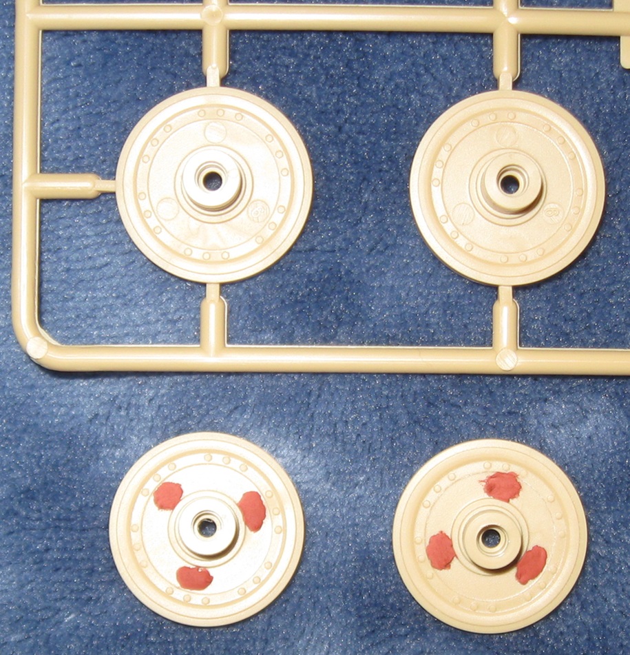

What technique or tool would you recommend for dealing with this filling and sanding problem?
Every single wheel has three ejector pin holes, filled with Bondo red putty. Now I need to sand them out. For this sort of thing, I normally use rolled up sanding paper or sanding paper wrapped around a stick. I am looking for a faster method that produces better results.
One idea is to cut a popsicle stick to the exact width, sand one end into a radius, and glue sandpaper over the radius. The problem is, a very small patch of sandpaper must perform a huge amount of sanding.
