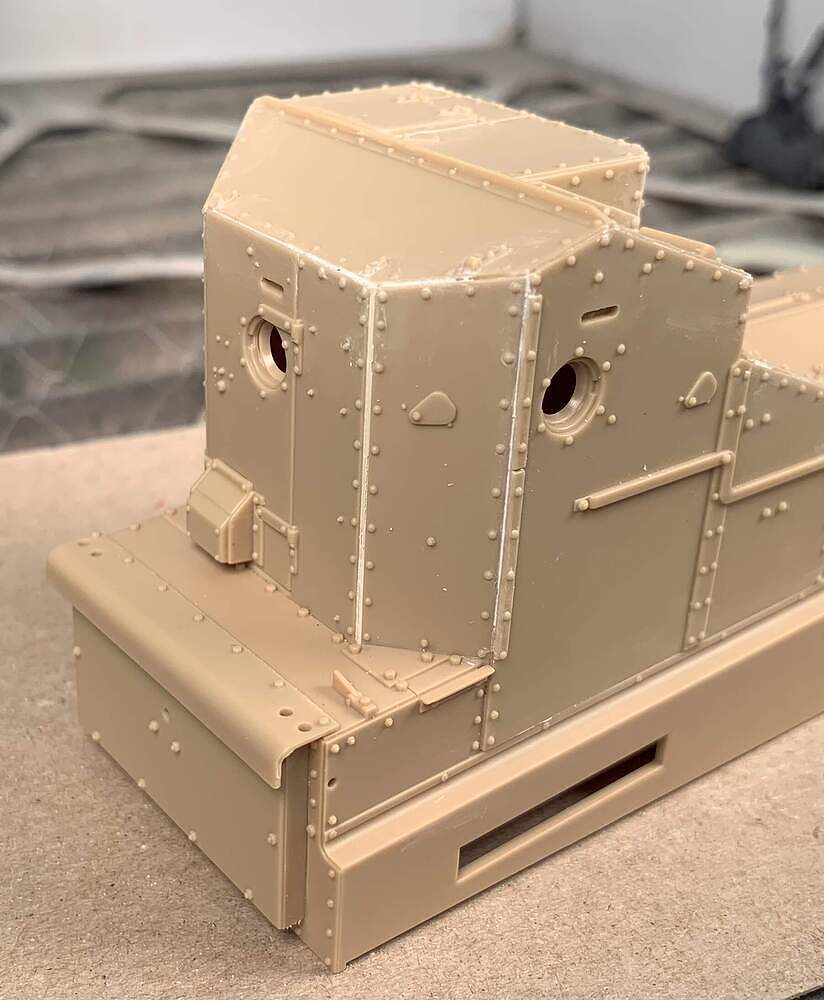

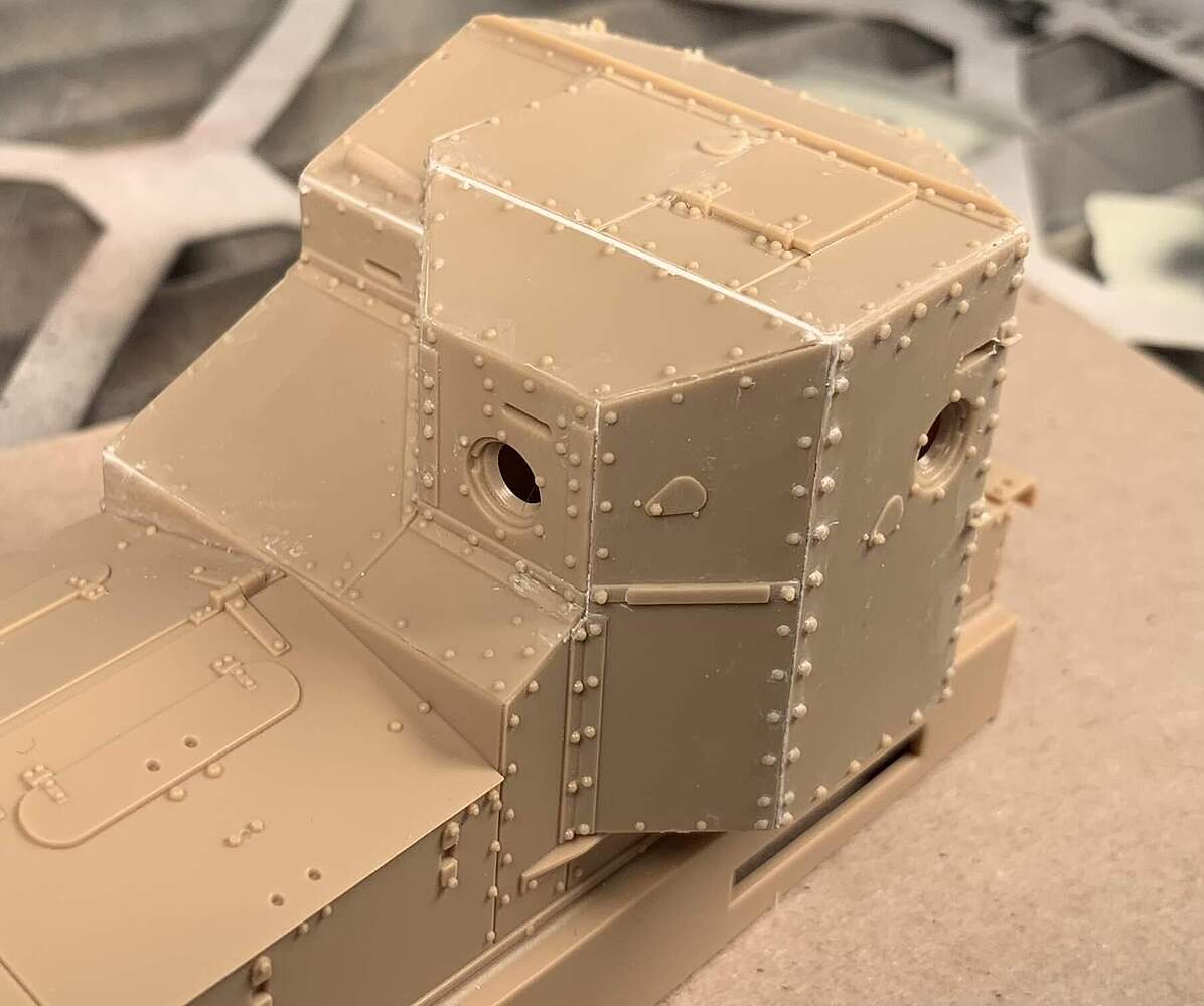

Before gluing I would try sanding for a better fit. Depends on the size add styrene and Vallejo putty to the seam. As it’s acrylic based, use a wet qtip to remove extra. What I used on my Meng whippet.
For seams surrounded by detail, use Mr. Surfacer 500, let dry, and clean up the excess with Mr. Color Leveling Thinner on a Q - Tip. This will give you a glass smooth seam without removing any detail.
