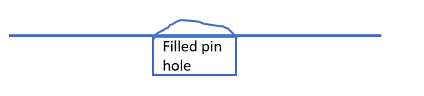

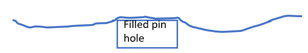

Sanding is a pain in the behind as it often results in sanding
down the adjacent area. Files are a little better.
Sandpaper usually turns this:
into this
Filling with CA can result in a filling which is harder than the surrounding styrene.
Styrene discs are usually more similar in hardness to the kit plastic.
A harder filling increase the risk of sanding away too much of the area around
the filling. Steel files (not flexible) increase the chances of filing the filling down
to a flat surface.
