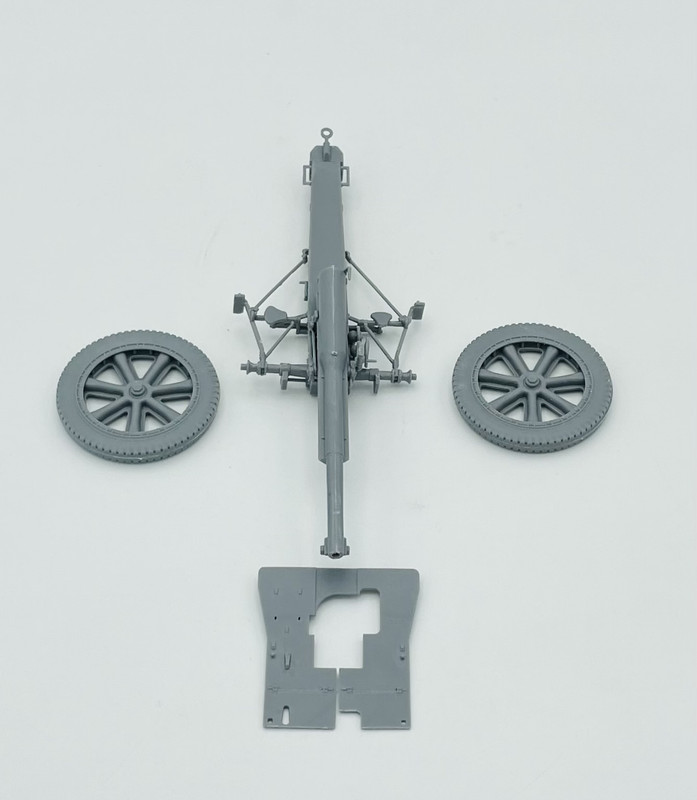

After about 3 or so hours, I had gotten this much done…
I didn’t realize that the kit has photo etch parts, so I did not bring what I wold have needed for cutting and gluing PE, so this is where I stopped. I did this test fit of the wheels and gun shield, just to see how it will look…

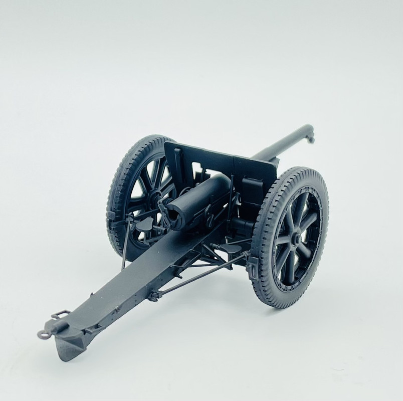

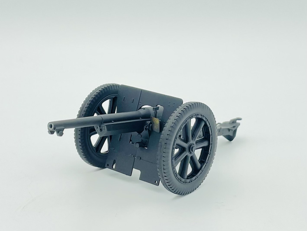

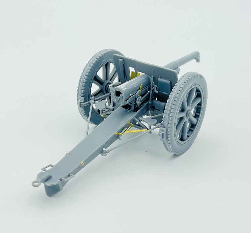

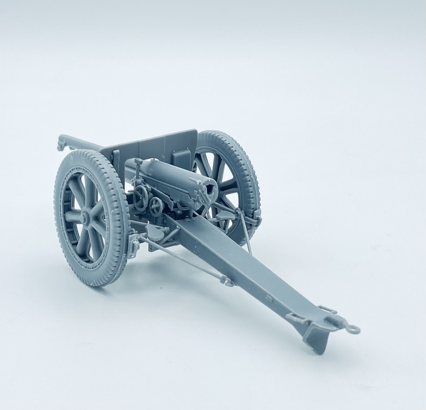

Yesterday I added the PE parts and the gun shield, then let that dry overnite before priming… I have not glued on the wheels yet to aid in painting.
Today I gave it a coat of Mig Ammo One Shot Primer
Tomorrow I’ll get the painting done… and gluing the wheels on…

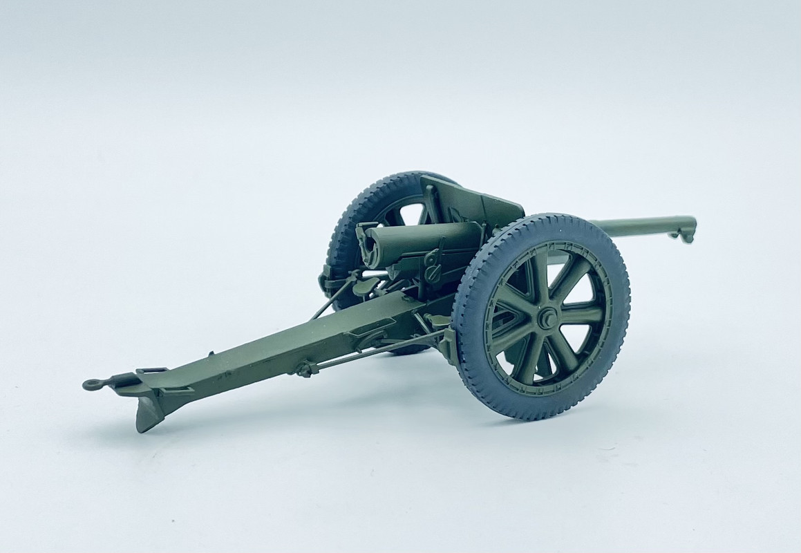

Yesterday in the midday I airbrushed on a coat of Gunze Aqueous Khaki Green for the base color

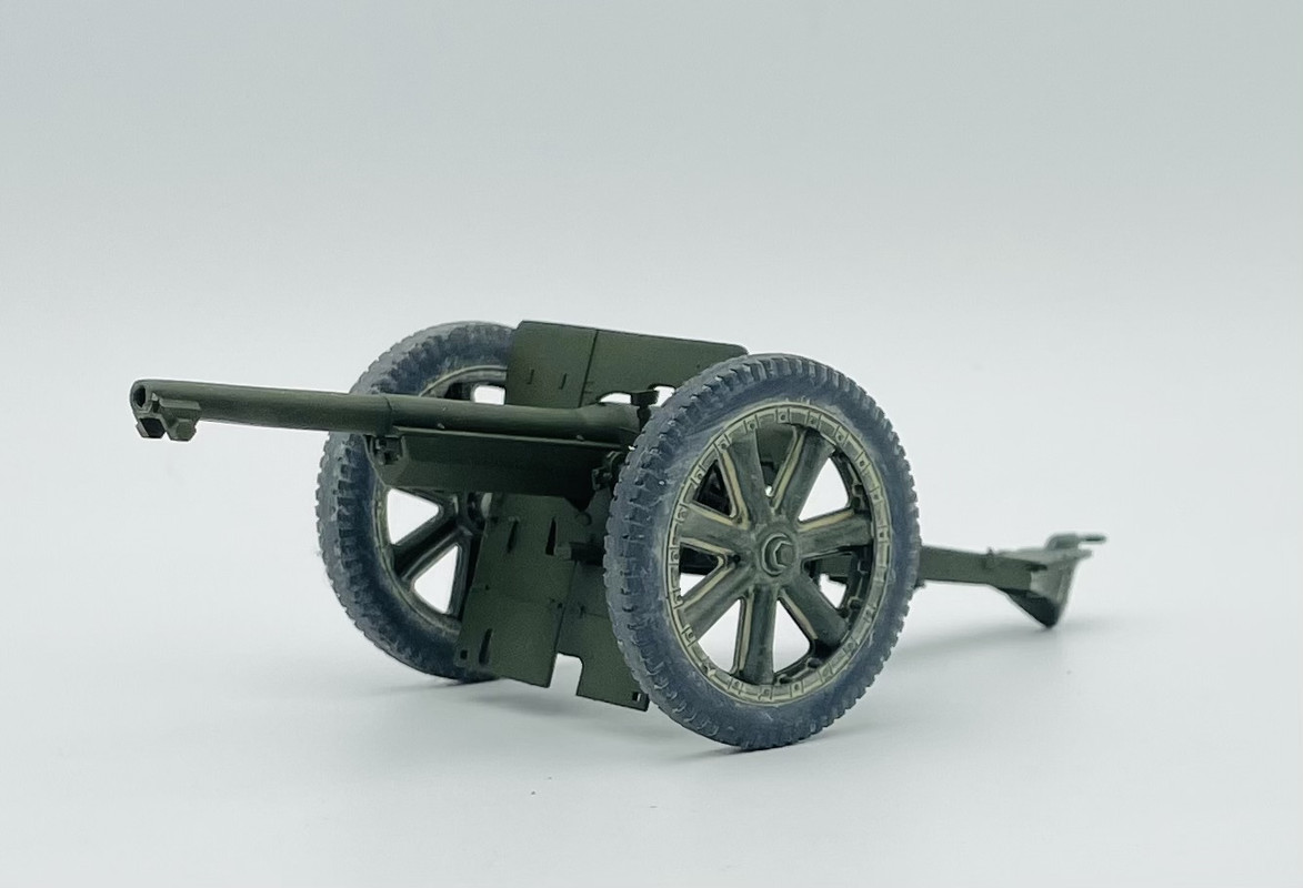

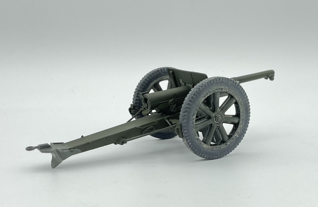

In the evening I painted the tires with Model Color Black Gray
then today I started weathering the tires, and on some of the trail and suspension… a glaze coat of Model Color Stone Gray
Tomorrow I should get the rest finished…

The breech block of your gun is open. Intentionally ?
Eric
@metalhead85, thanks Richard. Just pick the version of this gun you want and buy it. It’s a great weekend project.
@JFeder504, Eric, the breech has a concave section at the top. That probably gives the appearance of it being open. But out of the box, that is how it’s shown to be put together. There is no alternative part or positioning.
Hi ! I don’t know about the kit parts and their fit. With artillery guns and kit instructions there are ways for errors ! The modeler must study the real gun ( mostly between their firing and transport position ). Here with the 75mm modeèle 1897, the breech is a round rotating system on an elliptic body.
This is how it shows in closed position :
On the kit position, the quarter moon allows to slide the shell.
The most complicated thing with that gun is the locking system for blocking the wheels, the system is making pivot for the “seats” and would disable fire by the crew if the brakes are not “on”, with an internal tension rack actionned through the small crank showing thru the armour shield … :pleading_face:
Don’t expect to be 100% accurate !!!
