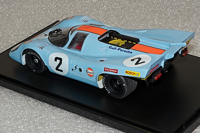

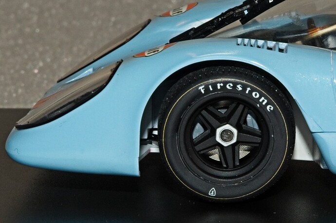

Well, the 917K finally rolled across the finish line, and I’m calling this build done even though there’s a few little pcs that still need to be glued to the top of the shell.
After installing the full interior cockpit and rear suspension, the top body shell once again had issues matting correctly. I sanded and filed the bulkhead and tops of the suspension points for a better fit, but it’s not perfect. Looking at some actual pictures you can see that the rear engine cover didn’t exactly fit flush either, so in a sense I lucked out.
The front lights and lenses were a perfect fit as well as the plexi glass covers. Unfortunately, the rest of the glass all had their issues. The side cockpit windows didn’t even fit! So it was sand and file time. Once again I got it close enough to call it good enough. The windshield in real life has the usual rubber gasket, but Fujimi didn’t even mold a line for it, so I free handed laying 1mm Tamiya tape the best I could, then 3mm tape, and fill the rest in with 10mm tape. the back was done with 18mm Tamiya tape. I air brushed the gasket with Tamiya rubber that looks just like Nato Black to me.
The top shell was glued to bottom chassis/shell and the cockpit side glass, and windshield were glued into place. Finally the tires were pressed onto their respective axles.
Here’s a few pictures of the Porsche 917K on it’s base. It’s not perfect by any means, but she done and in the books.
Thanks to all for following along, as it’s much appreciated.
joel

Thanks guys for those really most positive comments on how the 917K turned out. Plenty of mistakes, and screw ups, but fortunately most don’t show in the glamor shots.
As far as those pictures of my entire car collection, are you referring to individual pics or a group pic? As it stands right now I’ve got 20 in the display and a group shot wouldn’t show much. But posting 2 max of each of the 20 builds should be doable over a tew posts even for me.
