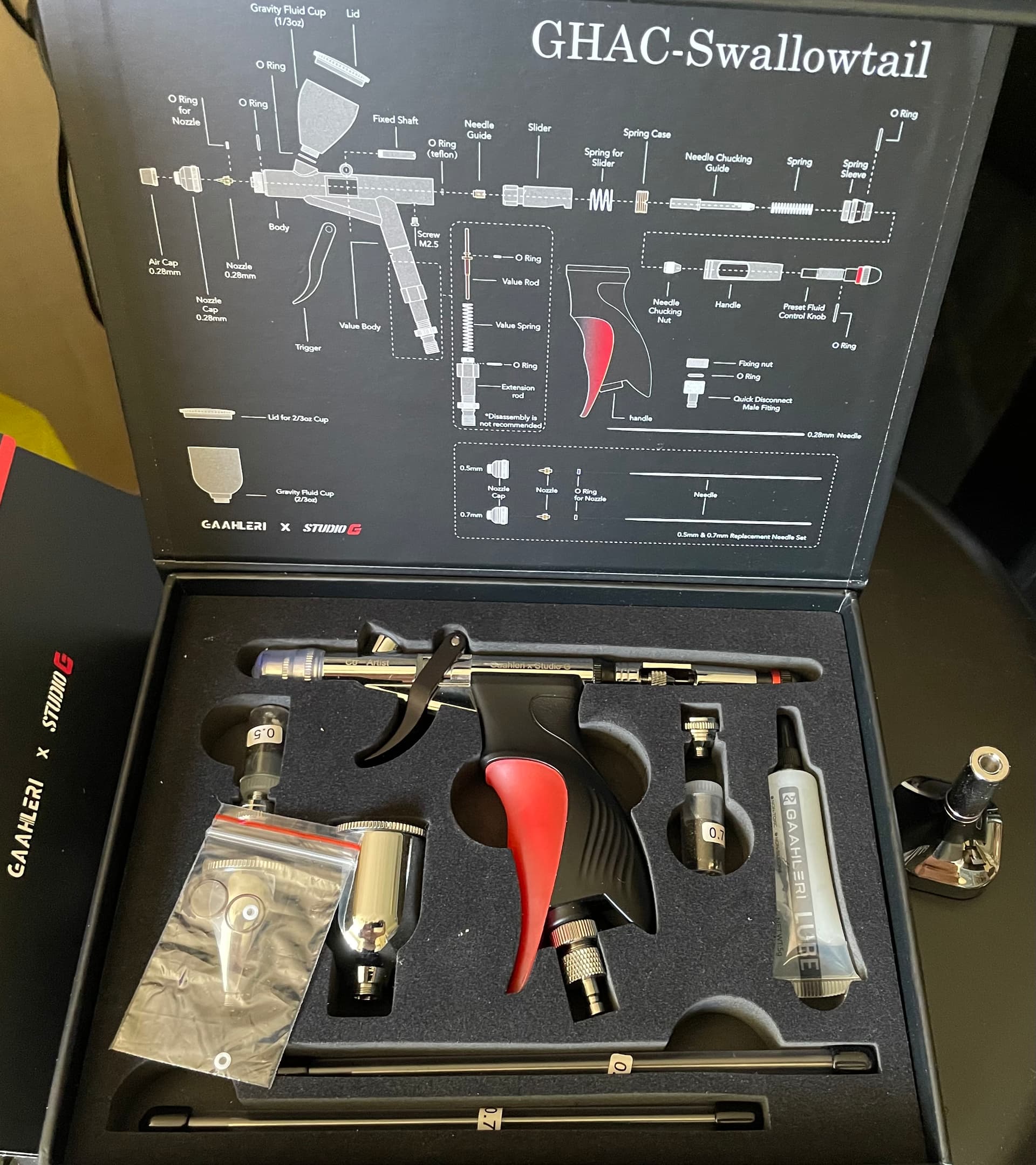

And on that, it arrived today!
Looks and feels like a quality piece of kit. Looking forward to giving it a test. I’ve got the holidays coming up soon, so I’ll give it a whirl then when I have time to get to grips with. Luckily, all my existing hoses fit it, so no bother there. Will starting putting a few pennies aside for a new compressor at a later date.

I tried to find a parts diagram on the 'net but failed.
Check if you got a parts diagram with the airbrush.
Thanks, there’s a diagram inside the box lid.
Just took the nozzle off and everything is there that should be there. It was all nice and tight. As I said, I’ve not touched or adjusted anything since I bought it.
The supplied instructions are next to useless as this little problem isn’t covered. Only too thick or too thin paint.
