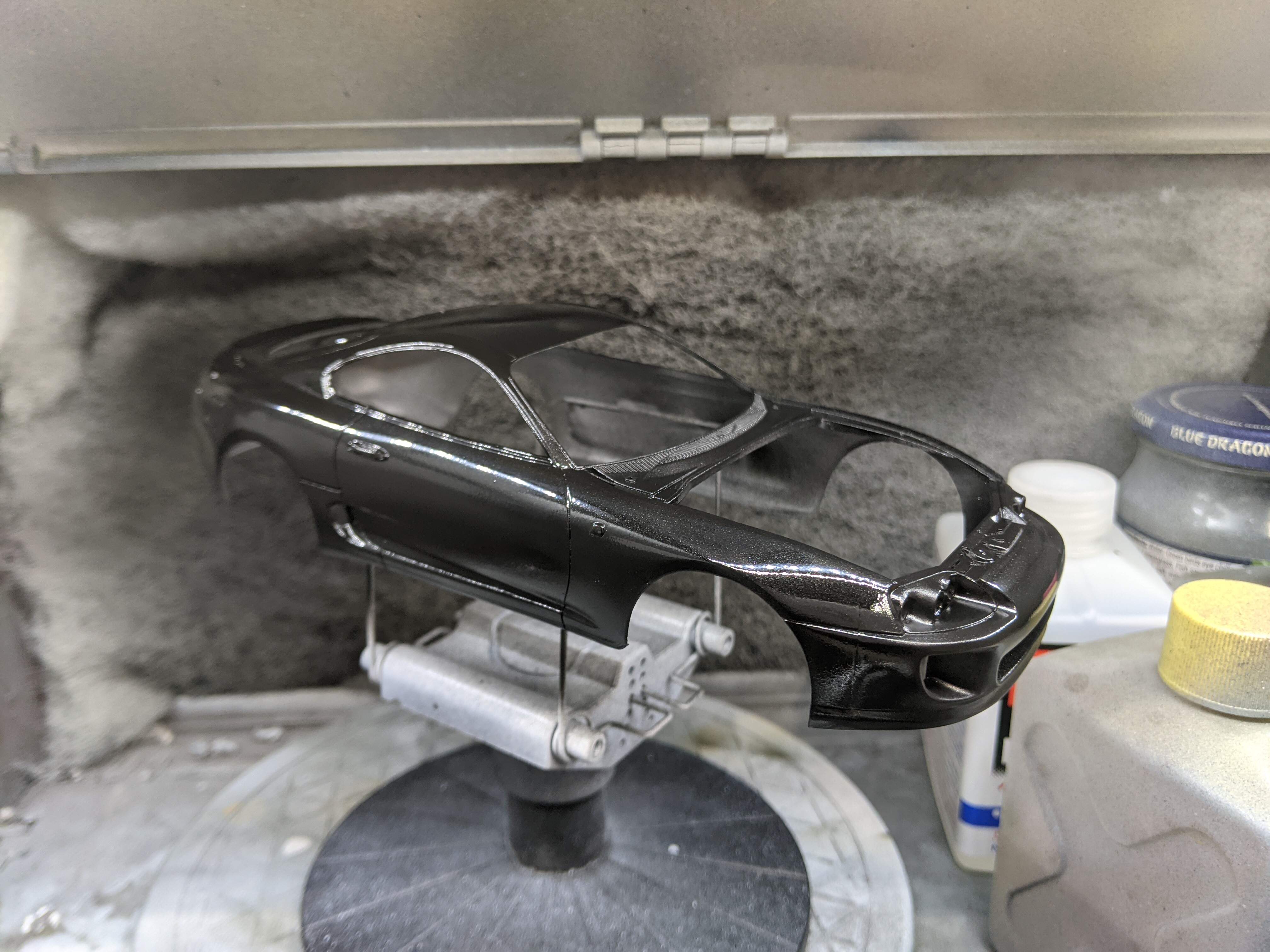

Time for the first update, and this update will focus on the body. To begin, I sanded out the mould lines with varying grits of sandpaper, then sanded the body generally to give the primer some bite. I also engraved the panel lines
I primed the body with Tamiya’s Grey Primer (the stuff that comes from the bottle) thinned with retarding thinner.
Looks nice! I then sanded the primer coat with 2000 grit sanding pads to smooth it out. Next, I applied a gloss black base coat for the metallic paint. I used LP Metallic Black, heavily thinned and retarded.
Then it was time to polish the black base. The metallic paint I’m using, LP Sparkling Silver, is very thin, so I had to make sure there were no imperfections in the paint job. This is the final result!
Lovely finish Martin, excellent work! Great choice on the silver paint as well, it looks to have a really nice scale shimmer.
Looking forward to the next update!

Excellent start to the Supra. I’m really impressed with the LP primer coat. I’m assuming that the LP paint is the Tamiya lacquer line that’s just not available here in the states. What a shame that is for sure. Polishing it out to a super smooth and shiny finish really paid off as the Metallic color coat looks great. Did you use a liquid polish or just very fine emery cloth like Micro Mesh?

To polish the base coat for the silver, I used grits up to 4000, and from there I used Tamiya coarse and finish polishing compounds. It’s a shame about the LP paint availability, they’re definitely my go-to, especially for metallics. Very thin, very strong, and I can add retarder to them to really level out the colour.
