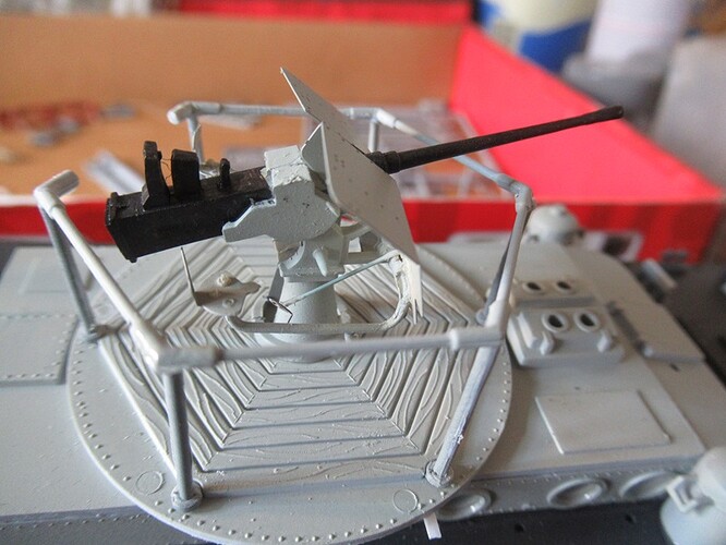

this gun has tractor like seats in PE.
the gun base prior to the scratch supports being made.
here they are simple gussets in place to support the base overhang.
the gun in black paint mounted on the bandstand
Thank you Uncle heavy, Ejector pins the bane of old kits, they could have placed them underneath where they would place them today, Kit History Ay, I’ll get some mr surfacer on them
“You tread heavily, but you speak the truth”
Not only on old kits … been there, done that …
I would suggest using the back edge of a nr 11 scalpel blade to scrpe off the edges of those ejector marks first and then take care of the resulting scratches with Mr Surface or similar product.

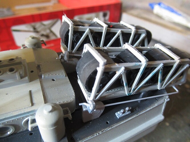

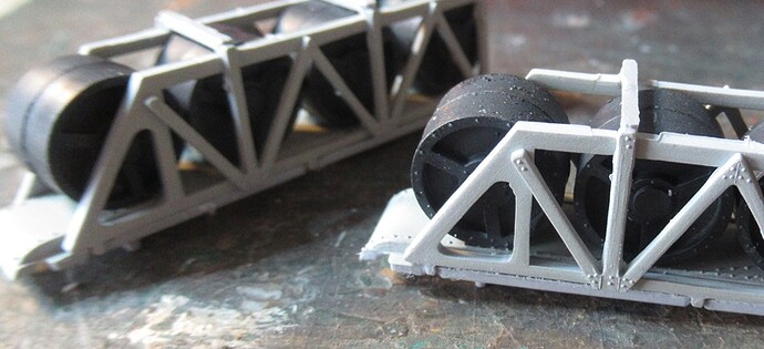

Depth charges next.
Of course I say Depth charges, they can’t be magnetic mines, wrong shape and no sinkers.
the oversized kit release mechanism bar replaced with stretched sprue. and scratch made crank release handles. Just needs the spare length snipped of.

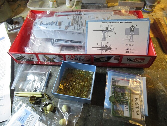

Great Little ships do Mines with sinkers, Torpedos, Depth charges and machine guns for the Vosper, but a lot of adjustments will need to be made.
the sinker units for the mines are made from PE and cast pieces, they are small models in their own right.
