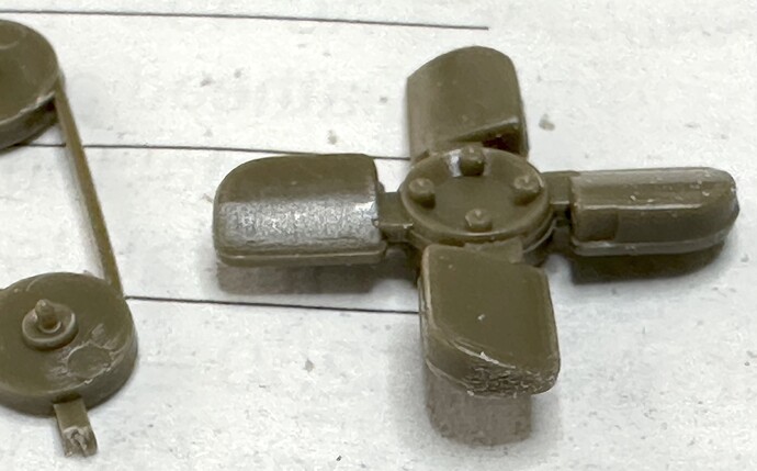

What has been an issue is the almost “limited run” feel of this kit. Some of the parts fit fine, other need fitting. There is flash on many parts and mold parting marks in many areas that need cleaning up.
In other places the maker has simplified detail to a shocking degree. The three control pedals are molded to the floor. I thought I would try painting a shadow to hide this and glued the body sides to the floor. Now I wish I had ground them out and built new pedals. The fit of parts is good in places and poor in others. Fitting and clamping have been required. It ain’t a Tamiya kit.

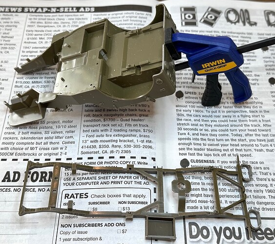

I have been working away on the Fine Molds 1/20 Jeep with mixed results. This kit was a mystery and some parts of it were very good. The frame for example snapped into place under the body. Perfection, Tamiya like.
On the other hand, other parts were not even close to fitting. The motor has gaps were the parts didn’t fit and all the parts require “modeling skills” to get anything done. Worse was to come!
The motor fit in the frame fine but the assembly would not fit under the body. A lot of plastic was removed from the body and when I feared I must be close to breaking through to the top side I started on the bellhousing and starter boss. On the good side, the plastic is great to work with. Finally it fits.
