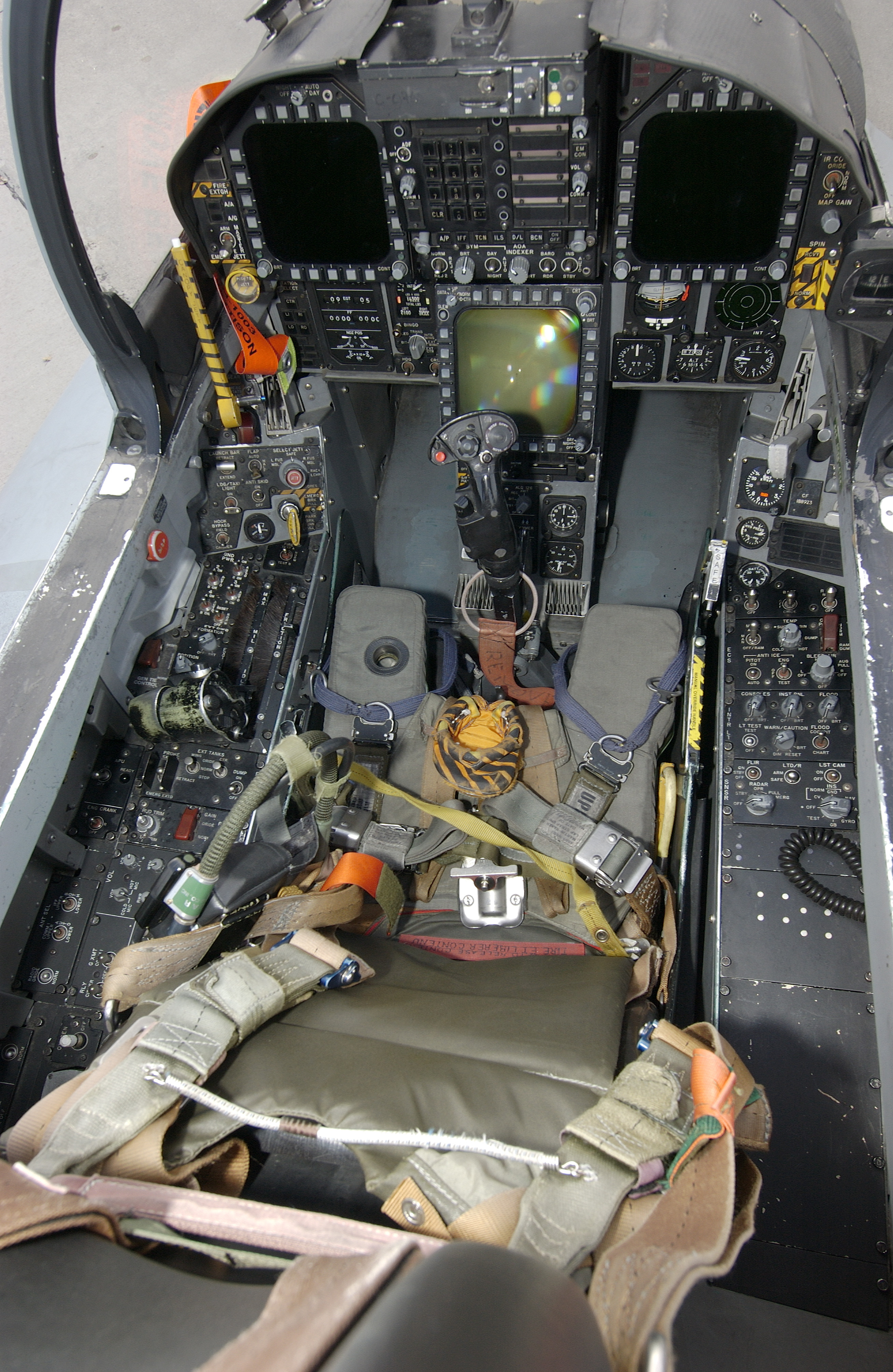

Anyone have a method or paint they like for small details? The details in question this time are switches in an F-18 cockpit like those shown here

Most of those buttons and switches are gray not metallic. I used a light gray on my recent Hornet build, possibly Light Ghost Gray or Neutral Gray, I don’t recall which. But for smaller metallic stuff, Humbrol 56 works great. It’s a bit darker and grayer.
Think I’ll go with gray then! I mixed up a neutral gray with Vallejo that is pretty close to the tamiya neutral gray!
Just be advised that Tamiya’s Neutral Gray is a much darker shade like WWII era Neutral Gray 42, than today’s Neutral Gray FS 36270.
