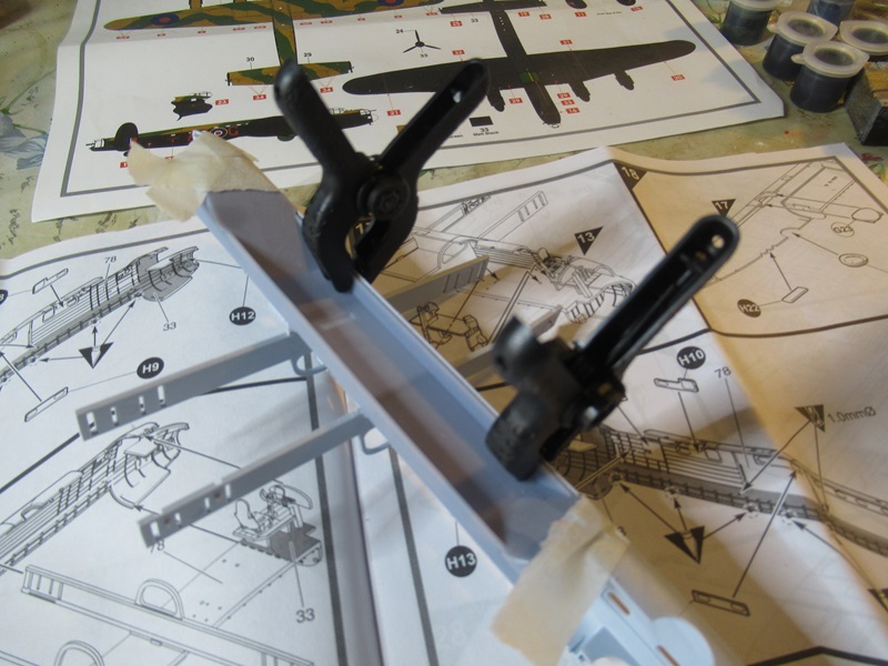

trial fit of the fuselage floor to port side half.
I didn’t think the 3d printed part would be as “click” a fit as the Airfix floor, but it looks workable.
up front it needs the nose nudging flush to the 3d fairing.
using clamps and stress applied masking tape to hold it all right as the glue dries.

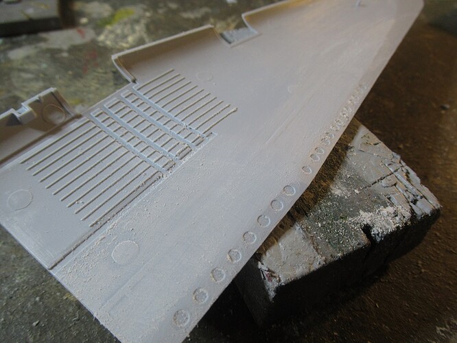

The kit moulded wing box needs to go.
going…
finally gone, this will allow the PE wing box to fit flush.
the top half of the wing needs this edge removing.
from above the edge to be removed shown by the red arrow.
with that cut away, a dry trial fit to see what needs trimming out next, there are no notes on this in the WEM instructions as they pre date this Airfix new tool.
