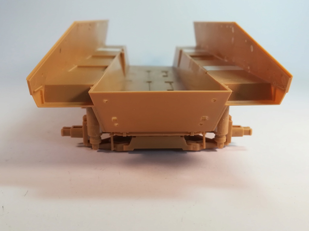

First the AM stuff.
Shock absorbers rear hole filled.

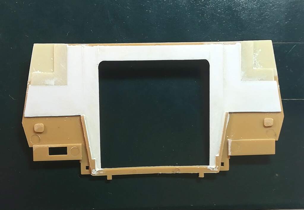

Front armor plates to modify.
Rear armor plate with Galix launchers replaced by resin ones.
Bin gaps to be filled.
Shock absorbers in place with the holes filled.
Front plate modified and in place.
