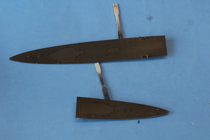

The keel has been laid.
The hull is primed with Halford’s Red Primer, (this is a multi purpose fine Auto primer, works well on plastic) dries to a nice smooth finish, and is a good match for RN anti fouling red,
This is the forecastle deck upside down, a couple of watertight doors from the spare etch box have been fitted to add a bit of extra detail.
The inside of the funnels sprayed black, along with the wood deck.
A bit of test fitting, the items that will need a coat AP507C light grey, I will be using Tamiya XF80.
Good fit across the board.
